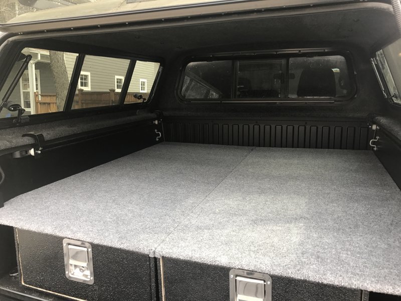

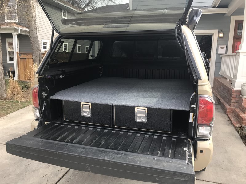

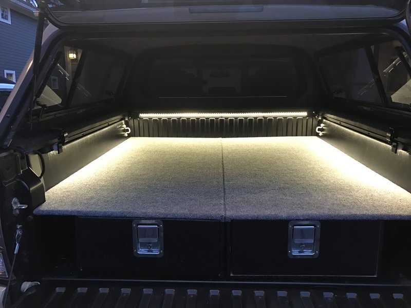

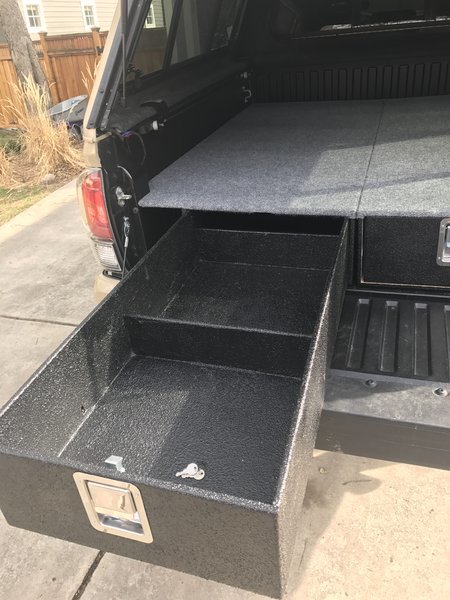

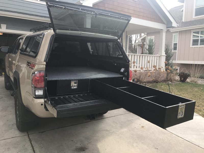

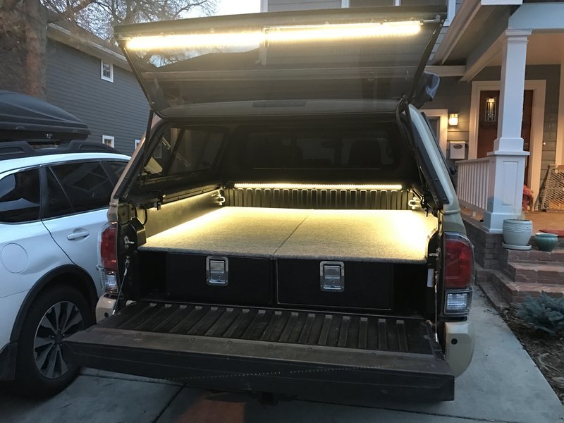

    Here's the details: I built two boxes with a wing on either side that sits on the wheel wells and the lip that runs the length of the bed. I chose a two box option because I might want to remove one side on occasion. I researched expensive, ball bearing sliders. However, those were going to add $300 to the cost. I ended up using polyethylene sliders that work great. I can pull the drawer completely out with one hand. Hint: sand the wood to a fine grit to reduce friction. I can still easily reach the lock boxes and outlet on the sides. My plan is to remove the drawers and take them inside when we need to pack for camping. I also plan on adding a cook grade insert for food preparation and or diaper changes (though hopefully not in close proximity). Thoughts? Critique? Suggestions? Questions?
    x4 5' x 5' 1/2" birch plywood sheets: $216
    Marine Carpet: $35
    Carpet glue: $5
    Flush mount locks from Amazon: $30
    Herculiner: $70
    Kreg pocket screws: $8
    Self stick high density polyethylene strips for sliders: $30
    Total Cost: $394

    What's keeping the halves from tipping while the drawers are extended? Say you put a hundred pounds of gear in a drawer and fully extend it. What's keeping it horizontal?

    How are these secured to the bed? If they're just laying there under their own weight, I can almost guarantee you they're going to shift around and cause problems. Add turn-buckles to secure them to the truck's D-rings.
    Nothing. It'll come crashing down without support. Large, heavy-duty drawer slides are expensive, but totally worth the price in the real world. Furthermore, the locking variants will eliminate the need for face-mounted latches (which are also pricy and will protrude into the interior), and give you the option to lock the drawers while they're extended, which is a huge help if you're parked on an incline.
