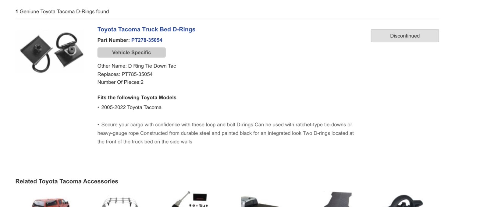

    OEM d rings from a Toyota dealer.

    Do you have a part number from Toyota that is still available?

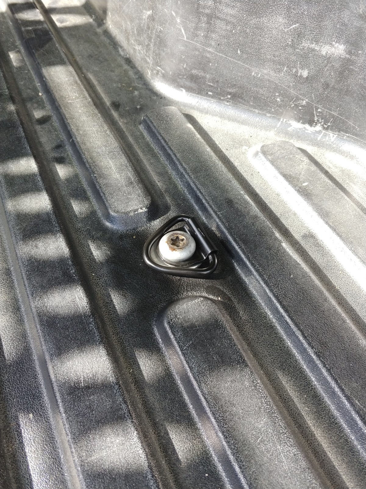

    D rings are best rings. I have found the OEM fender and floor rings to be sufficient for things that need a ratchet strap. However, many people get creative with their tie downs:

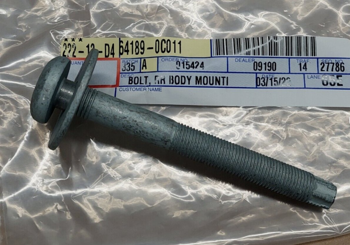

    Check rocklobsters first link. You have to dremel the bed bolts to add anything above the washer. The stock washer is captive

    I don't see what's holding the washer on. Is it one of those magic tricks? What do you have to drimel off?

    The ridges below the washer visible in that picture are slightly larger diameter than the opening. The dremel is pointing at them in the fourth pic on rocklobsters link

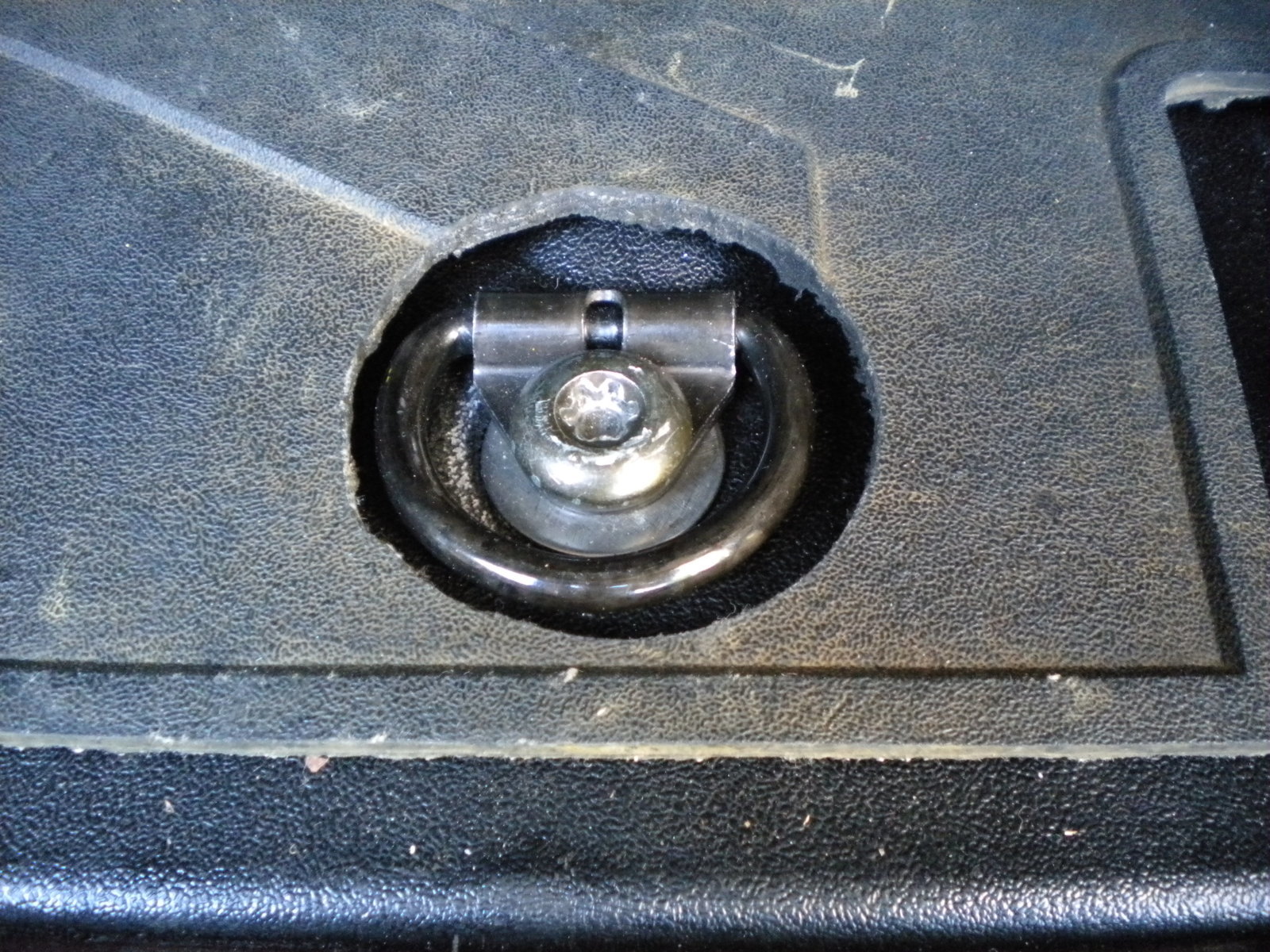

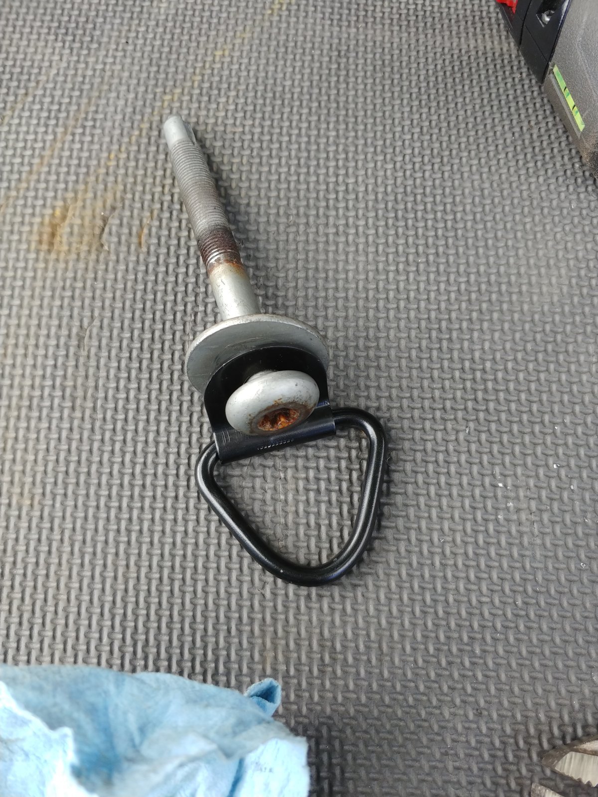

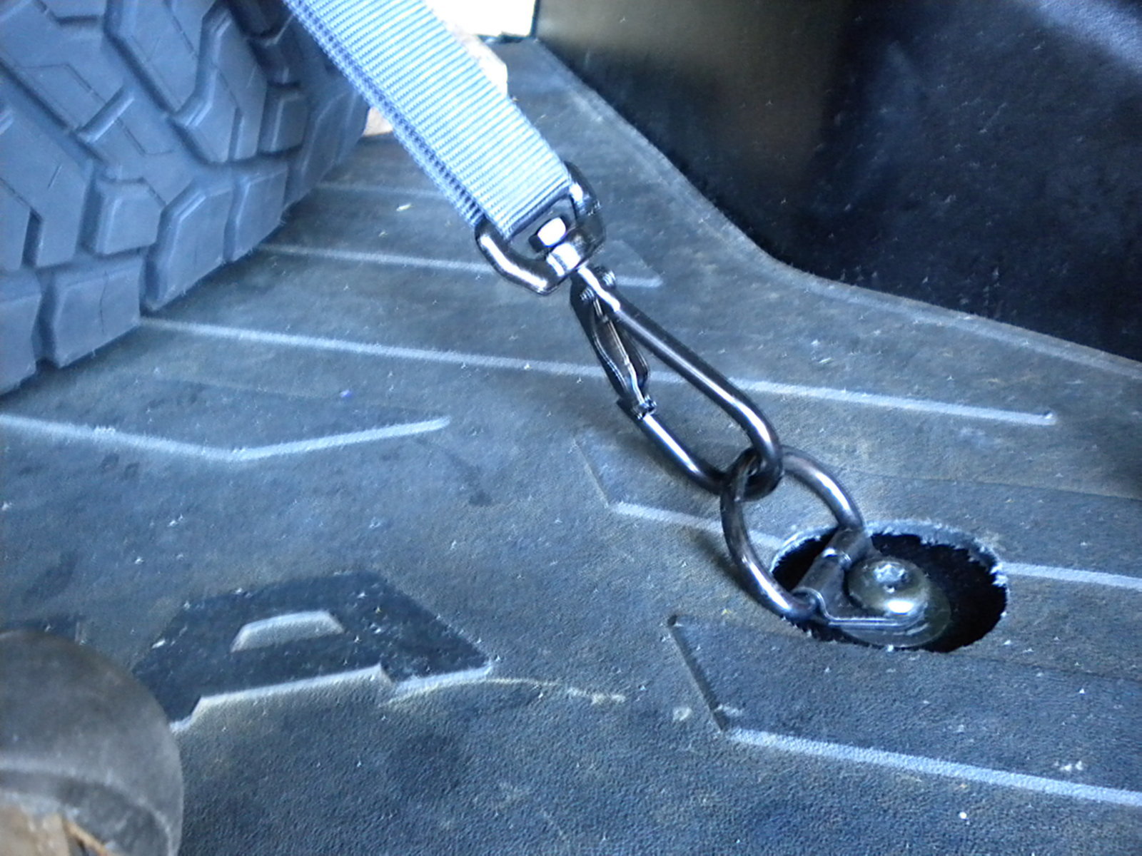

    Mercedes Sprinter D Rings. To slide the washer down the bolt remove bolt from truck, get a socket large enough to fit over the head of the bolt... sit it on top of the washer, and hit it with a bfh (i used a 2lb mallet)... comes right off. Holes in mat made with hole saw.

    When you force the washer down with the socket/hammer the ridges on bolt that hold the washer in place get flattened down... doesn't effect the bolt threads at all.

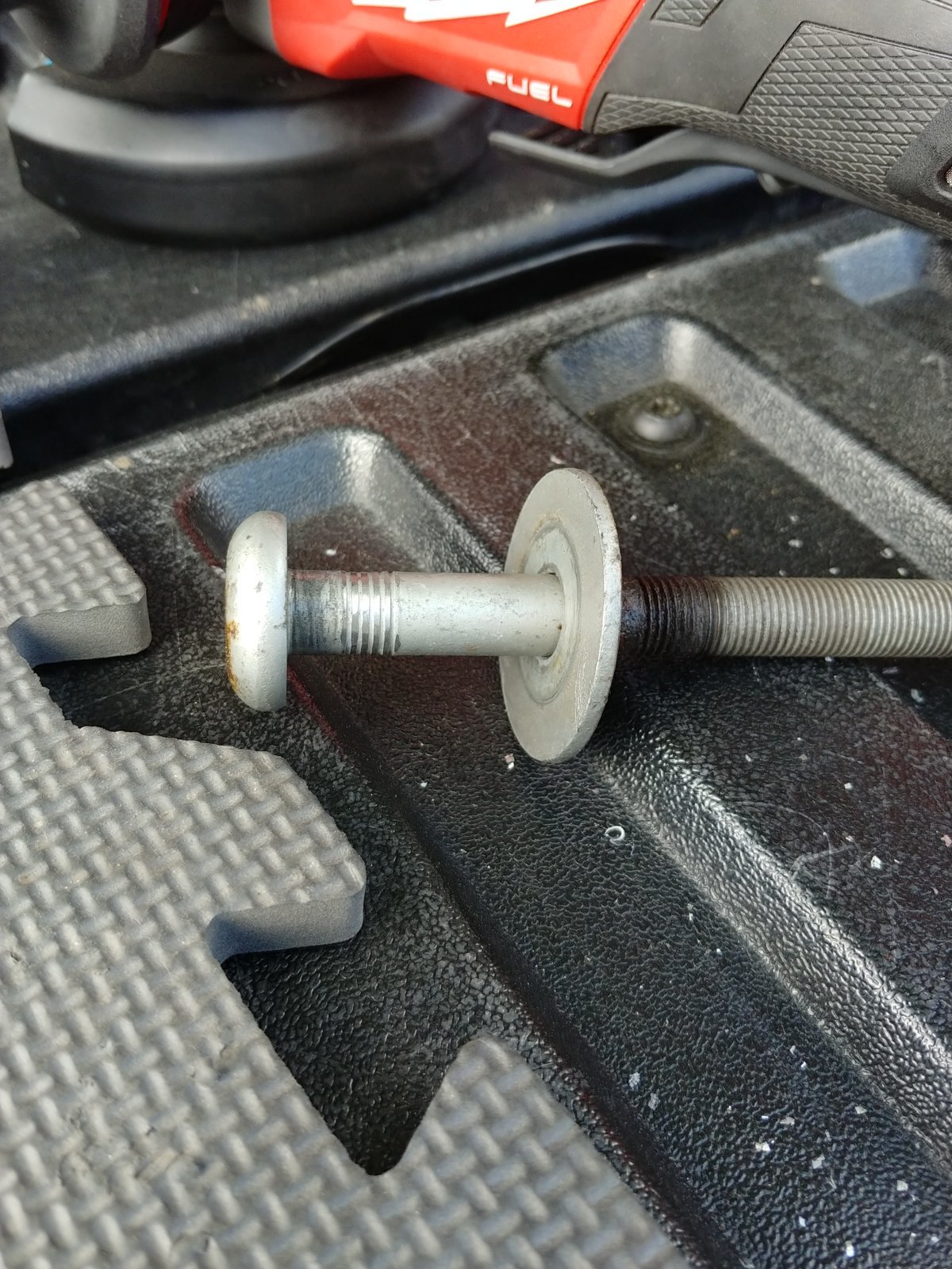

    2 seconds with a flap wheel removes the ribs on the bolt. Then you can add any sort of hinged d-ring you'd like. Liberally apply Anti-Seize while the bolt is out too

    How are you guys keeping these D-rings oriented properly while torquing the bolt down?

    A bit of guess and check on the first one. You can kind of eyeball the remaining based on that, how many degrees it will turn while torqueing

    you just loosed the bolt in the bed a little, put a socket over it and smacked it with a hammer until the washer made its way over the ridges while the bolt was still engaged in the threads in the frame?? This sounds a lot easier than hacking at it with a drimel or grinder.
