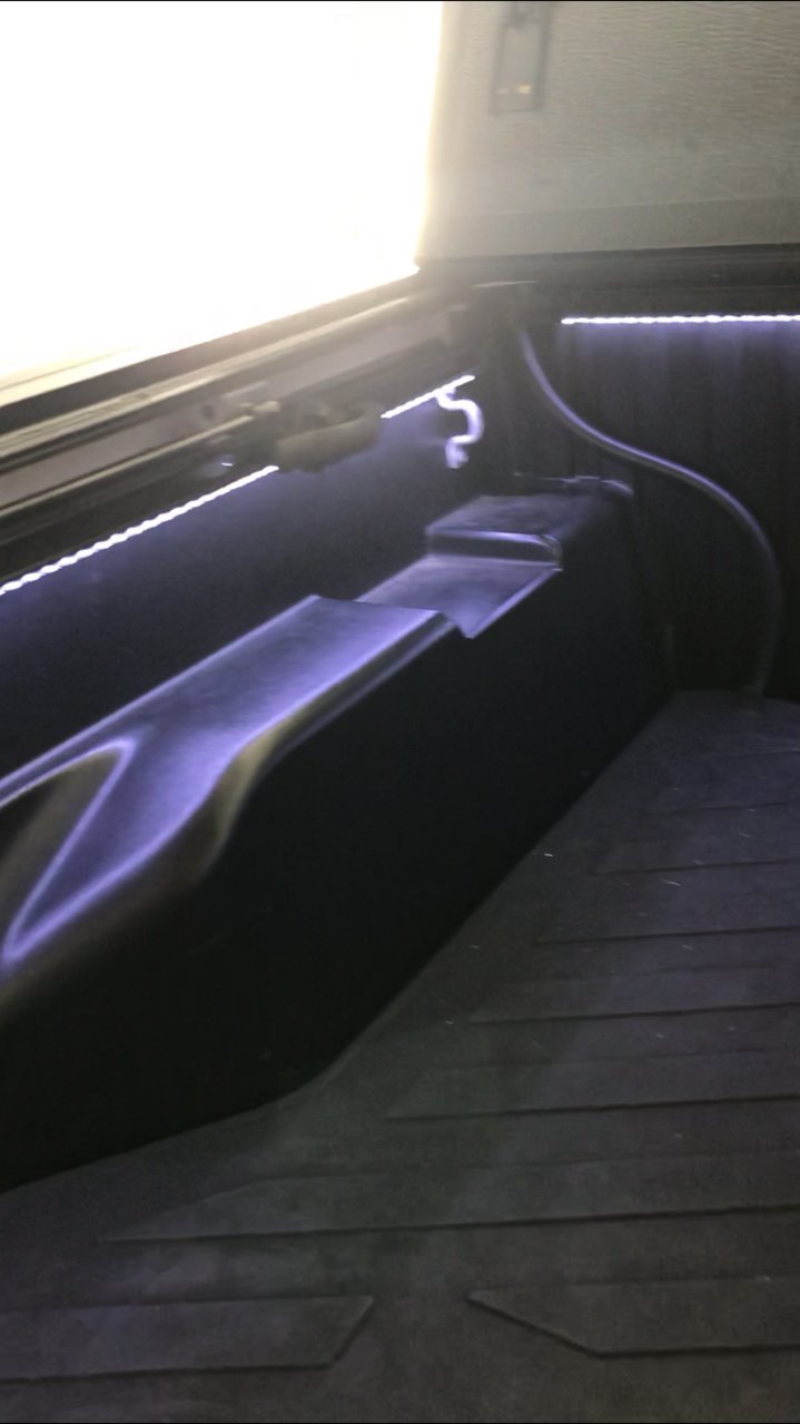

  20. Oct 27, 2024 at 7:18 PM
    #40
    Tacosha
    Tacosha Well-Known Member
    Sep 23, 2020
    #341728
    331
    Andy
    Calgary, AB, Canada
    2019 Black Tacoma TRD OR ACLB 6MT
    minor, TRD skid plate, front recovery points, Regken mud flaps, rear diff breather, AC drain pipe extended. Upgraded sound with active sub woofer, tonneau cover, CB radio.
