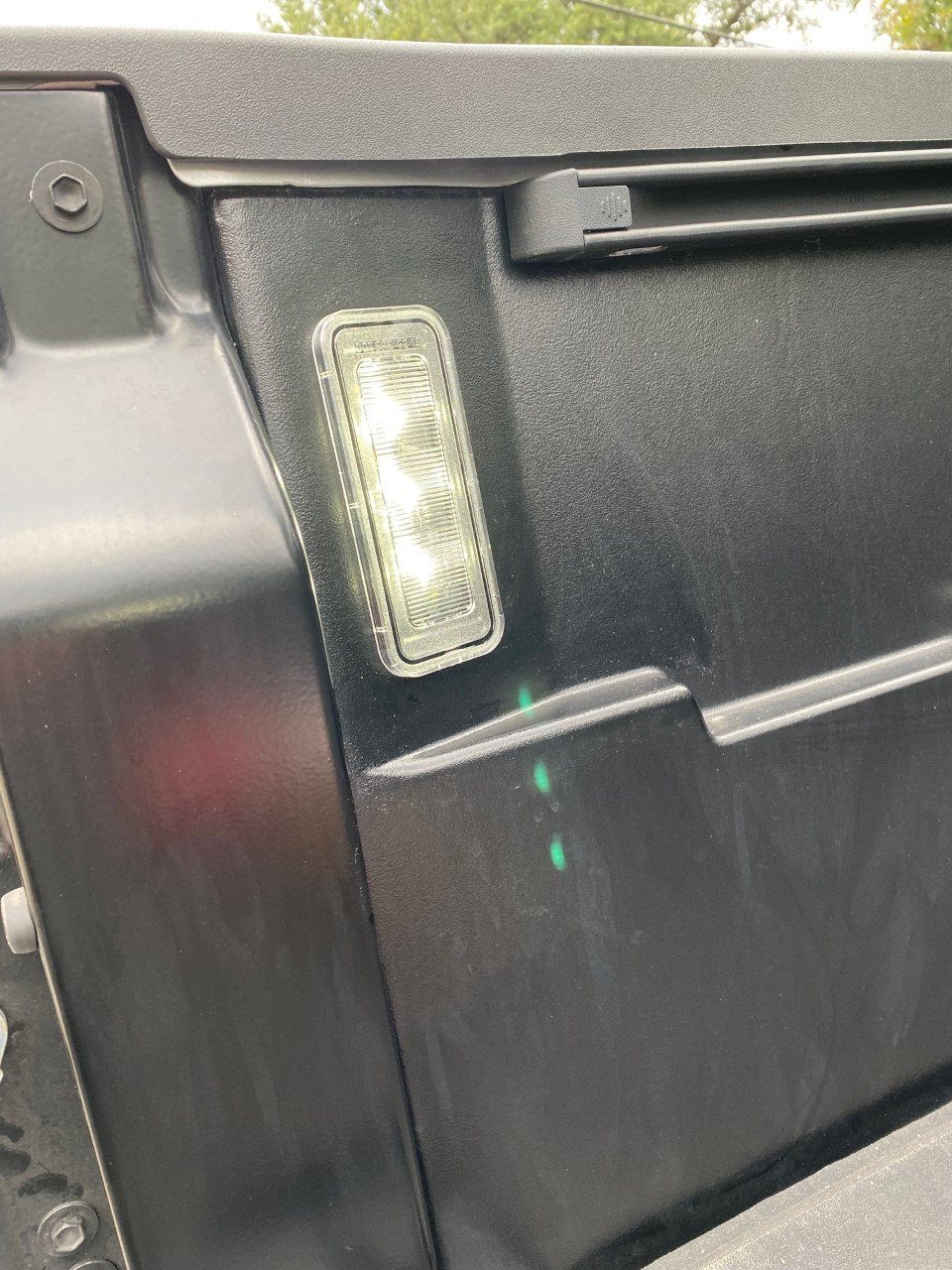

    My SR5 didn't come with them. I want to say they are around a $300 package. $29 through Amazon and 15 minutes worth of work. The rear tail lights on my Tacoma already have the pigtail and it's just sitting inside going nowhere. You do need to remove the tail lights, but that's two bolts - easy. I'll take some pictures tonight but they're bright AF. The bed light switch turns them on/off and they also come on when unlocking and opening the door. The kit comes with the lights and the cables to connect the lights to the pigtails already sitting there behind the tail lights.

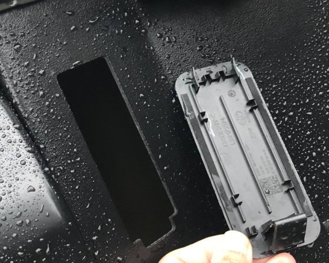

    For the LED's re-mentioned here, are you willing to remove part of the bed? Trace a template,
    cut the bed,
    sand then insert LED (x2)

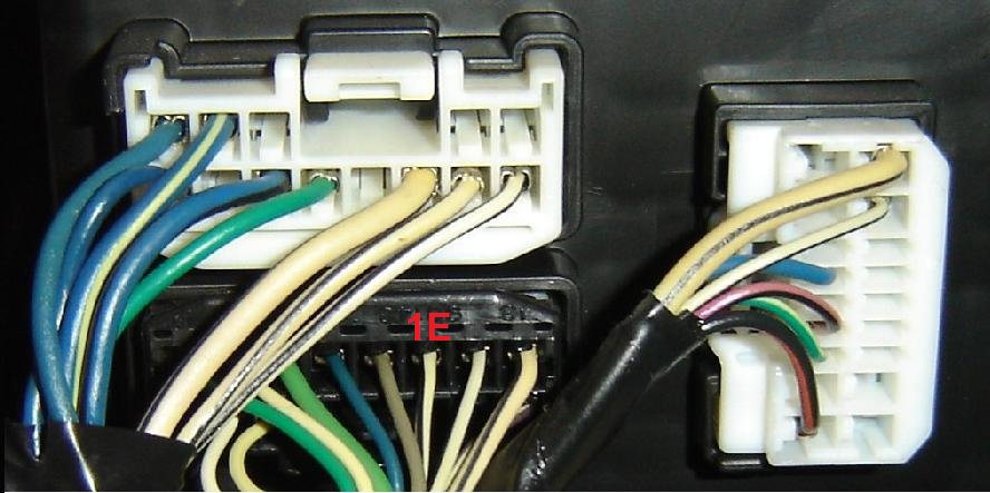

    Run stranded 18/3 cable (inside loom) from bed to cab (along the vehicle harness) under driver's seat floor plug to door sill cover, behind the driver's kick panel to connector 1E on the cab fuse box. Tapped ground, battery fused power and cab illumination control wire., same wires that control the overhead illumination in the cab. Weatherproof Switch at bed before the LED lights.
    P.S. If you add a door switch to the the tailgate in parallel with any of the door(s) switch(s) and leave the added switch (DPST) at door position the bed lights turn ON with the cab illumination, then turn OFF when you close the tailgate. (dim to ON, Dim to OFF feature).
