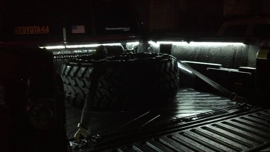

    LEDs are the only way to go. I did this to my truck today.
    IMG_7369 by tbrown6912, on Flickr

    You can build your own if you have very basic knowledge of electrical and how to solder, $15 strip of LED's, some wire, switch, double sided tape or velcro. Tons of how to threads floating around with endless possibilities to add your own twist.
    Completed my install today using the below items.
    LED Strips
    http://www.amazon.com/gp/product/B003G9408K/ref=oh_details_o01_s00_i00?ie=UTF8&psc=1
    Toggle switch with Black waterproof boot
    Blue Sea Toggle
    http://www.amazon.com/Blue-Sea-Systems-WeatherDeck-ON-OFF/dp/B000MMFIZS/ref=pd_sim_sg_1
    Blue Sea Toggle waterproof boot
    http://www.amazon.com/gp/product/B000MMC7HU/ref=ox_ya_os_product
    I used 18 gauge wire and connected to my auxiliary fuse block, recommend an inline fuse if you don't have an aftermarket fuse block yet.
    Installed the switch near the factory inverter:

    I used a few packs of those self adhesive LED strips you can get from Walmart and stuck them under the frame of my roll-up tonneau.

    2 pods with 9 leds per pod..... for 65 bucks.... or 12feet of LED's with an led per inch for < 15 bucks.... you do the math.

    You cant even see the LED strips underneath the bed rails!

    My fear with the 65.00 leds is shadowing.. what if you have some stuff right near the light? It wont illuminate the rest of the bed.
    I have the LED strips installed under the rails in my bed, 6 months later they work great (even through a MN winter). I did solder the connections and shrink tube them together at the corners, i didnt trust the chinsy jap connectors to hold up. And i did have to put a little gorilla glue on some spots that started to hang down too but that was my fault for not cleaning the surface well enough on install. I also have a Magnet Switch on the tailgate so the lights turn on automatically when i drop the gate, which is the BEST way to have these come on (kudos to another thread on here for that idea). I also put a toggle switch in line so i can turn them off if i want. I show this to my buds with factory lights on their new trucks and they're pretty jealous...
