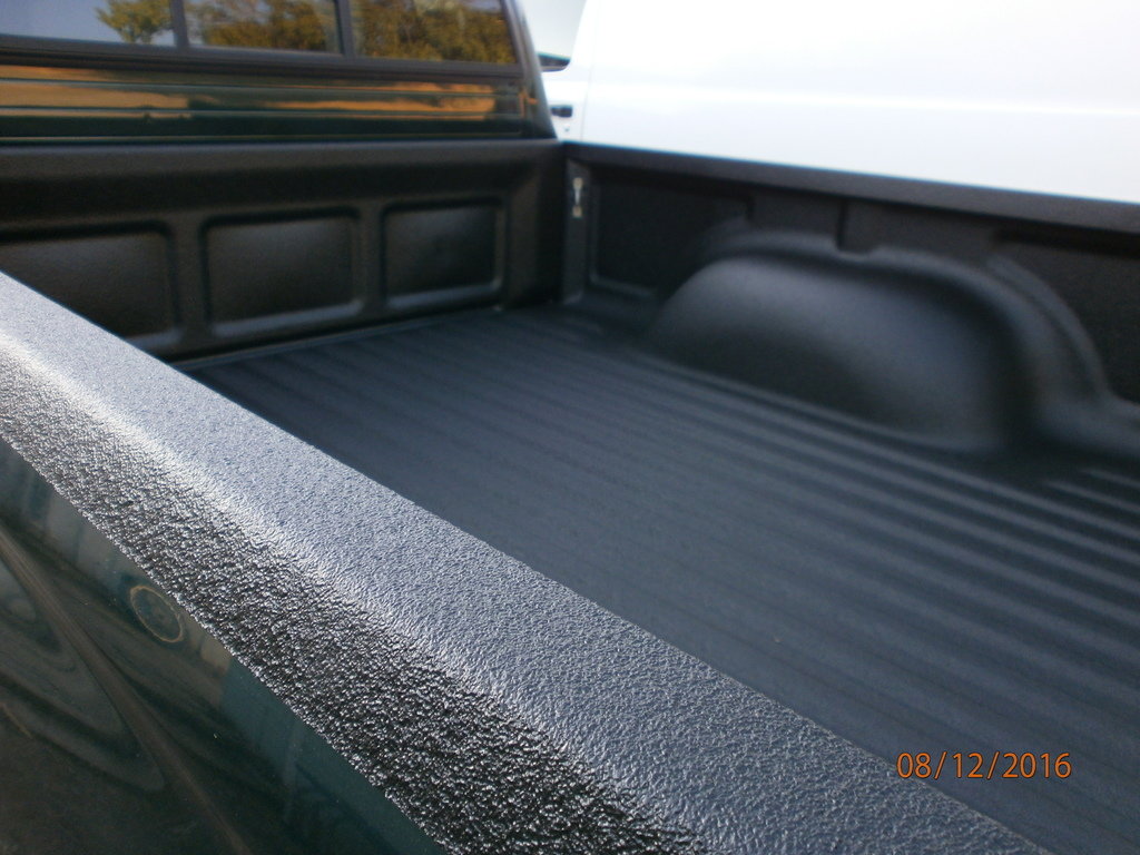

    My bed was probably similar to yours due to a drop in bed liner being in there for 14 yrs. No rust but paint worn down right into primer in lots of places as well as paint damage on bed rails from plastic rail caps. Went with Line- X and couldn't be happier with how it turned out. They prep bed as part of their price.
