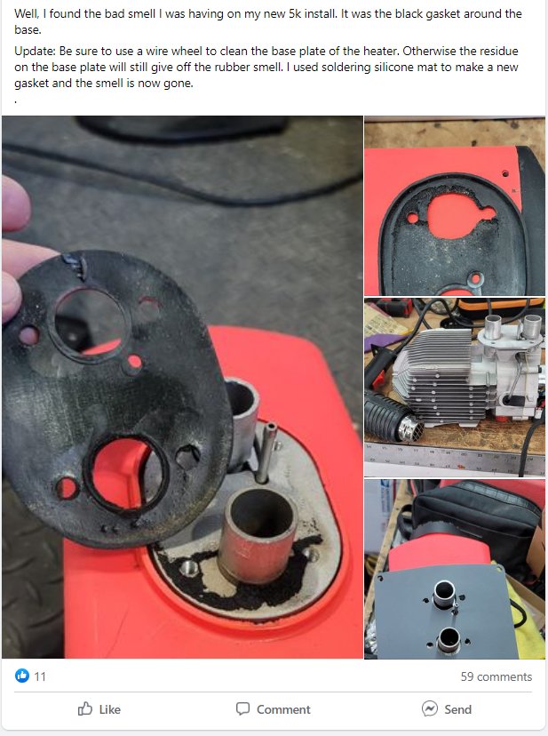

    I bought one of these a while ago and mounted it in a small case. It's got maybe two full tanks of diesel burned through it, at least 24hrs of run time. It still has a slight odor. It's not CO, my monitor wasn't detecting any so I put it behind my car to test (which it did detect). It's hard to describe the odor, doesn't smell of burning or exhaust. Anyone else have this experience?

    Maybe? The smell is there as soon as airflow starts, but doesn't seem to worsen as flow/temperature is increased. I ran it without the hose to see if maybe that was it, but it didn't help. I have heard some needed to run it for a few hours to get rid of odor but I figured 24+ hours would have done it

    Can you return it? I wouldn’t run it. If you have a smell, there might be at joint or something in the combustion chamber that’s leaking and letting fumes in. They normally put out just hot air. What do you have on the intake side?

    There is a pretty helpful Fb group that talks about trouble shooting these heaters. From what I read a lot of the heater are sold with the incorrect mounting gasket (between the heater and the metal plate you mount it to). I think a lot are sent with rubber instead of silicone which gives off a smell when it gets hot.
    Here's the link to the FB Group.

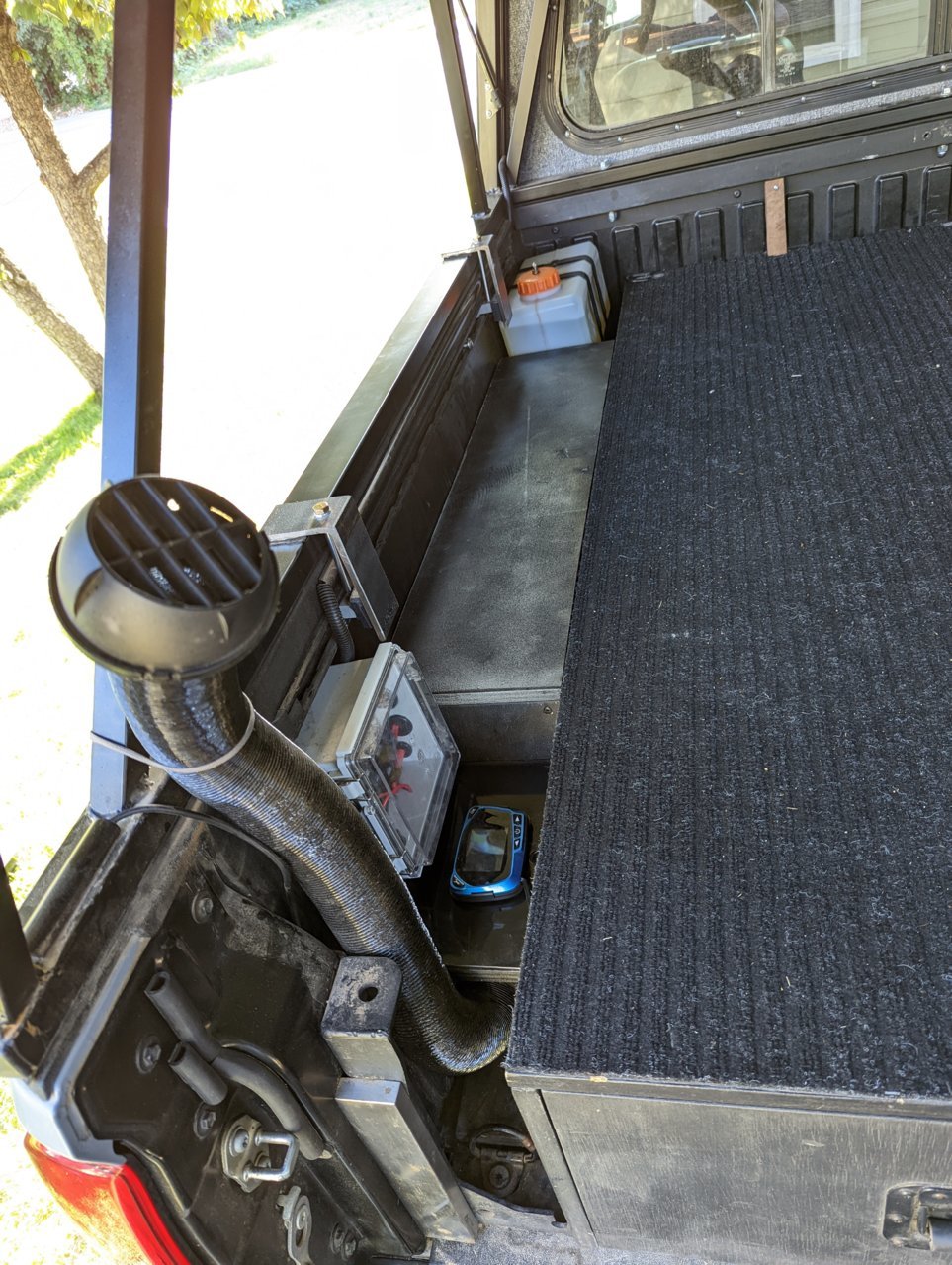

    This is how I installed mine:
    TheTacomaInn likes this.

    Very similar to how I'm planning to do mine. Are your drawers tight to the wheel well? Also how's it been working for you here in Colorado? I've heard they can be finicky at altitude.

    The drawer is tight to the wheel well and it has been working very well for us. It is a 2kw unit. Tuning for elevation is a little frustrating because these Chinese units come with mix matched parts a lot of times and you really have to know which fuel pump you have to tune it effectively. Once I figured out what size fuel pump I have, I was able to dial in my tune and I have used this thing effectively all the way up to 12k'

    That's awesome! Yeah I know when I was measuring my drawers the 2KW looked like it would fit good but the 5kw was going to be tight. Do you feel like the 2kw puts out enough heat? Looks like you built a Ripcord wedge. I'm wrapping up a similar style full pop camper now. The internet is telling me that these heaters only run about 50% heat output when you get above like 9K'.

    I like the 2kw for our camping. At 12k' and 25-30°s outside, it kept our camper at about 65-70°s inside.

    Do you have any other pictures on what the set up looks from the outside ? I am trying to do the same thing but have found zero information. You are the only person I've found that has done this. Any additional info on steps or what you did to complete this would be super helpful.

    This is my most recent update. I will try to snag a picture of what's going on under the truck soon.
