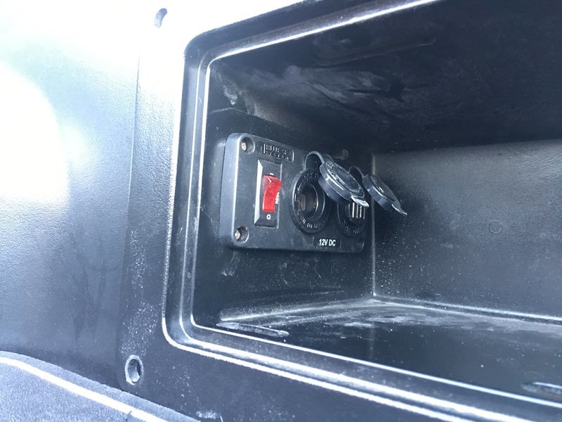

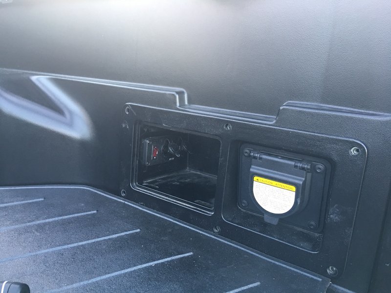

    Do what I did. This is wired to always be hot, when the switch is closed of course.

    I need to file the inside of the Power plug door so I dont cut my hand open again.... Damn thing will rip you a new one when trying to one hand it..

    That looks pretty cool. But did you just go straight to your battery for a power source?

    You should reverse the 12v socket and usb ports. The fat 12v is easy to plug in, while the USB sockets are finicky. You'll easily get the 12v socket in behind the USB sockets, but it'll be tough to insert anything into the USBs if there's something plugged into the 12v.

    You are correct. I learned this while camping 2 weeks ago and have swapped them already. Thanks for the heads up though man!!
