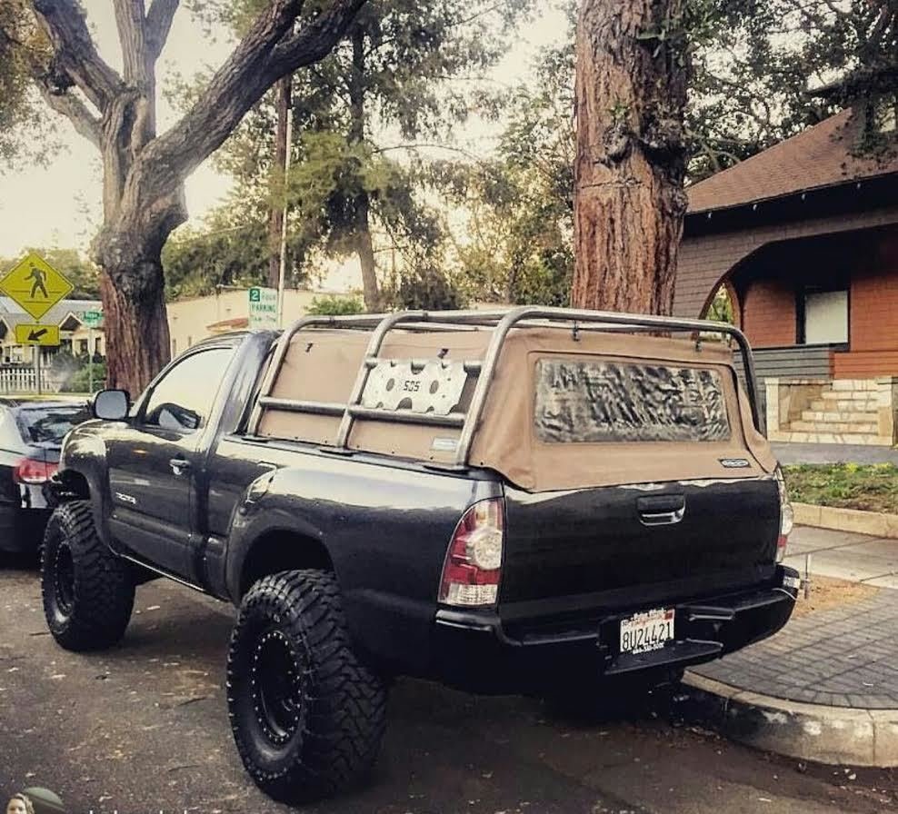

    Yeah so if you look at the 8020.net website here: https://8020.net/gallery
    And then click on the DIY link in the gallery, scroll down a bit and there are 2 guys that have built racks with 8020. One is a bike rack and the other is heavier duty.
    The cool thing about it being modular is that you can take it down (off) or reconfigure it as needs change. Welding one up almost ALWAYS results in those "oh shit" moments where once it's done and you start using it, you realize that you should have done something slightly different and now you are stuck. Or you have to take it back to the fabricator and have him modify it for you. $$$
    Maybe put some thought into the base of the rack being steel that you can have fab'd up to your liking and then configure the top section(s) out of 8020 and use stainless hardware to keep it all alive through the seasons. Maybe get the base powder coated when it is done to stave off galvanic corrosion between the aluminum and steel and run with it. Or just go with all 8020 and have the option of buying new pieces as need dictates.
    Here is the pic from 8020.net

    I'm going with aluminum from SOS Concepts for over my Softopper for my RTT

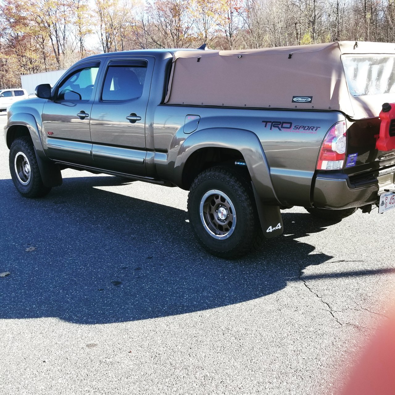

    That's a stock pic from their site, but this is my truck it will be going on.
