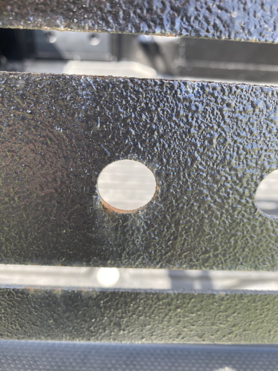

    Need some quick advice.
    My bed rack has some rust spots on it. Its over a year old and in iowa weather. So im not complaining about it. Its a kb voodoo which i found out (just recently) that they have been reported to have these issues before.
    Im not complaining; just want some advice on how to fix.
    Since the entire rack is not rusted, and only area's; is it best to just take a small wire brush, sand the rust down. add a primer, and then spray on some rust o leum?
    Since I probably wont get the paint to match, I planned to spray entire thing down with some under coating. If I do that, do i have to sand all of the rack down (including the Powder coated area's that are not damaged) or can I just sand the rust areas, use a degreaser on the entire rack, and then spray it.
    Never done this work before so Im genuinely asking since I have no idea. Lots of different answers on here so Im trying to see what is spoken to do the most.
    Ill add some pics below
    Thank you!

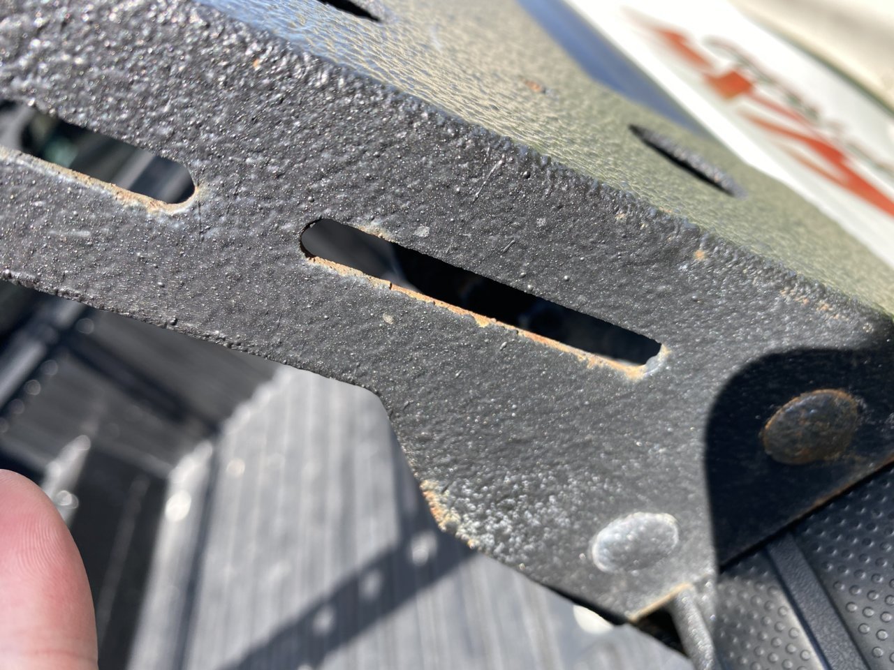

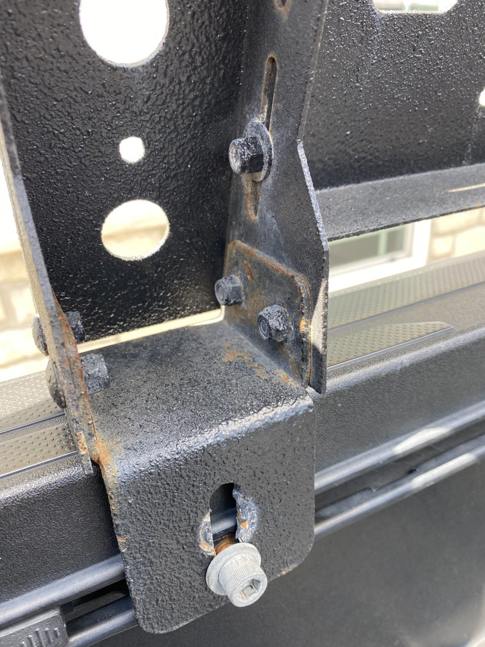

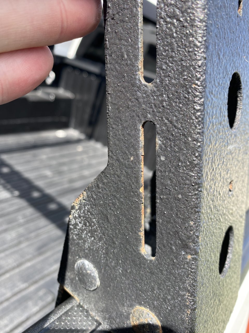

    Here’s some of the areas. It’s nothing horrendous. Much better then some have had. But I for sure want to fix what I can

    It looks easy enough to wire brush those areas and repaint.
    I thought it was going to be huge sections of the straight bars
