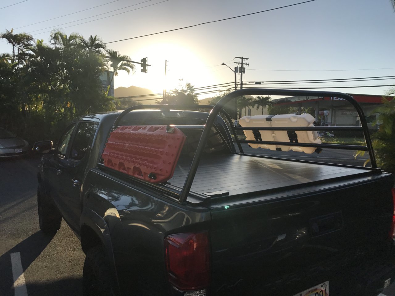

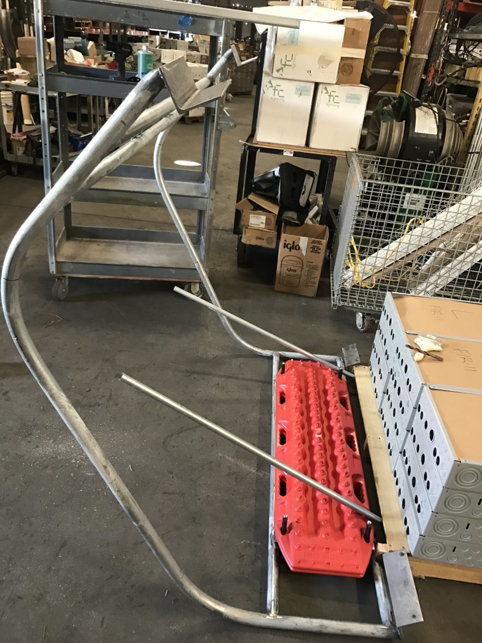

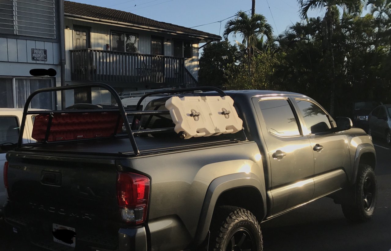

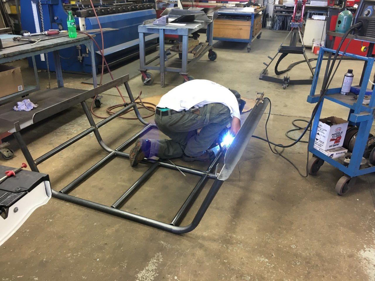

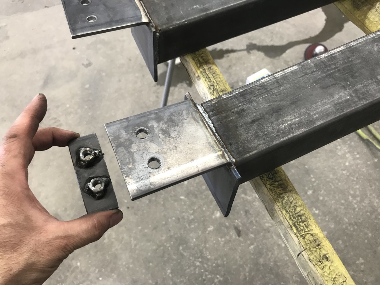

    2- Water 2 gallon Rotopax will be mounted on passenger side on short brackets.
    2- maxtrax will be mounted on driver side on longer brackets. Super happy with how everything came together. Taking my time was very beneficial in the end.
    Still need to drill holes in the flat steel brackets that connect the top and bottom front to back bars so that I can mount all things mentioned above.
    Will most likely brush on the primer to fill in any unwanted blemishes from welding and to give a quality base layer. Still deciding whether or not I'm going to be brushing on the finish coats.
    In two years when I get my rooftop tent, I will be welding in top front to back bars for mounting purposes. At that point I will take it to a professional to be blasted, prepped and powder coated.
    Until then, this whole build will cost me roughly $70 give or take. That number covers paint and stainless steel hardware.
    These things sell for in upwards of $1200 shipped to Hawaii so I am beyond stoked to be coming out of this less than 100 bucks!

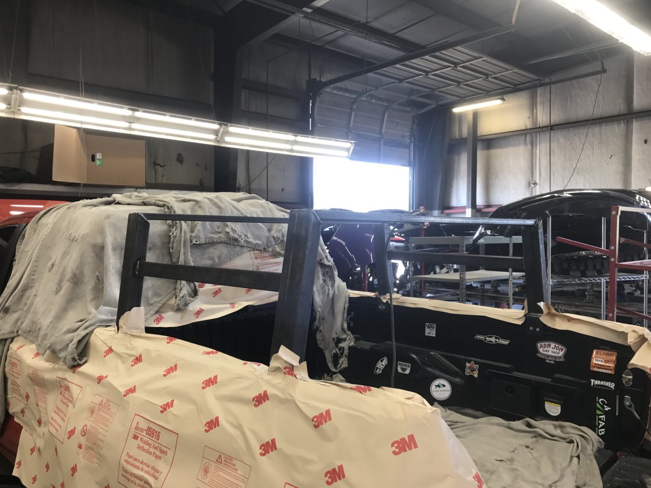

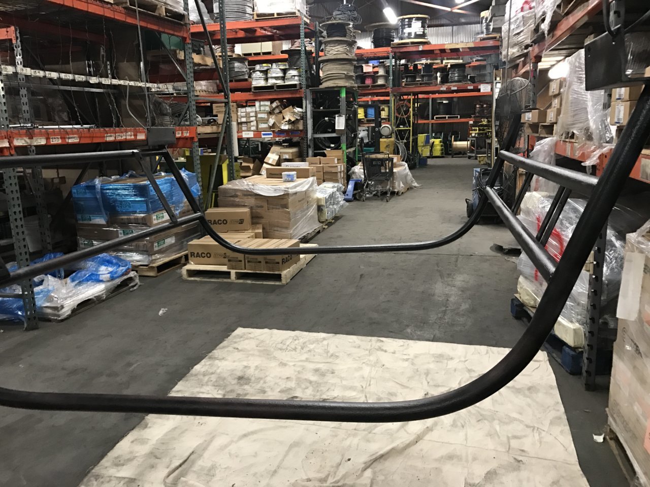

    Prepped, holes drilled, and primed with a first coat!
    I decided to paint on an epoxy based primer. It will be a great base coat that will harden and protect from any potential future rust. I will be letting it sit over night and then spraying on another primer, as well as the finish coats first thing tomorrow morning!

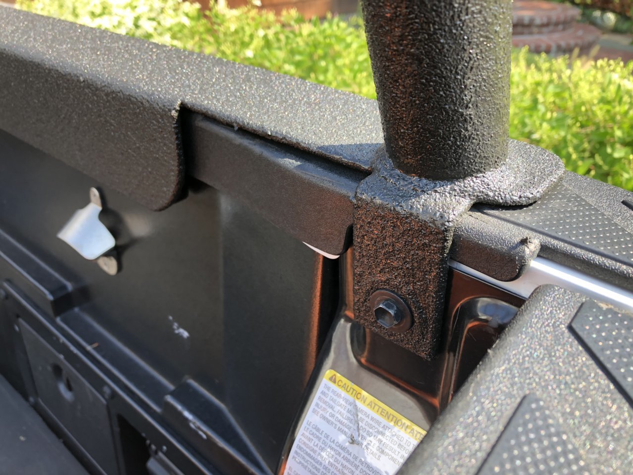

    16 trd ORdcsb4x4 c4 swingout rear, cbi t3 front , arb lift,16"grabber x3 rtt, hilift,jerry cans,and sliders . 81 hilux trail donkey
    Cool man I did something similar a while back . I used 1/4 flat bar trimmed to size for the bed rail track and welded nuts on the back to secure. I made mine angled to mount a bat wing awning . I always debate if I should have bent it though to look better but it was free as well so meh .. nevermind I did by hardware .

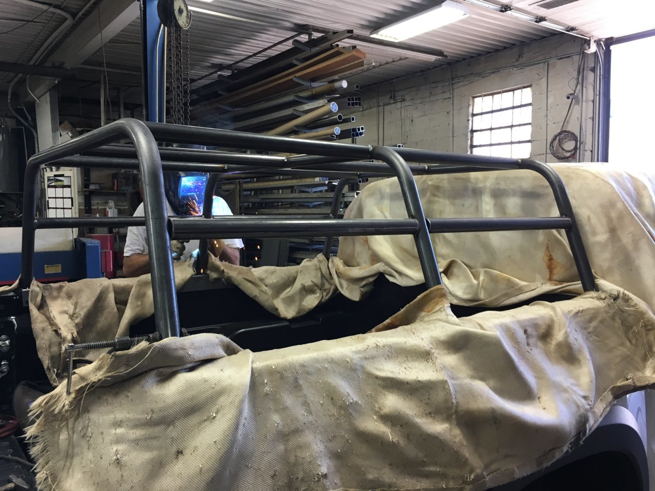

    I built one out of schedule 40... then had the whole rack Line X it’s been about 9 months holding up to the elements very well.

    Very cool, man. Stoked that I'm not the only one to use that bolt near the tail gate! Looks awesome.

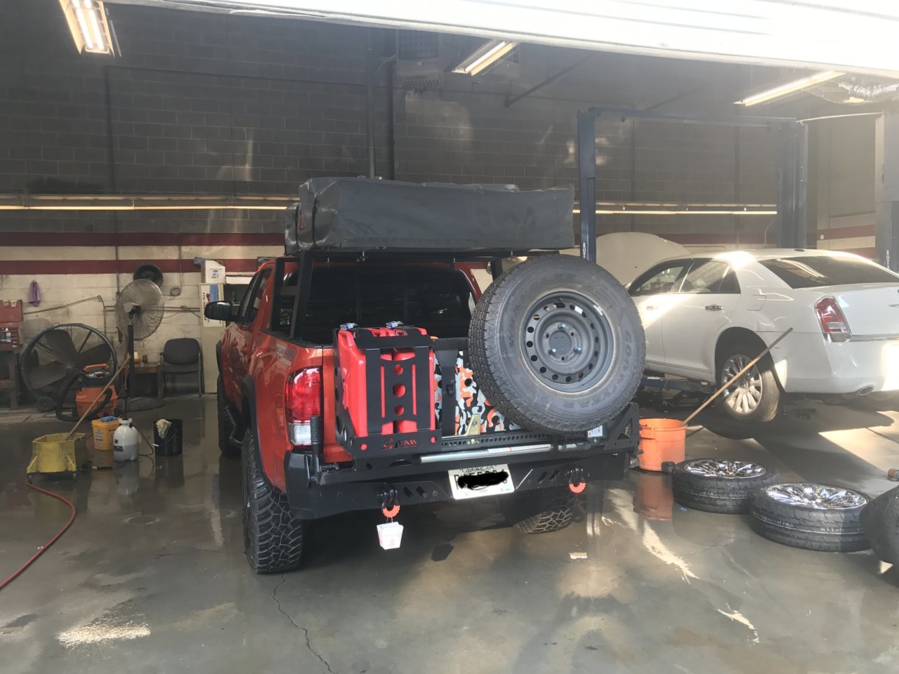

    Yeah there pretty awesome and this ez up couldn't hang in high winds

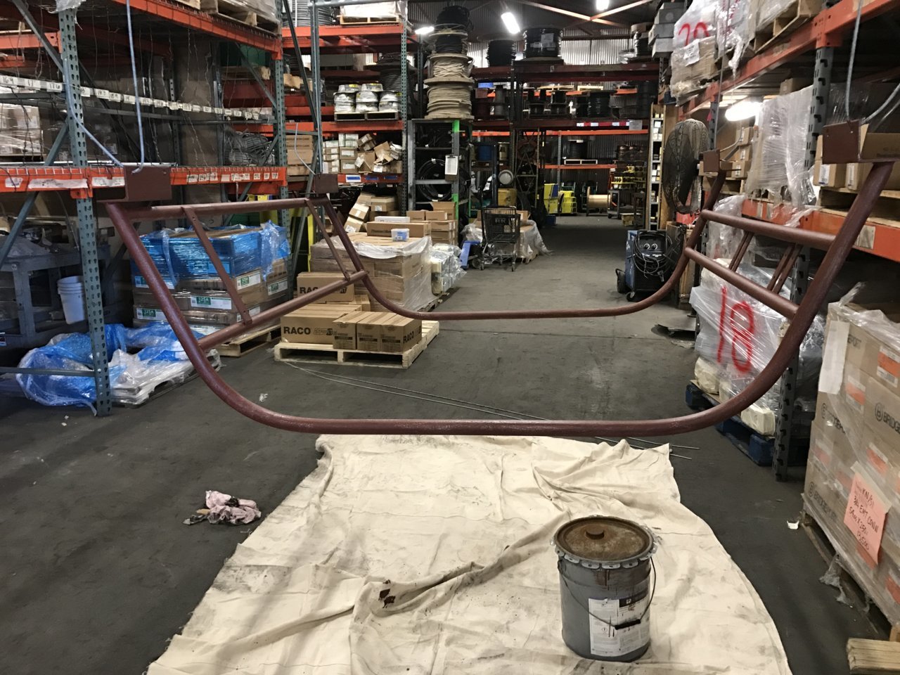

    Second stage of primer on welded joints and bare steel areas (without hot dipped galvanized treatment).

    #275320
    1,795
    First stage of finish coat!

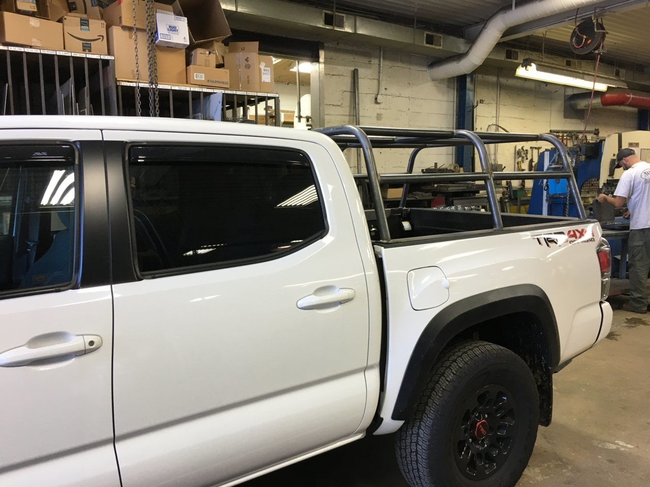

    I'm proud to say my rack is finally finished. Took about a month due to my busy schedule but I can't believe how good it turned out (in my opinion obviously).
    Like I said from the beginning all material except paint and hardware was free. I spent $40 total on the entire project start to finish! It's not professionally made, or brand name, or perfectly painted/assembled, but it was 40 MF-ing bucks so I ain't upset. Haha. Thanks for all the support .....
    Here it is!!
