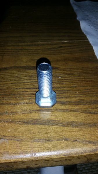

    Trying to do a few mods for my bed rail system. Want to do the ammo can one and can find the right bolt that will fit in the rail system. I have read several of threads on and they said 1/2" carriage bolt and that did not fit at all. 3/8 did fit but pretty loose i dont known if a washer would help combat that. Looking for some insight cause i dont want to have buy everything and not be able to put it on. I dont want to buy the special t-bolts if i can. Homedepot is the most convient to me.

    5/8 carriage bolt with mods works great. Let me find the pic.

    5/8 but have to grind down the part that goes into the rail

    Is a hex bolt or carriage bolt or does it matter?

    Hang on a min I'll go find one of the ones I made and put a pic up

    The square part of the bolt fits the bed rail perfect but large round part has to be ground down to fit

    Gottcha didnt realize that i guess in the write ups. Thank you for showing me
