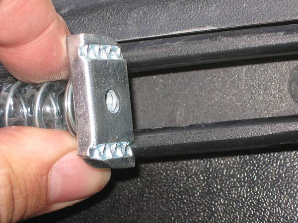

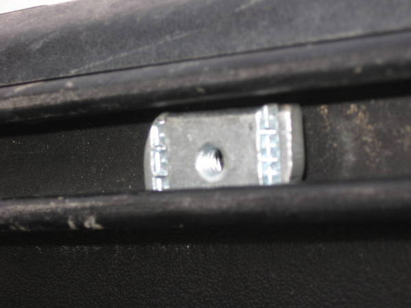

    ok, I found one in my tool bag. It doesn't fit sideways, it is just a little bit too small, and it is much to large to fit properly. It does fit, unmodified in the spot where the rail is bolted in, because there is a hole on the top and bottom of the strut. I will be making a smaller one tomorrow anyways though. here are some pics.

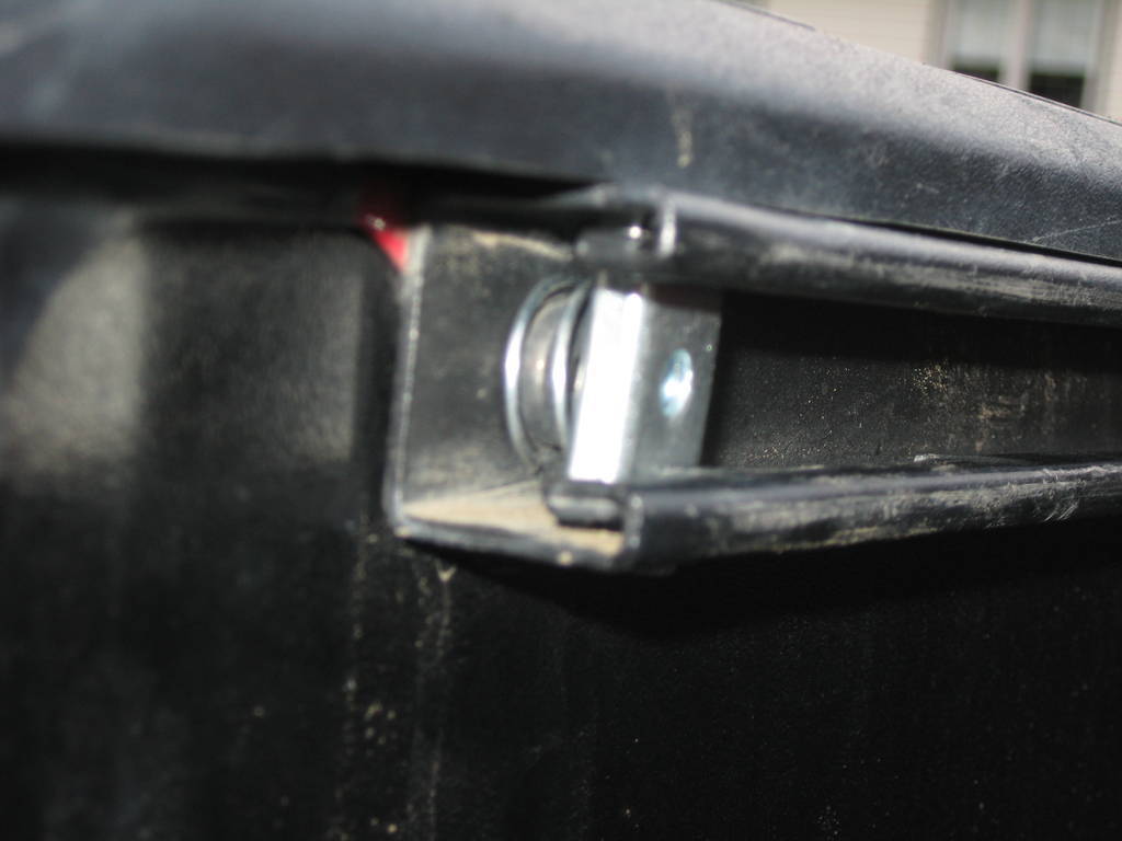

    ok, here ya go, the pics I promised. The nuts fit in perfectly, and give, in this case a 1/4" by 20 threaded hole.
    i also finished my satoshi, I know, the billet is still underneath, I'm getting rid of that tonight.

    It looks like you only had to grind down the ends...so the height was OK? What size are these unistruts?

    Bilstein 5100's front and back, dakar 3" leaf springs, Westin bull bar, piaa driving lights, piaa replacement bulbs, H/U, 2x10" mtx tt65 subs, 1000w clarion monoblock, Mtx surround speakers. green wire mod. Flowmaster 40, airaid intake. scanguage II.
    an standard unistrut is 1 5/8" from outside to outside, the springnuts are just over 1 3/8" the ends need to be ground down, so the length is around 7/8" to 1"ish
