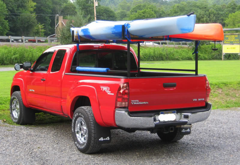

    Some thoughts:
    Confirm the class of your 8MM cleats if you can. Although your design gets the benefit of your cleats, you might be putting yourself (and others) at risk. You're pretty clever with the rack you made, so if you can't confirm the class and scurity of your fastener, you might want to design something for that. Paint for sure as rust is the number one killer of welds.
    If you have access to a gantry crane and a force gauge, you may want to do some testing to be sure that your emergency planning/theory are intact. Pull up, forward, backwards and side to side. Final note: secure your craft to the truck. To keep the payload centered, the straps you have are ideal. However, you need to secure the payload to the vehicle. In most countries, you are legally required to do so.
    Good luck!

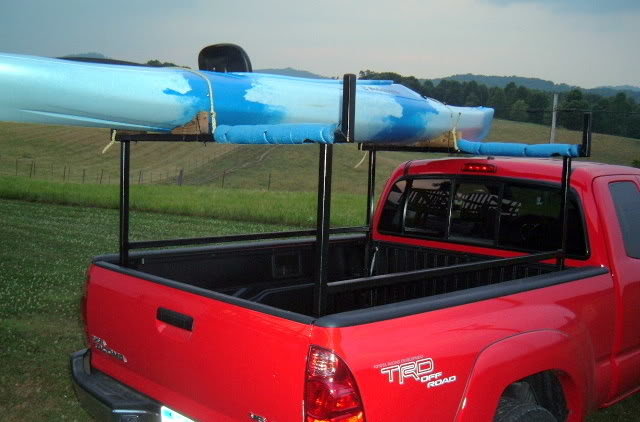

    Here is a rack I made for my Tacoma.

    I usually haul 2 -12' kayaks or 1 - 17' canoe on this rack. It has been on the road at least 30,000 miles on three different trucks with zero problems. At the time I made it I think I spent like $130 on the metal and welded it up myself, it has been a great investment.

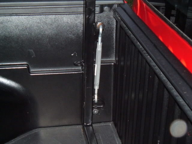

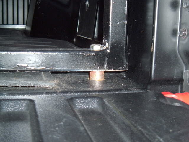

    This is how I mounted my rack:
    Rear mount, I just take out the factory installed tie-downs and use the same holes to mount the rack.
    Front mount, I use a turn buckle and hook to the Toyota tie downs mounted in their suggested location.
