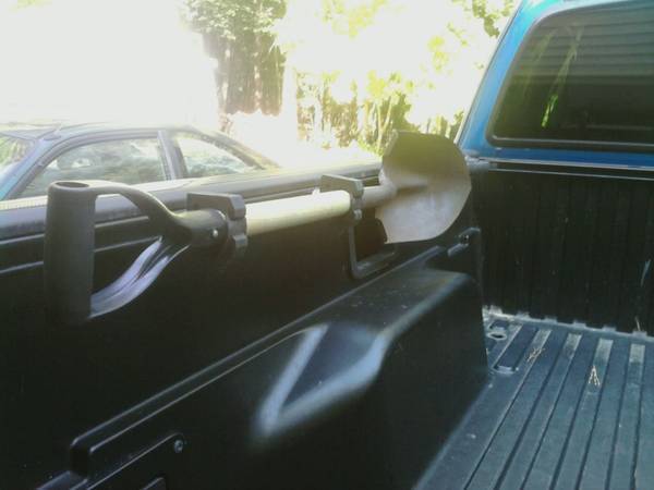

    Are the heads of these bolts large enough to have to slide them into the side of the tracks? I could see with a long enough bolt, you could drill a hole or two into the handle of the tool, shovel, ax, etc., pass the bolt thru the tool handle and tighten down with a wing nut/washer set up?

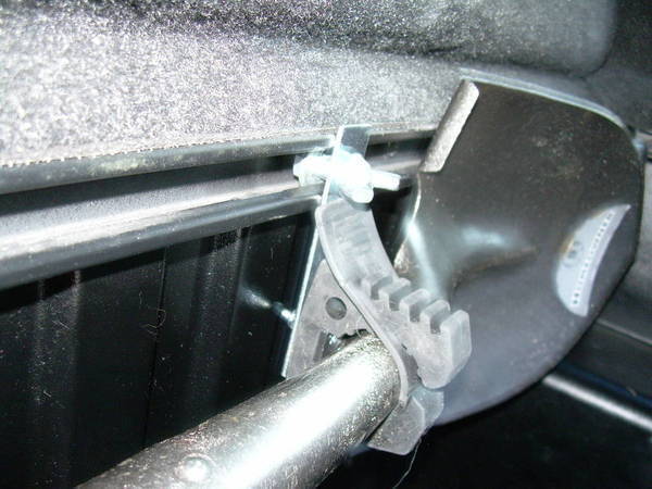

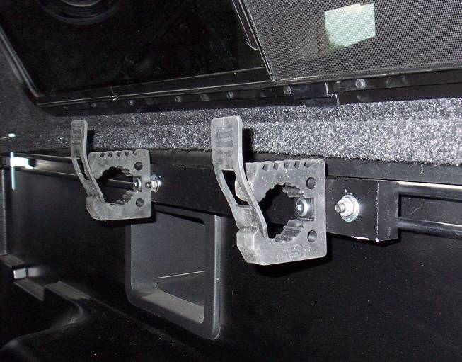

    I found the Quick Fist a option to consider. I believe it could be drilled out to accept a 3/8" "mounting bolt", which you then could attach the quick fist directly to the bed rail with a T-nut and mount any item you desire. Or, for those who want or need to drop down and have the item mount below the bed rail, simply make a "drop down bracket" out of 1"x 1/8" stock from Home Depot to the desired length. Then, mount the quick fist to the bottom of the drop down bracket, and mount the bracket with the T-nut to the bed rail. This would be ideal for the guys who have a shell or top which you would need to have the mounted item below the bed rail. Just a thought. For those who do not mind a couple of small holes in the side of the bed, simply mount the quick fist anywhere you want directly to the bed. Each quick fist hold 22 lbs. I attached the info sheet of the quick fist, which also hightlights how to use the quick fists to mount a high lift jack. :cool:

    PSJ, we already beat you ;)
    Here's my writeup here
    Also, here's an install one of the other forum members did:
    Thank you for mentioning the Hi-lift instructions, I forgot about that. I'm not sure if it will work, but I'm going to try more research.

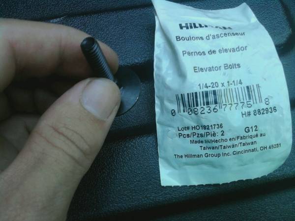

    Just went a got some of these, also picked up 2 packs of 1-1/2" long and price was $0.10 a pack. Error in their computer.

    Had to use a 1x2 spacer to mount the Quick Fist in the Leer topper and the 1-1/2" elevator bolts worked.
