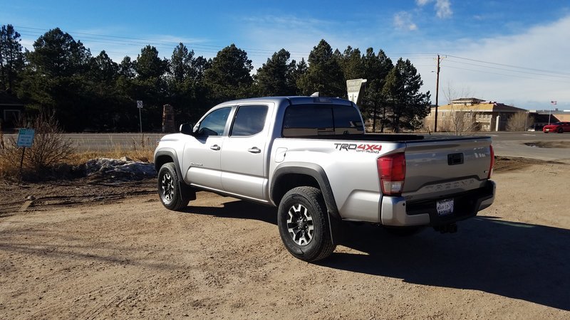

    Good Evening,
    I recently purchased a '17 silver DC SB TRD OR. I am researching which shell to buy, based on weight and overall security. I will be using the vehicle for daily commutes mixed with Rocky Mountain outings with my family. I am concerned that the vehicle might sag excessively if I keep the stock OR suspension. I was hoping to get some assistance with opinions and pictures of sleek camper shells and if you upgraded the suspension to cope with the additional weight.
    Below is some Tacoma porn:

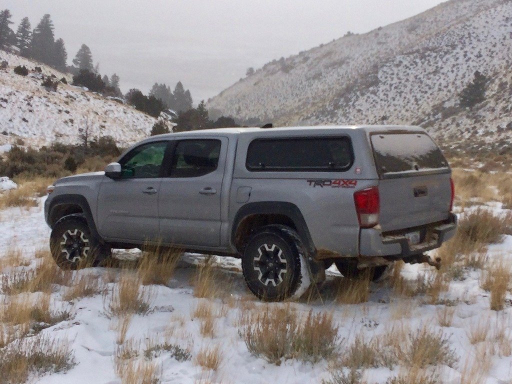

    Stock plus a topper
    My 2007 Taco with a shell was having a sag problem when I hitched my teardrop up and loaded the bed. I added Sumo springs and swore by them. I assumed I'd be adding them to my 2016 but was wrong. Maybe in another 120,000 miles but not now.
