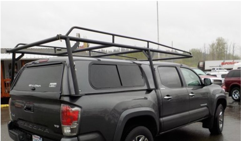

    Along the same lines, does anyone know who makes this rack that can sit outside of a truck bed canopy?

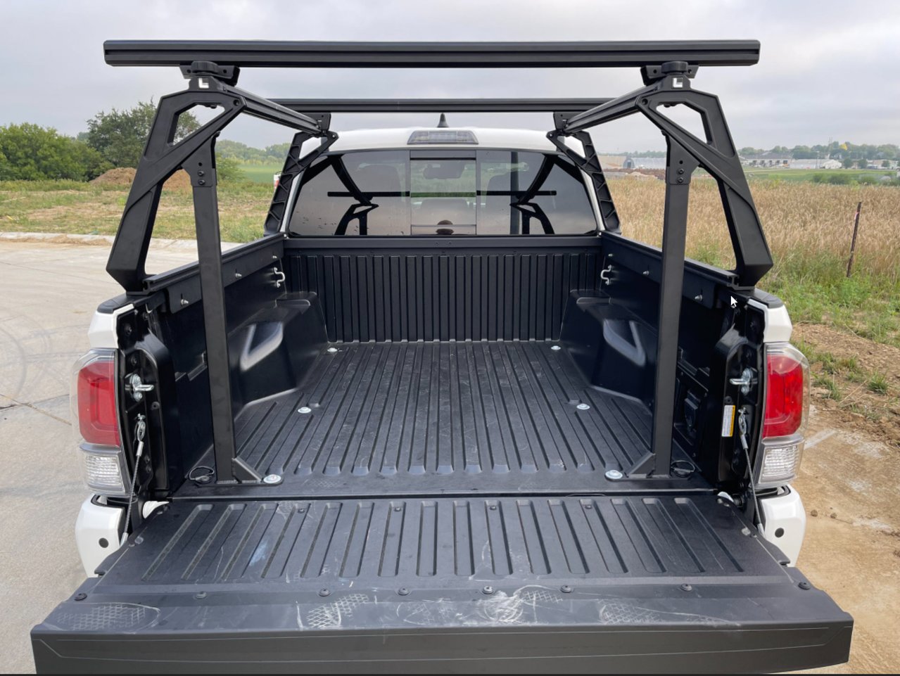

    My Leitner ACS forged rack is rated for 400 Lbs dynamic off-road capacity which is the most load the rack will be under. Static is 1400 lbs, and dynamic driving is 800lbs. If you look at how the Leitner ACS forged sits, it utilizes the bed rail system as well as two vertical load bars at the tail gate. If you are driving and off-roading with your RTT I would not solely rely on the bed rails without reinforcing.
