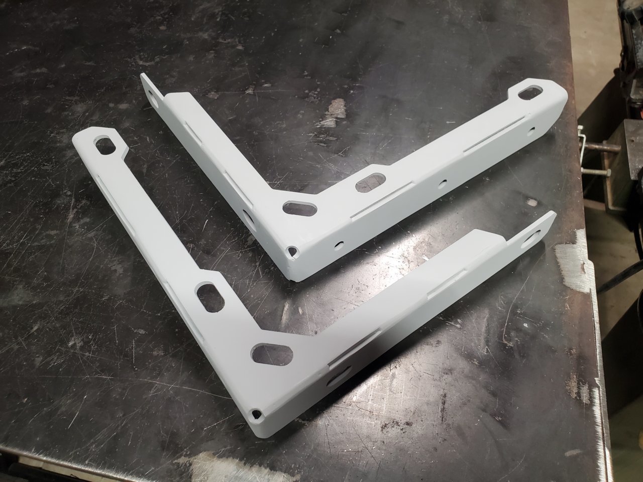

    Commenting as an engineer, the design of these is almost useless for doing what they are supposed to accomplish (stiffening the bed corners to stop the bedsides from spreading), since the most important area for strength (the metal at the corner--see my attached markup) has been cut away. The whole purpose of these is to stop spreading of the bed sides and this cutout almost renders this "stiffener" useless.
    A lot of so-called stiffeners are manufactured this way, I assume, because it is quite a bit cheaper. Don't recommend any of them. Look for one that has a continuous piece of metal in this location. Also the really short ones (with arms of 3 to 4'') won't do the job either. Probably 6" to 8" long arms are the sweet spot. Longer arms don't hurt as far as strength but won't add any real extra strength either.
    Also they are made a lot stronger by having the pieces that everyone hates (in this design they are the pieces with all the cutouts in them). These pieces stiffen the stiffener and make it stronger. (but not enough to make up for the corner cutout) I see lots of commentary at how some stiffeners are "better" by being almost flat to the sides and the beds by not having these. They may be "better" for looks or making it easier to put things in your bed but they are pretty useless as stiffeners.
    Having said all this, buy what you want, but if you want a stiffener don't buy these or similar ones with the corners cut out or ones with short legs.
    Also stainless is really an outrageous waste. Nothing else on your truck is stainless. Paint is fine.
    OZ TRD and Kwikvette like this.
  14. Jul 30, 2023 at 4:57 PM

    Here's how I remedied the weak bedsides in my Tacoma. (Fabbing done by a local build shop, back before I became comfortable w/ a grinder & MIG welding.) 1/4" steel plate, the cross-bar is continuous to the other bed side. Same setup at the front inside corners also.

  16. Jul 30, 2023 at 5:53 PM
    #36
    Waynebarkr
    Waynebarkr Well-Known Member
    May 20, 2020
    #328723
    323
    Wayne
    Phoenix
    2020 Cement DCLB TRD-OR AT
    Now THAT is going over and above. Quite some overkill but those bed sides won't be moving.
    D.A.S. Taco likes this.
  17. Jul 30, 2023 at 5:57 PM
    #37
    Kwikvette
    Feb 27, 2019
    #284735
    82,482
    Fresno County
    4 run, 2 don't
    I like that you pointed that bit out.
    I can tell you right now the reason why that part was cut out is to expedite manufacturing.
    Parts are CNC cut, then bent as part, only to be done when powder coated.
    Can't be any simpler than that.
    I bend mine and weld them at the bends, especially tying in that bottom corner.
  18. Jul 30, 2023 at 5:58 PM
    #38
    GilbertOz
    GilbertOz Driver
    Oct 18, 2018
    #269844
    1,909
    CA
    2014 AC V6 MT 4WD, 84K miles
    FOX 2.5, Deavers, ARB, OTT, 4xInnovations
    I use the truck for work & like being able to load it up as heavy as I please & not worry about it. The main reason it's built like that is to transfer loads from the KargoMaster roof rack (rated 1000 lbs cargo capacity) and the ARE DCU cap (~280ish lbs) directly to the frame. (Although technically the loads are going through the 4 composite bed mounting posts into the frame, which may accelerate wear on the bed mounting posts. No slap/clunk there yet; elsewhere there is a good thread on TW about how people have solved that with the right size & type of thick flexible washer.)
    Just upgraded from stock suspension & springs to Fox 2.5's all corners and Deaver U402 stage IIIs. Have yet to try fully loading it up and am optimistic it'll finally be able to carry 1200 lbs of cargo + a 300-400 lb trailer tongue load without squatting to the bump stops. I don't do this regularly, only from time to time.
  19. Jul 30, 2023 at 6:19 PM
    #39
    Waynebarkr
    May 20, 2020
    #328723
    323
    Wayne
    Phoenix
    Very well done! What you have done looks like the optimized version of a bed stiffener. Not too long, not too short, corners complete. Looks really good from strength and versatility points of view.
    And I agree 100% with your reasoning as to why the manufacturers cut out the corners. Cheaper and faster (and their customers don't know any better)
