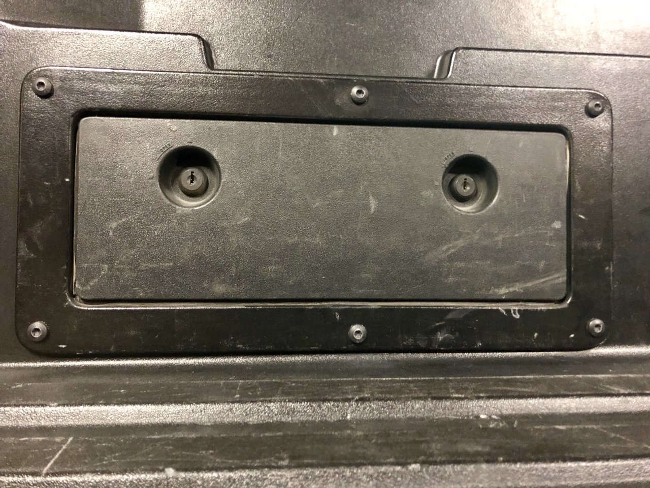

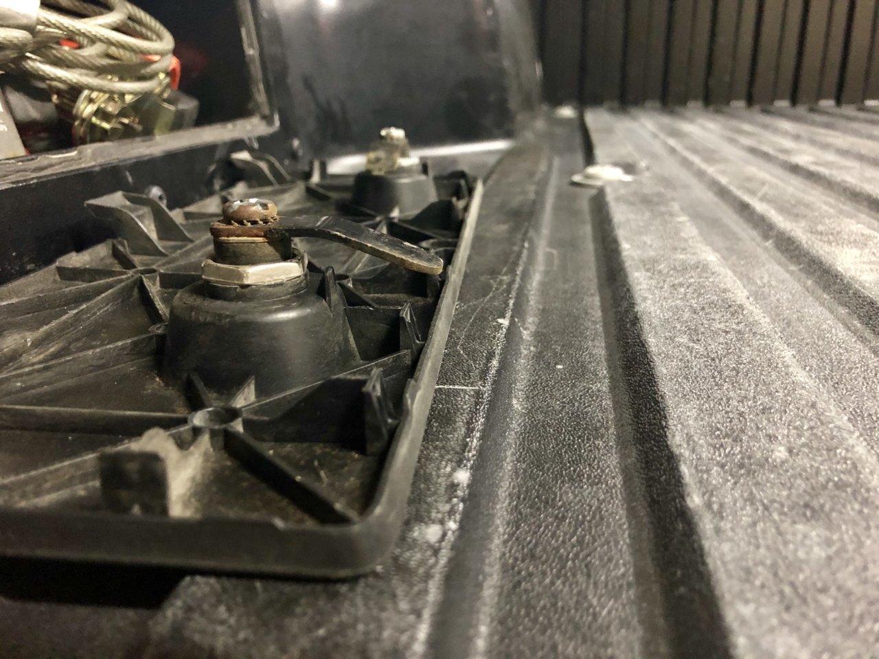

    5C79FD54-B93A-4BEB-8BDF-A20D57440D2D.jpg C72B939A-6B38-4BC9-9928-6B9E6695573A.jpg
    I got mine here: https://padlocks4less.com/black-cabinet-lock/
    The arms weren’t long enough to reach the hole but some scrap metal, a little filing and a bit of bending solved the problem. Also as stated above get the locks keyed alike and non-retaining so you can pull the key out once unlocked.
