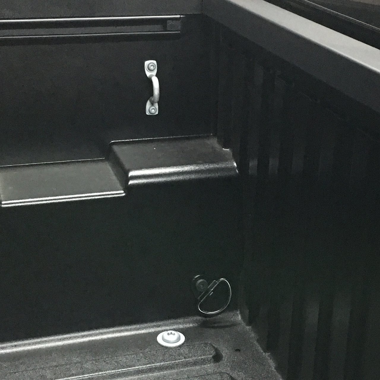

  3. Jan 25, 2018 at 8:28 AM
    #23
    truckstick101
    truckstick101 [OP] Master of the lean
    Jan 24, 2018
    #242248
    61
    2018 Tacoma TRD Sport 4x2 Cement
    Is that new d-ring location a hard point?
  4. Jan 25, 2018 at 8:51 AM
    #24
    Pistol Pete
    Pistol Pete Go Pokes!
    May 29, 2013
    #105142
    4,065
    Eric
    Oklahoma
    2016 MGM DCSB OR 4x4
    Clazzio leather seat covers, CBI T3 front, SOS sliders, SCS Ray10s, 285/75/16 Duratracs, debadged, extra bed D-ring tiedowns, Advantage TorzaTop, OEM bed mat, custom center console organizer, Husky liners, remote start.
    D rings on the bed bolts
    shakerhood likes this.
  5. Jan 25, 2018 at 9:20 AM
    #25
    Topanga Taco
    Topanga Taco BUZZING NITRO
    Jan 6, 2018
    #240465
    2,080
    Rick
    Topanga Strong Southern California
    2018 SR5 4x4 DCSB Harrop rear E-Locker
    The Magic of ALSD RCI-skid RAS-Sumos Bilstein 6112/5100
    I don’t believe so. There must be a steel plate that it threads to, though. I’ll check after work. This composite bed is strong on impacts. I’ve let go of big rounds of Eucalyptus from as high as the side rails and the bed never cracked.
  6. Jan 25, 2018 at 10:53 AM
    #26
    NV_Spencer
    NV_Spencer Well-Known Member
    Aug 14, 2017
    #226806
    209
    2020 CREWMAX / 2017 OR DCSB
    this is definitely new. That black D-ring is on the floor, under the bed bold on my '17 off road
  7. Jan 25, 2018 at 11:05 AM
    #27
    thumpper
    thumpper Well-Known Member
    Mar 27, 2016
    #182477
    159
    Bob
    Nebraska
    2008 Taco
    For a sport bike I would do the D ring mod in the bed/frame bolts up front. I used the Dodge D rings when I did it. I know in the past tailgates haven't been the strongest so may want to consider supporting that area when loading/unloading. (I can kind of be paranoid at times though so may not be needed)
    Enjoy the truck and have fun.
  8. Jan 25, 2018 at 11:06 AM
    #28
    Clearwater Bill
    Clearwater Bill Never answer an anonymous letter
    Oct 11, 2014
    #140097
    24,723
    Billy
    Largo Florida
    '13 5 lug AC w/convenience package
    A few OE parts from fancy trucks
    If you'll look up from under the truck with a bright light, between the body and the bed, you'll see their reinforcement.
    It's actually a stronger setup than most people think, because it's more than just a couple of screws into the bed. So it's great for securing a lot of smaller stuff with straps and such.
    However, it wouldn't be something * I * would use for a motorcycle. Or securing a car engine I was hauling, etc.
    D rings under the bed bolts is right for those loads.
    Better even than the corner mount pieces, as ultimately they depend on the mounting of the rail system. Of course they are much stronger than the silver bits as they have many more attachment points.
    Keep in mind there is a difference in securing the load for simple travel on paved roads vs travel over rougher terrain vs a panic stop vs getting t boned and spun around. Kinda comes down to your risk tolerance for a specific load.
    tonered likes this.
  9. Jan 25, 2018 at 4:06 PM
    #29
    Topanga Taco
    Jan 6, 2018
    #240465
    2,080
    Rick
    I’ll have to agree. It’s a bitch to put that backing plate in. I doubt a dealer is going to spend time there thinking he’s going to make more money. Looks like it’s a factory thing. Best I could do, the space is freakin tight.

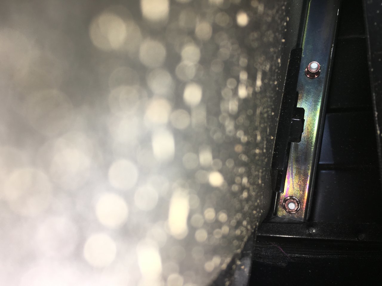

  10. Feb 4, 2018 at 10:20 AM
    #30
    Topanga Taco
    Jan 6, 2018
    #240465
    2,080
    Rick
    For reference.

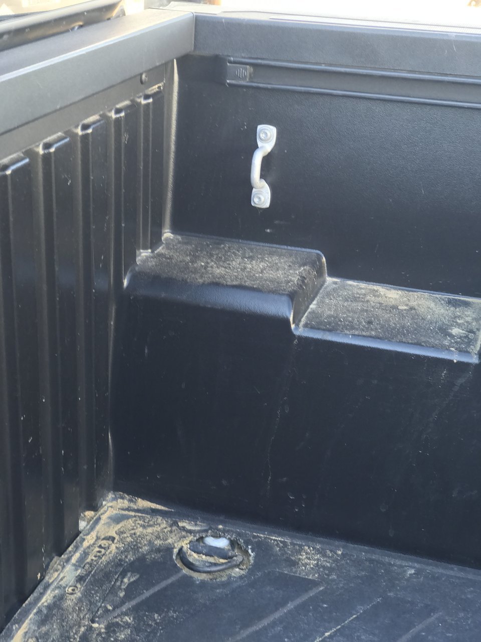

  11. Jan 25, 2021 at 12:29 AM
    #31
    tbird95
    tbird95 Well-Known Member
    Mar 7, 2013
    #99215
    447
    British Columbia, Canada
    TRD sport SR5 V6 DC, LB, 4x4, Tow package
    4runner heated, signal, courtesy light side mirrors, rearview mirror w/compass, temp & backup cam w/ pop luck PL 5400, Interior lights/gauges, BHLM, grillcraft MX black. Third brake light LED swap, rear tail lights LED swap from 2011. 3" Toytec (Boss) Coil overs, rear TSB AAL Bilsteins, Light Racing UCA. TRD grill badge, VIPER Smart Start.
    I have been searching endlessly for the tie downs from the first pic? Need p/n
  12. Jan 27, 2021 at 9:48 AM
    #32
    kgilly
    kgilly Well-Known Member
    Jul 26, 2016
    #192937
    1,604
    Kurt
    Pennsylvania
    2016 DCSB SR5 4x4
    Bed cover and Mud flaps, OEM Audio, Super Bump stops, Sumo Springs, Bed Stiffeners, Stryker hood shocks
    mine 2

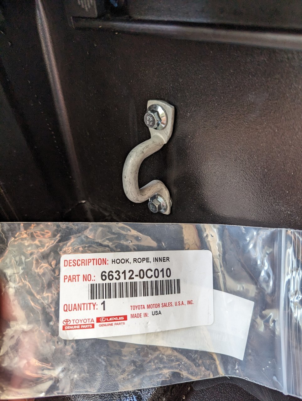

  15. Jun 29, 2023 at 3:29 AM
    #35
    TacoRexy
    TacoRexy Member
    May 2, 2023
    #423805
    11
    2023 Tacoma Trail Edition
    Just wanted to add that if anyone is looking for the part number for those hooks at the front the OP originally messaged about the pic shows the correct Toyota part# for them.
    My 2023 had the holes and backing plate, but no hooks. It's a trail and one of those holes was used for the in bed cooler and storage which I removed.
    Those tie down hooks aren't cheap though! $25 a piece...
    Toyota Part #66312-0C010
    Additionally, the bolt needed is going to be an M8-1.25x25mm. A 20mm is probably long enough to work and a 30mm would probably work as well as long as the shaft near the head isn't void of too large of an area of thread. My local hardware didn't have any 30mm for me to check that out so I went with the 25mm.
