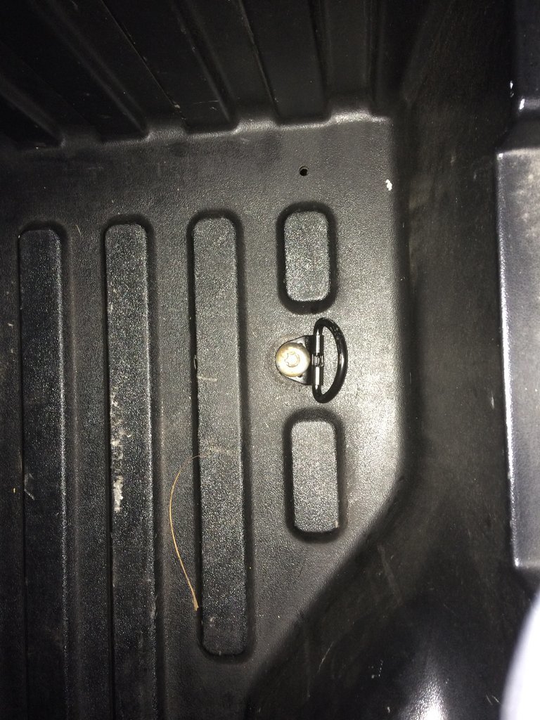

    I have a 2013 so I already have tie down points in the front and back of the bed but I wanted a tie down in the middle as well to strap down kayaks. I ordered the 5 pack of D-rings from Army surplus for $6.
    They definitely jingle around and to prevent unwanted movement and noise I squirted silicone into the hinge area. I drilled a couple new holes in the middle of the bed just next to the wheel wells. The composite bed is definitely closer to fiberglass than plastic as you drill it. I just used some hardware I had in my toolbox to bolt it on then shot some flat black paint on top then underneath the bed.
    I removed one bed bolt to check it out but it was much larger than the hole on the Army surplus D-ring and I didn't want to spend an hour filing the hole larger to fit. Drilling new holes was much faster. ;)

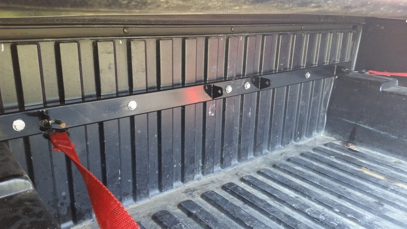

    That's what I built to haul dirtbikes cost me about $40 theres also a piece of flat stainless steel on the back side of bed so bolts can't pull threw

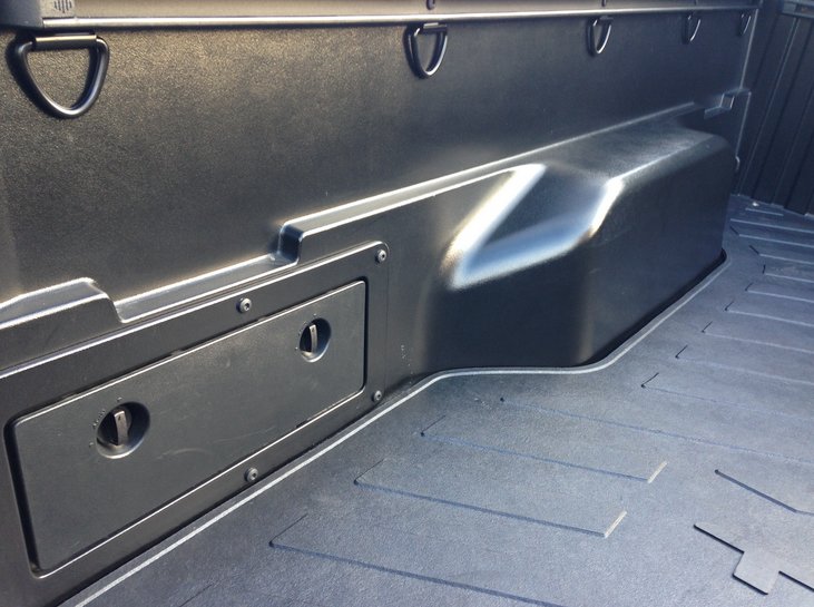

    I know these aren't tie downs to the bed bottom, but I have the Army Surplus D-rings on the sides, behind the bolts on the slide rail. They are solid as a rock! and very very convenient.. sweet for $6 lol
