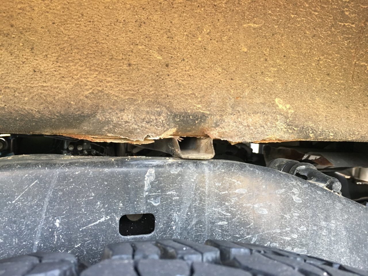

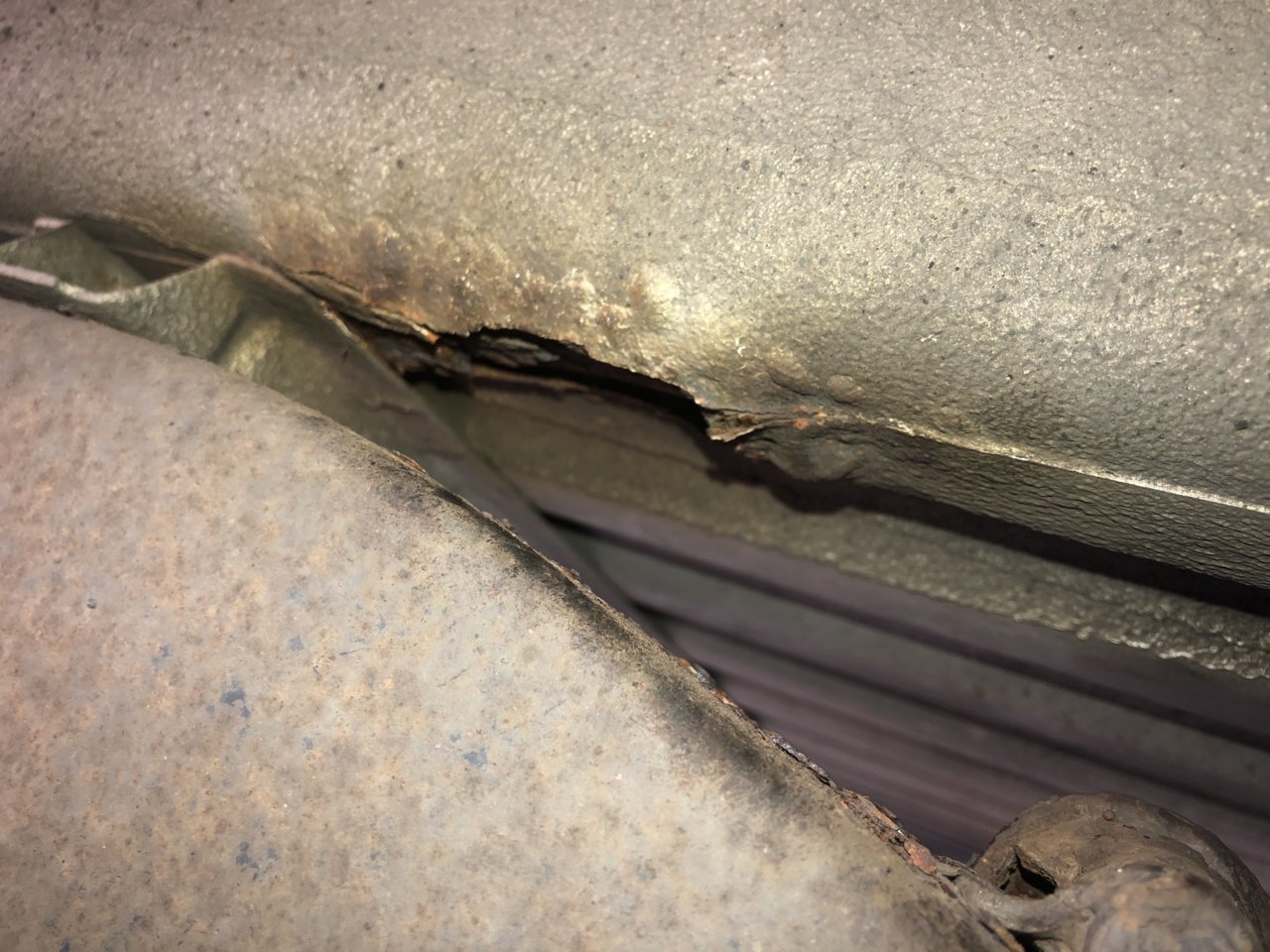

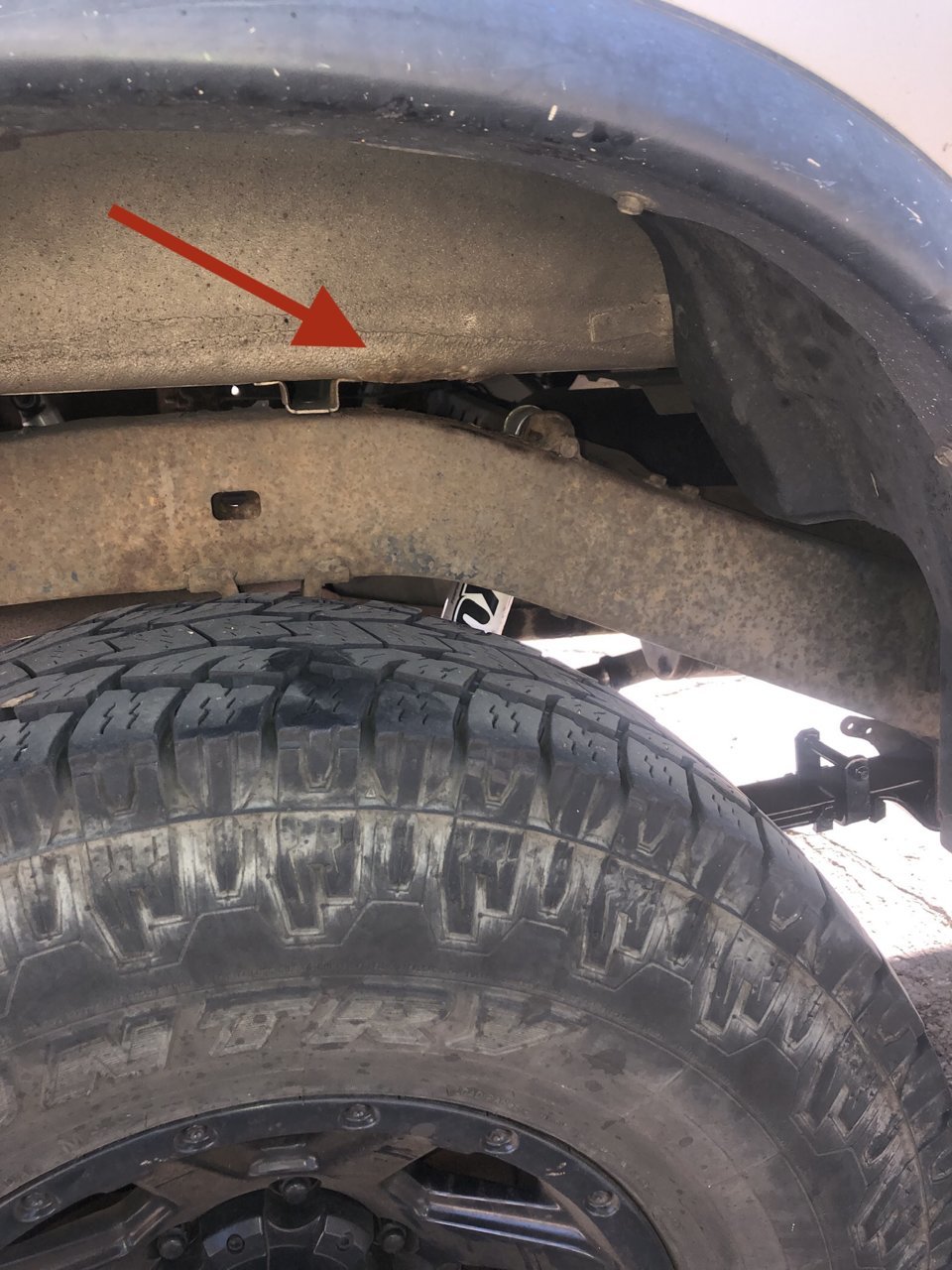

    Hey everyone. I’m looking for a little bit of guidance on how to fix up my truck; yesterday I discovered some rust on the underside of the bed. It completely flaked off leaving only the bed liner above it. Does anyone have some recommendations on how to fix it? Any guidance is greatly appreciated! I posted a few pictures to help illustrate where the rust is exactly. I will do a more through inspection later on today.64C9D37E-FD9A-4C91-A8CC-F844E344BF05.jpgD49D2939-F699-487E-A6A0-AA7175E781AA.jpg8D51B83C-C1F6-4367-9BFE-BB98EDE40244.jpg

    did you remove the liner yet?

    It’s a spray on linex style liner so I wouldn’t know how to go about that

    I had that happen on an old chevy. I cut the bedliner away from the affected area. Took a cut-off wheel and cut the cancer out. Welded in some plate plate metal to cover the hole and then coated in chassis saver paint. about 4 layers of that. I had easier access though. Better it's the bed and not the frame :)

    The ben liner was put on by the previous owner unfortunately. That’s what I was thinking as well, guess it’s time to buy a welder!

    I'm gonna be making a build thread that shows my restoration efforts for my rust bucket truck soon. You might want to check that out. I'll try to remember to post here a link to it when its up. But I just swapped off my entire rusty bed with a gently used one, and I'm very happy and rest easier at night. But to specifically answer your question (OP) I'd highly encourage you to lift the bed. Sounds like a crap ton of work, but having just done it its not the hardest thing I've ever done. Pull the tail lights, undo the six bolts that hold it down, winch it up, drive out from under it, let it down, flip it, and go to town with whatever rust cleanup you want to do. Much easier than crawling around on a creeper under the bed, banging your head, straining you neck, dripping crap into your eyes, etc. Grind the bad spot(s) all down to bare metal, patch weld in the holes with some fresh metal, metal filler (ex. USC All Metal) over that, prime, paint, undercoat, put the bed back on, badabing.

    If I had the resources to do that I would be down but I can’t think of how I would be able to take the bed off given the tools I have at my disposal. I’m not an experienced welder but my roommate has more experience than me. I’m going to get under there after work today and do a full assessment. If this is the one spot then I will fix it, if there’s more I’ll reach out and have some help swapping beds!

    My 2003 rusted in the exact area as yours, it is from the outside in. I know because I have a BedRug along with a bed cover so it is not moisture from on top going down. My fix was to cut out the rust and basically caulk in a new piece in (can't remember what I used, but it was automotive caulk) and then sealed from underneath. Check twice a year and FluidFilm 2X a year also. I am in a rust belt state of Ohio so far it has held up well.

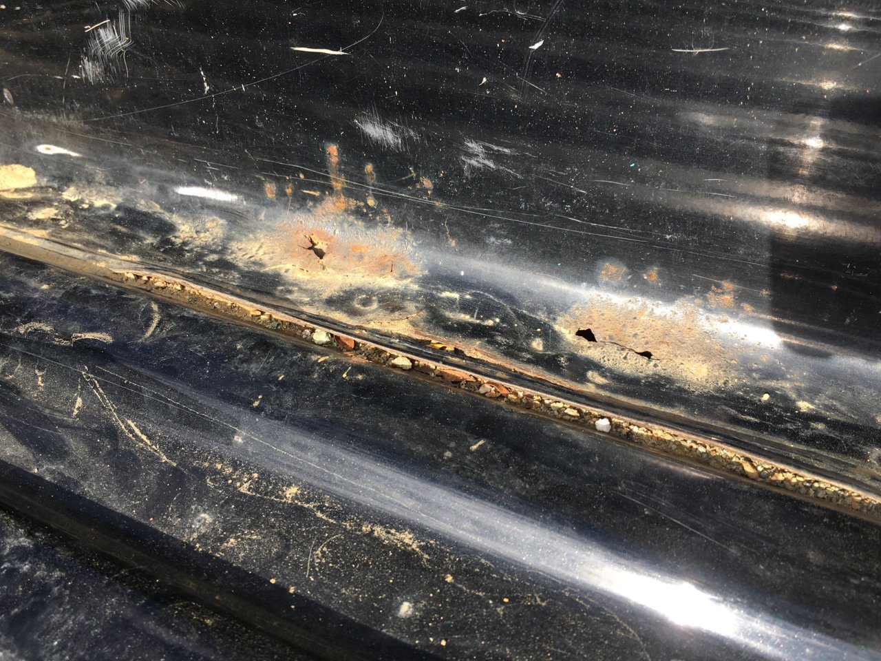

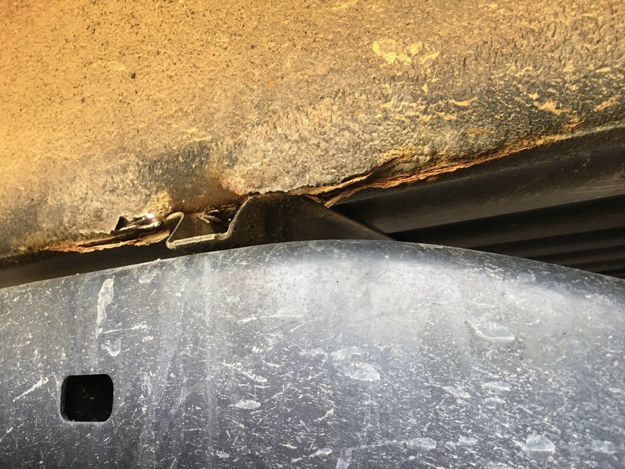

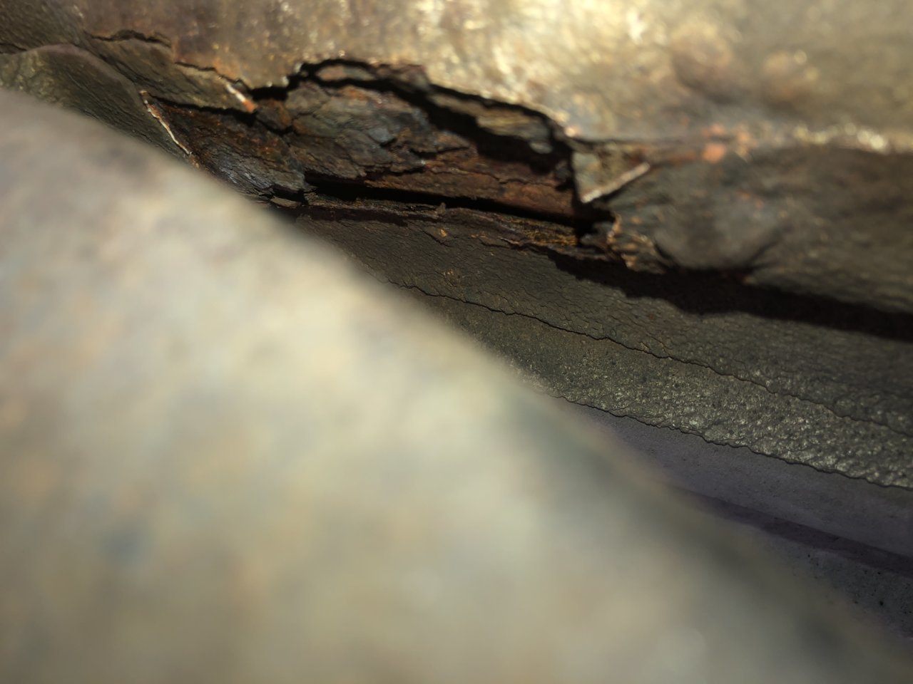

    I too have this bed rust...passenger side bed wheel arch area.
    I want and need to address this very soon. The frame was replaced several months ago, but this a separate issue outside the scope of the service. The sooner I can get this repaired the sooner I can get the bed LineX’d.

    Thank you! The frame was replaced in the springtime under warranty by the previous owner. I’m attempting to do everything I can to protect it now. I need to get this bed rust situation under control ASAP. The truck had a bed mat for most it’s life and this was lurking below. I’m currently trying to find a local body shop willing to get into the project. Hopefully it doesn’t cost too much...

    I could be mistaken, but I believe it has something to do with the bed support rail acting as a crap catch allowing moisture build up.
