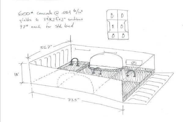

    This is a rough sketch of my idea. I want something that keeps my bed tidy and does not shift around. I saw it done without the bedliner but I think the latter step will give it a nice finishing touch.

    My concept:
    1. Cover the bottom and sides of the bed with a thick plastic drop cloth.
    2. Partition the bed into 6 rectangles with luan or thin plywood.
    3. Distribute 200-400lb of concrete equally in sections.
    4. Suspend 6 rope lift handles with knotted and washered ends into drying concrete.
    5. Coat tops of concrete sections with roll -on rubberized, textured bedliner.
    I will also be replacing the AT20s with studded snows on my OE wheels.

    I like that idea, too! Thanks for all the input. 200# makes for very thin pieces of concrete though. Maybe just make the U-shaped sections over the axle and between the wheel wells?

    2" is also pretty thin, I'd be tempted to do some wire mesh.

    The slabs I bought to park my Ninja on were 24 X 24 X 2 and felt pretty sturdy. This was also roughly the thickness of the ones I saw in the 1st Gen Taco. I figure they will not be subjected to a lot of bending but rather pressure. Hopefully a rubberized coating will protect them from impacts.

    I'm just thinking that having holes in it for the handles is going to put some bending stress on there when you carry them. Wire mesh is cheap, easy and will hold the blocks together if they do crack.
