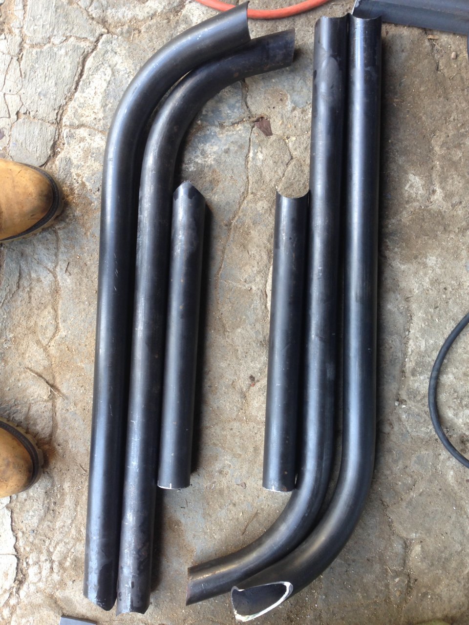

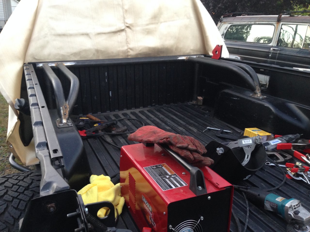

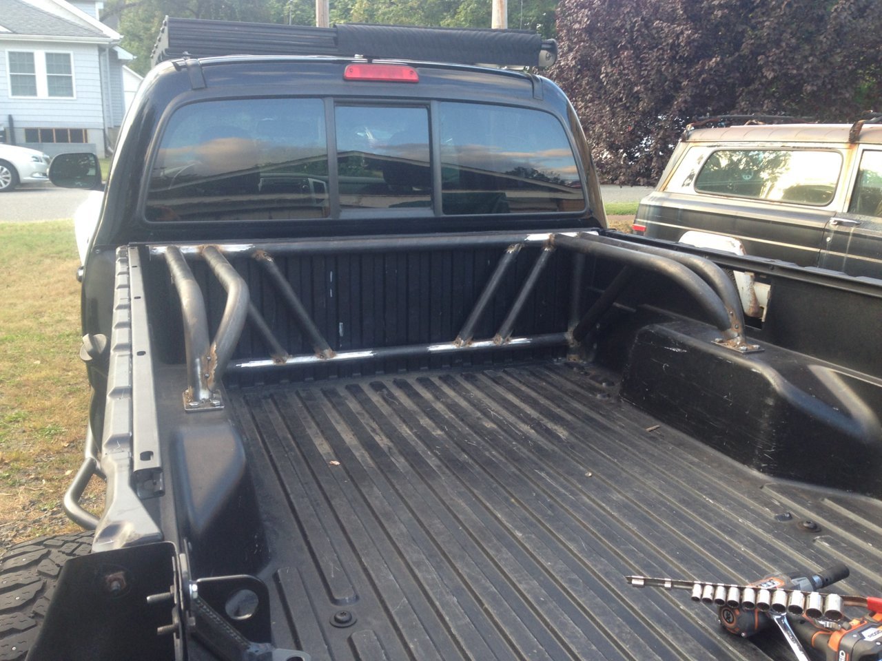

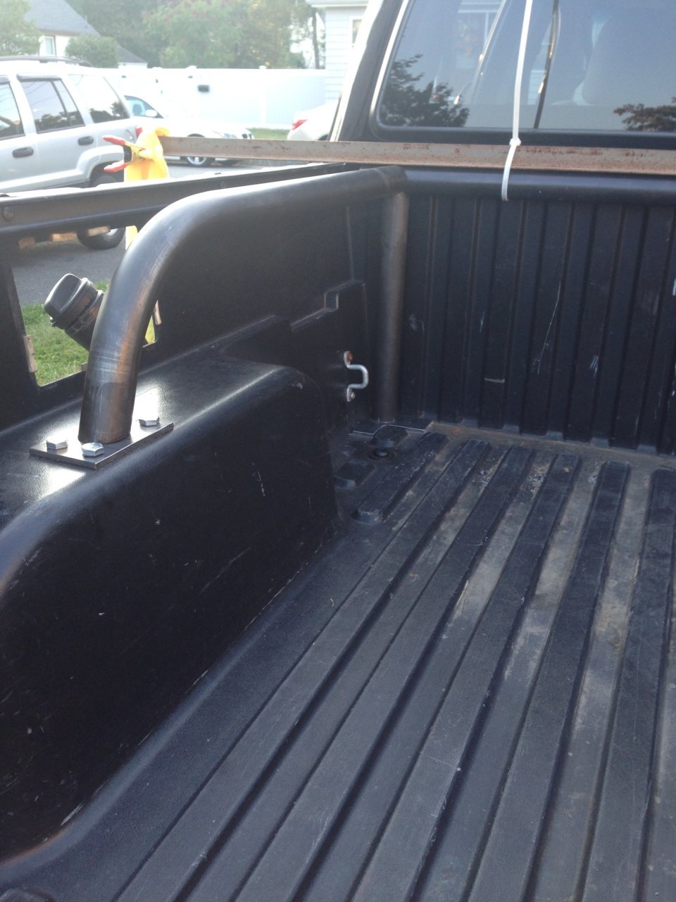

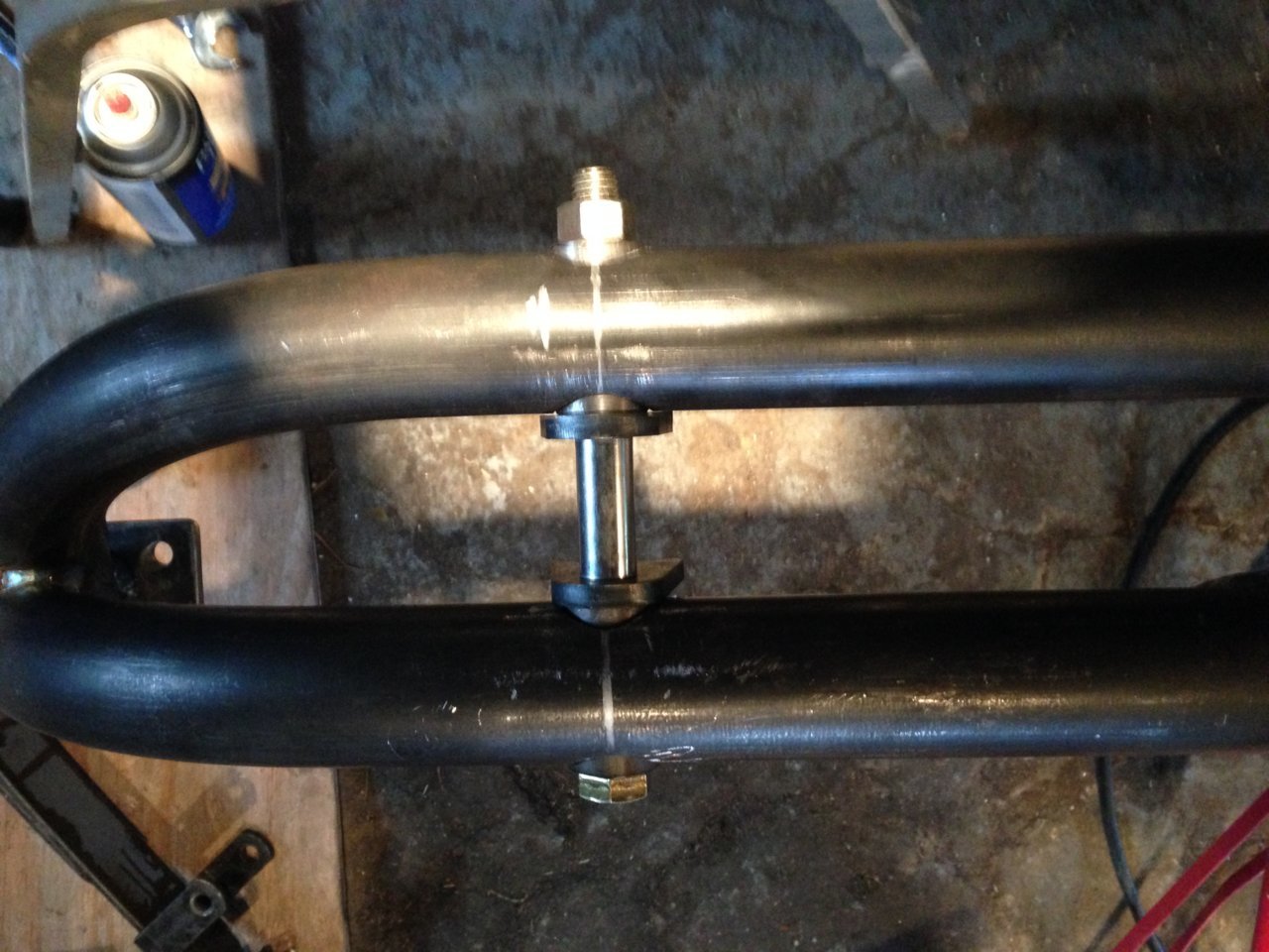

    For whatever it’s worth, I was determined to make my own cage and did a tremendous amount of reading on this sight and others, and lots of photo espionage of different builds, especially DMZ. Not lots of examples to go off of in Jersey.
    It was a decent investment in tools and equipment beyond what I already had (which was substantial to begin with), but every time I take something like this on, the money I save in labor goes into tools I’ll likely have forever and I’ll keep finding new things to get into. I learned a lot doing this project.
    The cage I worked on a little everyday for a week in the driveway and took everything apart and put it back together like a puzzle each time.
    The DMZ and frame boxing took lots of work and was a decent undertaking unto itself. I just planned and wrote everything down in steps and figured out all the material I needed ahead of time. Made friends with everyone at the local Fastenal I was there so much.

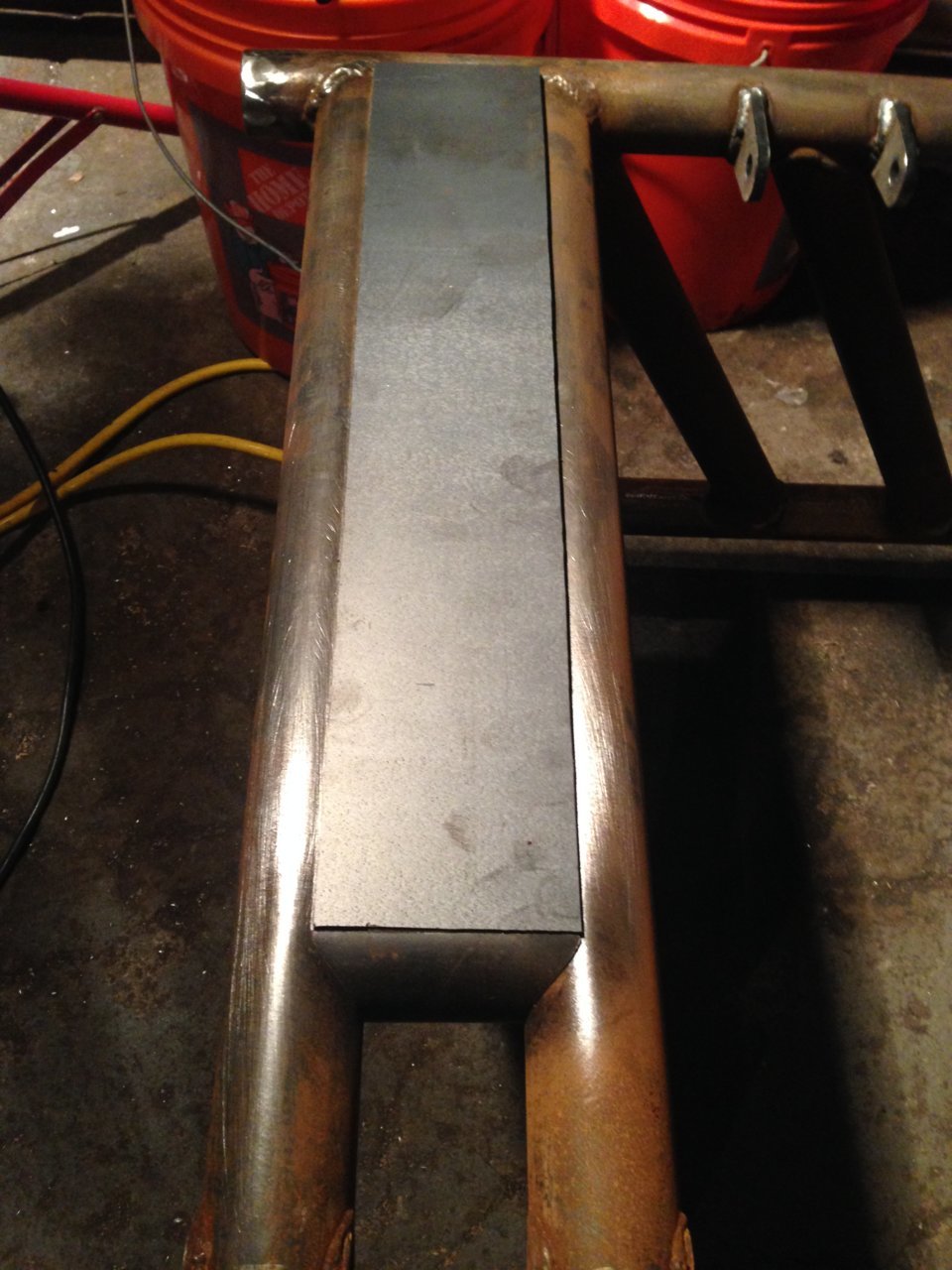

    Started with the sandwich plates.
    Used angle as falsework
    Tacked it all with flux core and brought it inside for gas MIG.

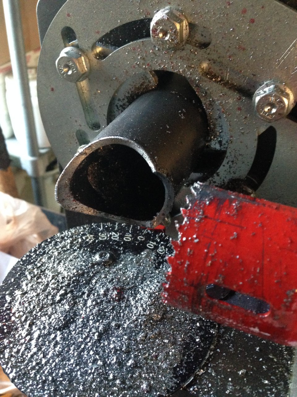

    This was a surprising pain in the ass. Burned out my cordless, broke all my 1” hole saws and busted out the Milwaukee wrist breaker to get these bungs in.2F987502-4D7F-4AB1-B1C1-CE0309600F0D.jpg
    An afterthought when @ARCHIVE saw my progress and thought it needed tightening up.
    Back from powder

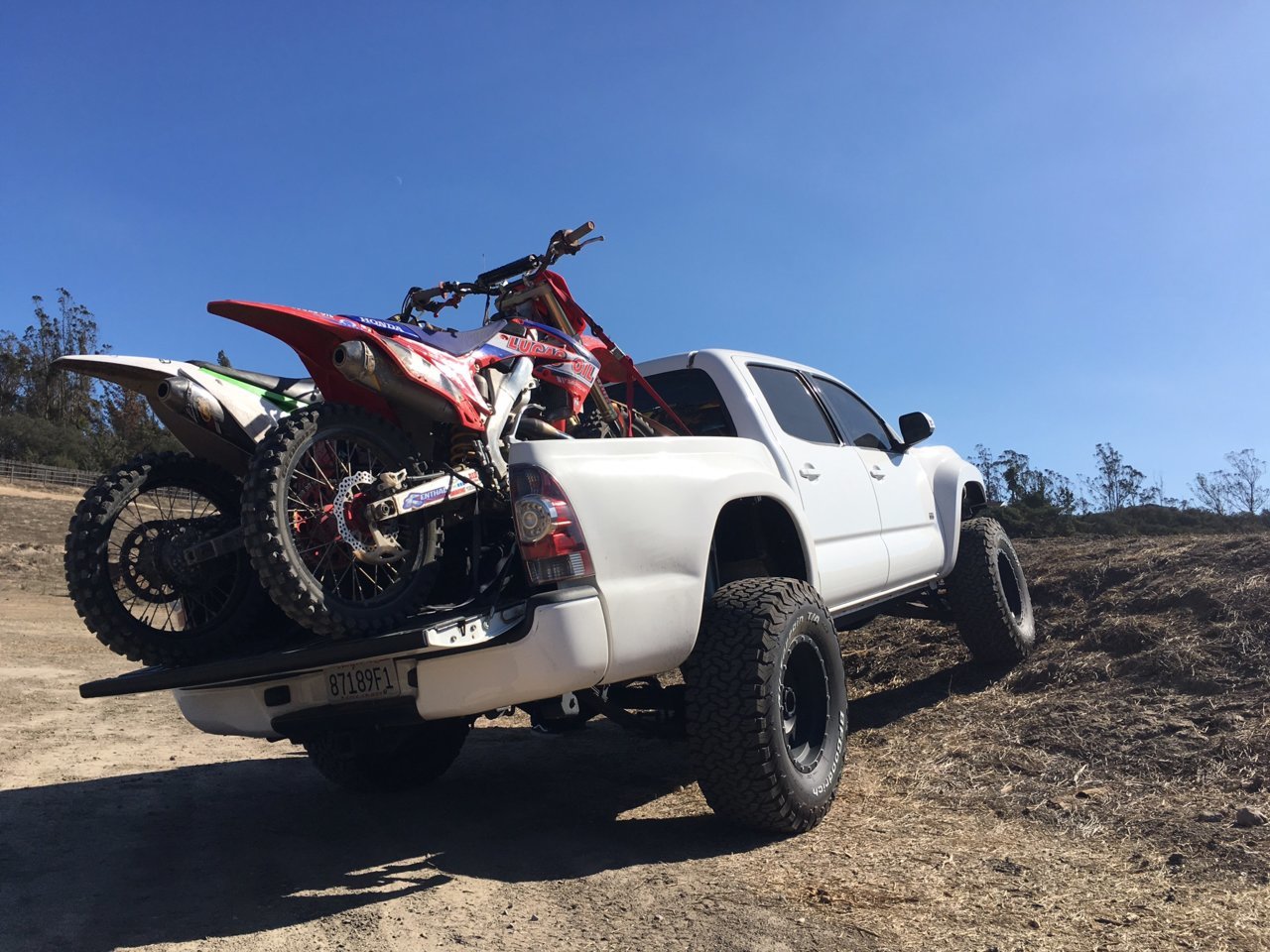

    I didn’t make mine, but it was very simple which is what I suggest. Bolts in to factory bed bolts. And only needed two 4”x4” holes to clear the shock tops.
    Still could carry 2 bikes and gear.

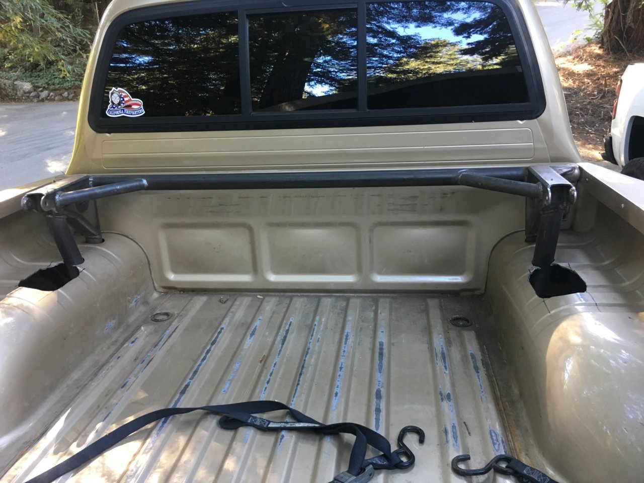

    Wish I had the fabrication skills to build some of the ones I’ve seen on this thread...had SOLO build a simple bed saver cage.

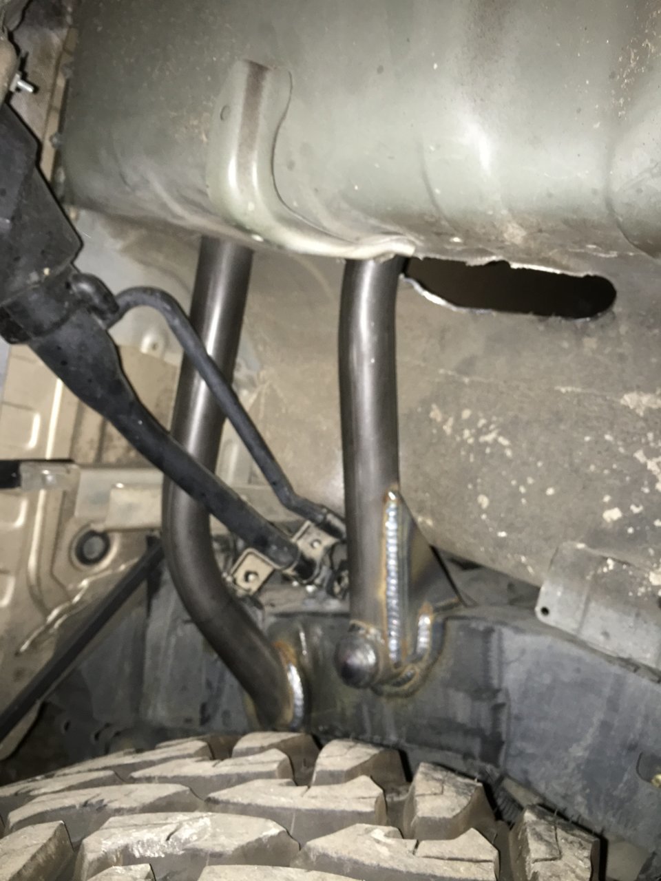

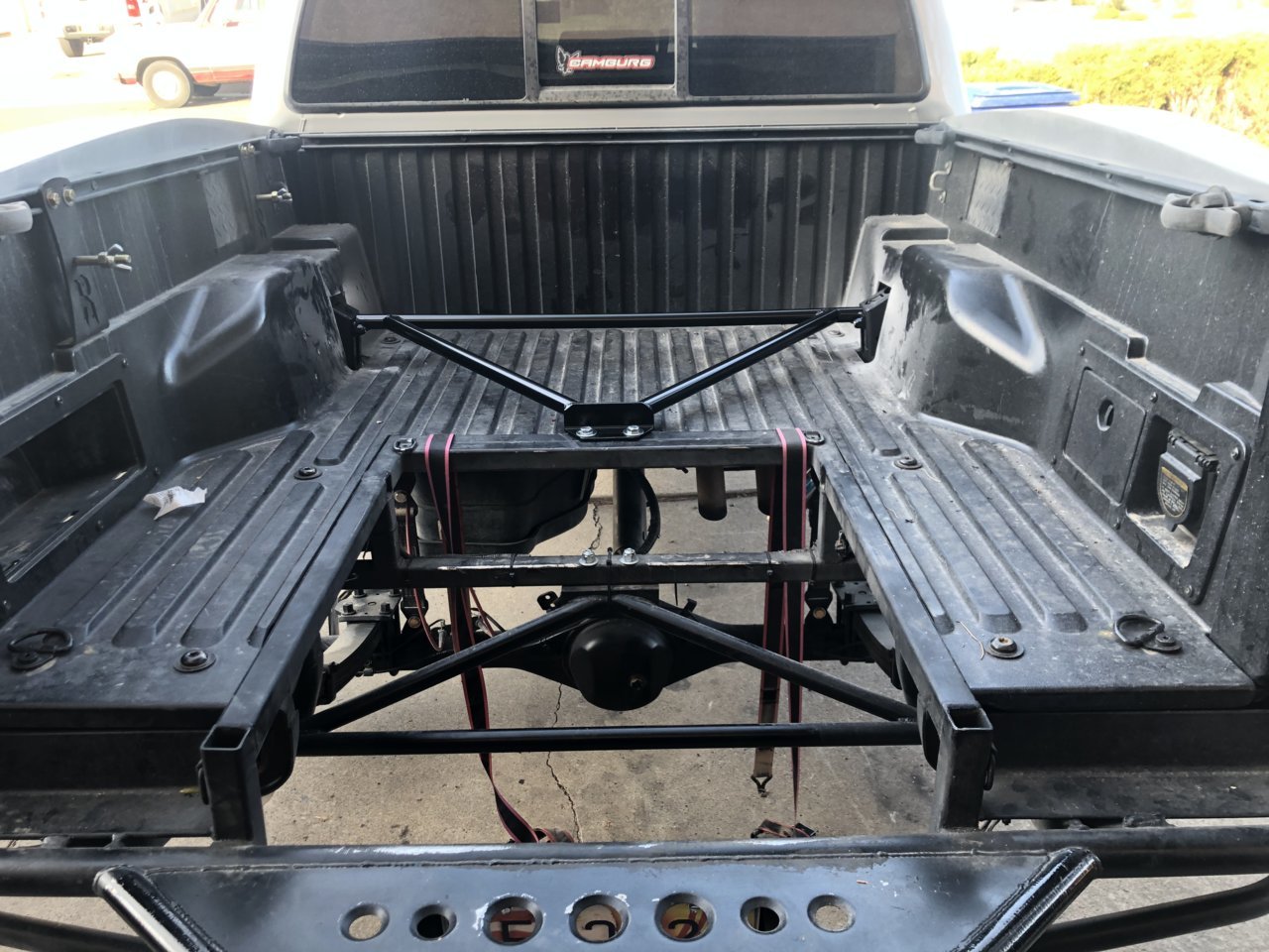

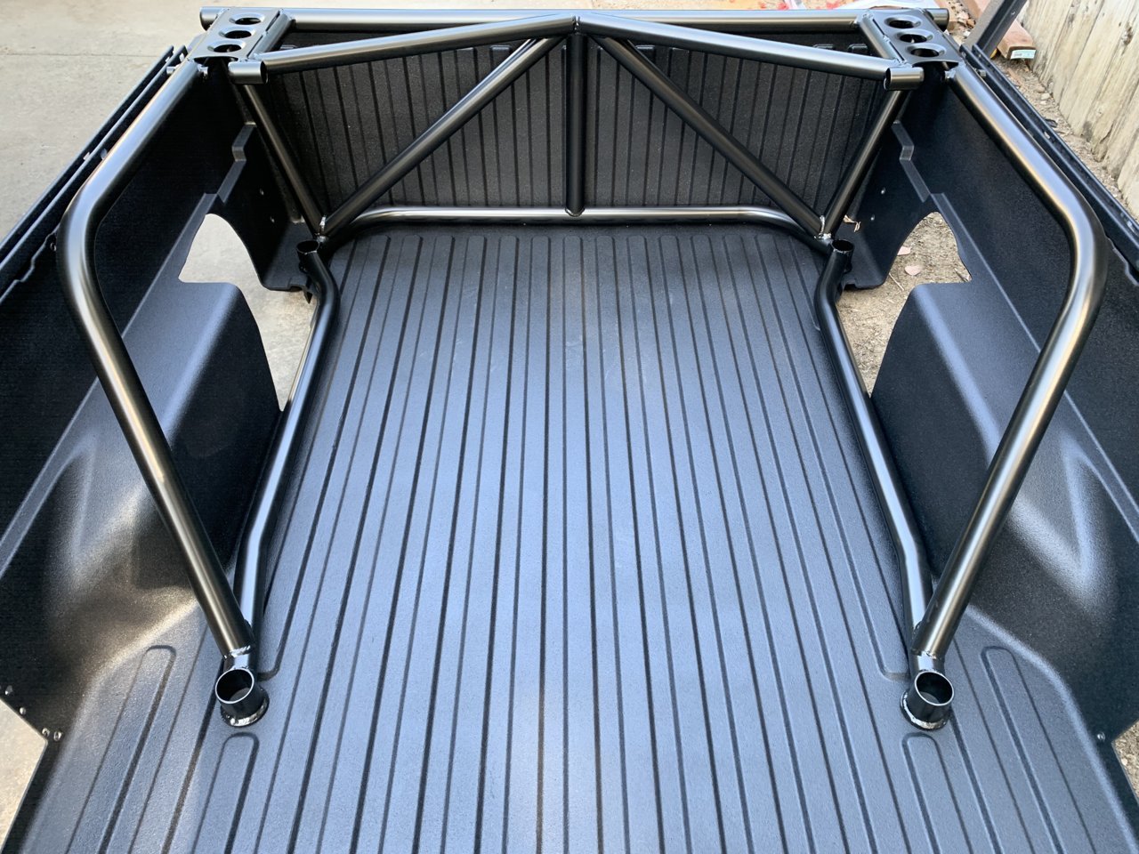

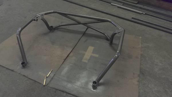

    Pretty much a copy of how DMZ does their bed cage, I build this from scratch for my DMZ kit.

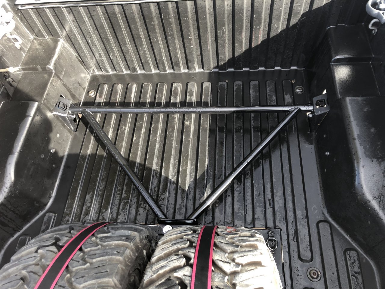

    Not a cage... but a brace in my daily.

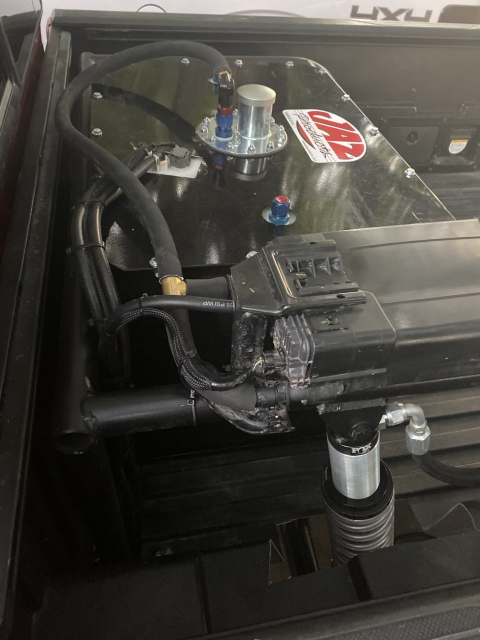

    Simple bed cage for the coil overs, fuel cell mount and ugly evap.
