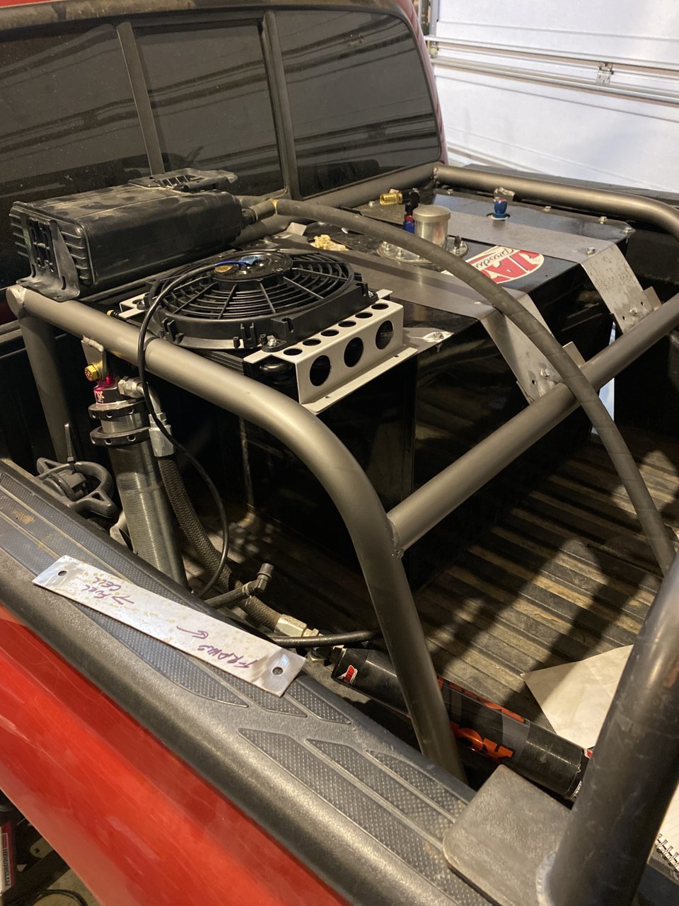

    slight update and redesign. Added trans cooler, new fuel cell mounts, slid the fuel cell over to the right to fit the battery below the trans cooler and made it taller to get more up travel.

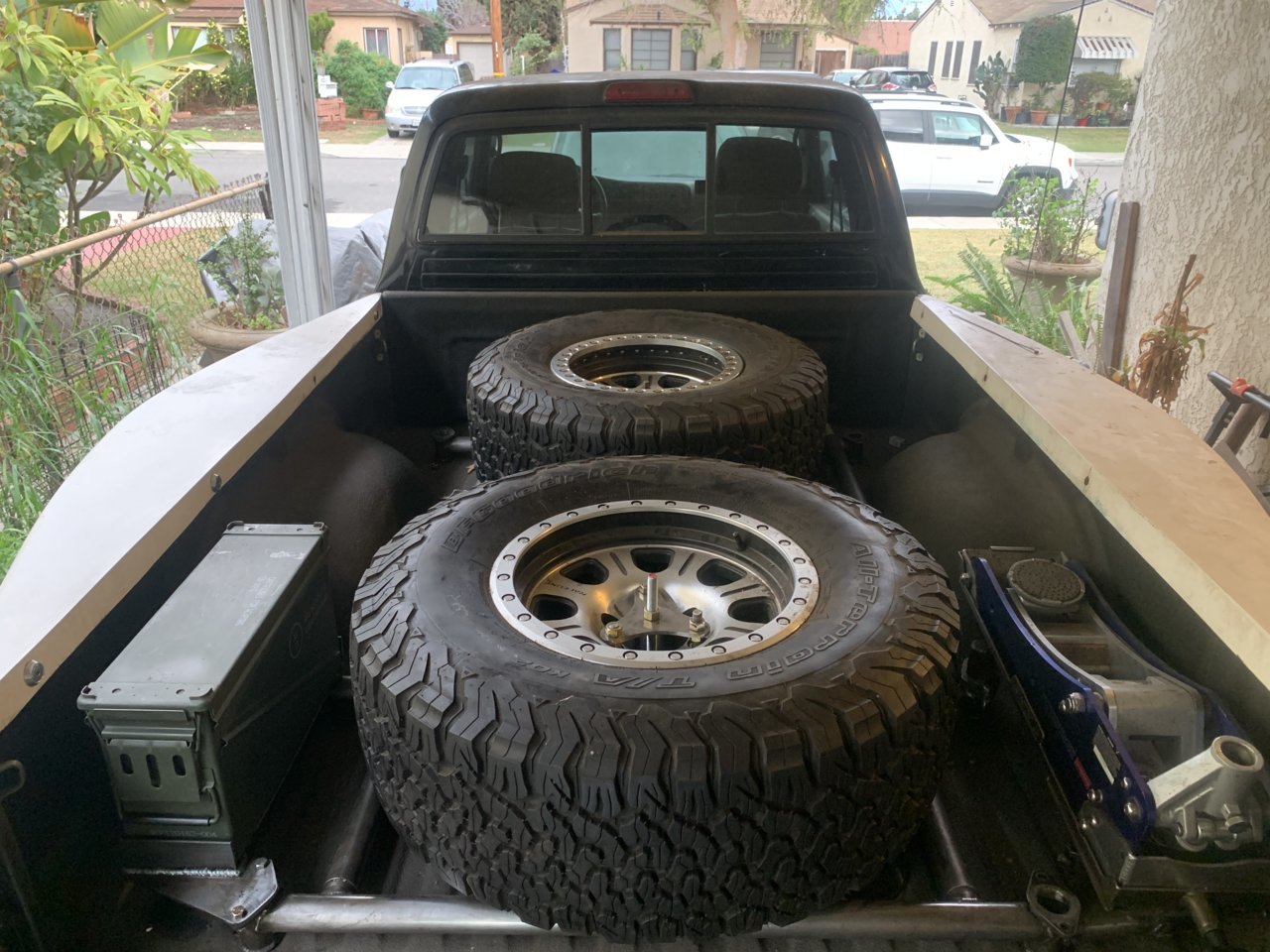

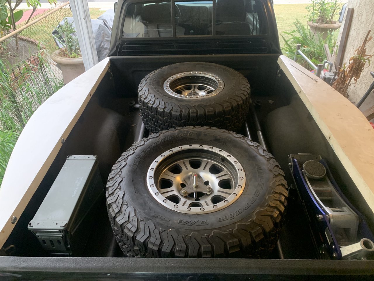

    Nice - what model / ammunition type ammo cans are those? One on the passenger side appears to be a 40 mm 32 round ammo can?

    Both boxes are identical, I can’t remember the number anymore but they are the largest ones that I could find

    i got them at a local army surplus n stripped and painted them

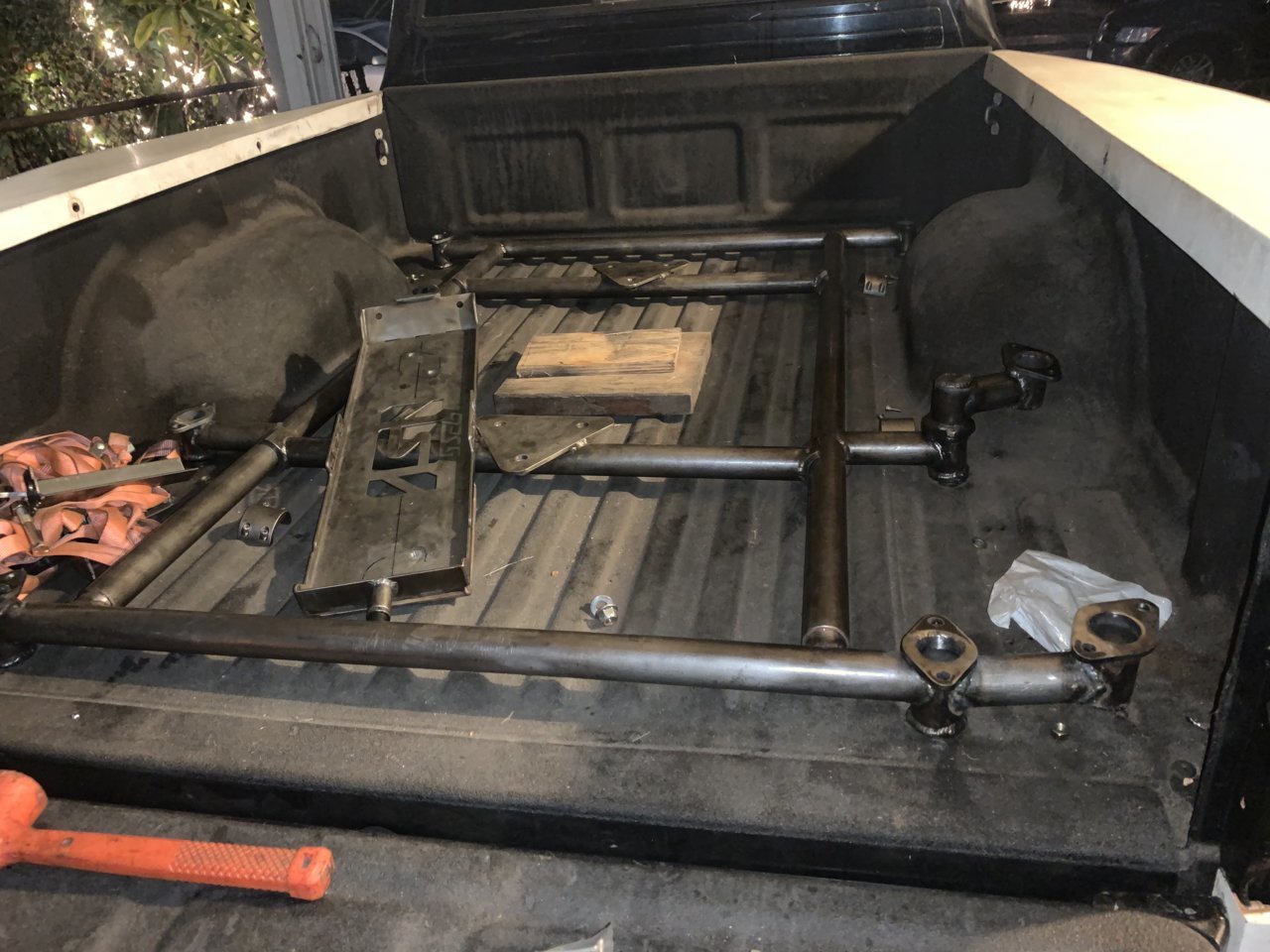

    Well finished mounting spares, jack, and tool box. Everything’s floating over the bed and goes all the way to the frame bolting to the stock mounts. @Anthony250 and I came up with the design - he had the smart idea of making the fore and aft tubes sliding into smaller tubes at the front and back. That way this whole thing breaks down and fits in about a big golf club bag size box. I added the jack and tool box mounts after he put together the main cage.
    Can run double stacked or just one spare and mount a pelican case or big cooler on the other spare mount and they all can slide into wherever you like.
    Fits 2 35’s.
