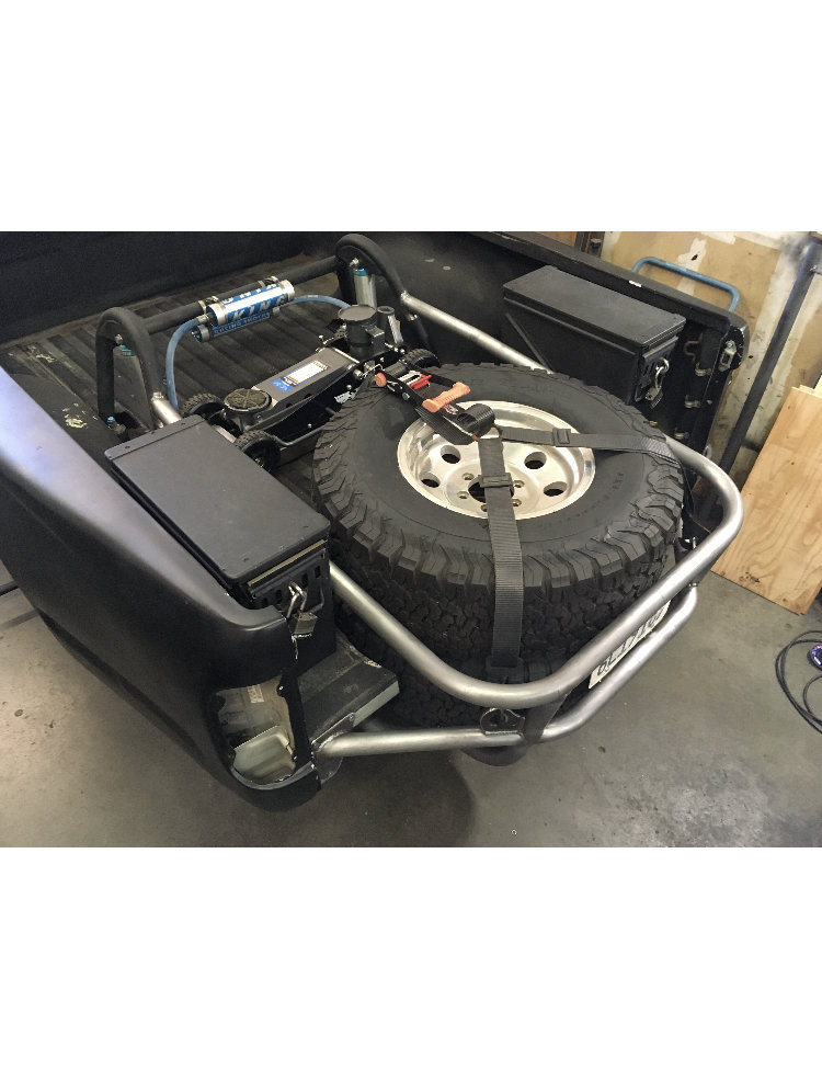

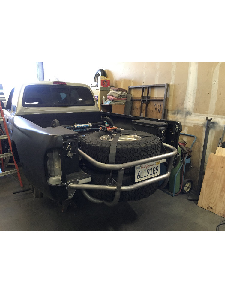

    Nice work but I have to ask. Why stack the tires? When you get the first flat will you take both spares out and put the flat one on the bottom? I think having them vertical seems to be more efficient. Then the place of the jack seems a little awkward to access.

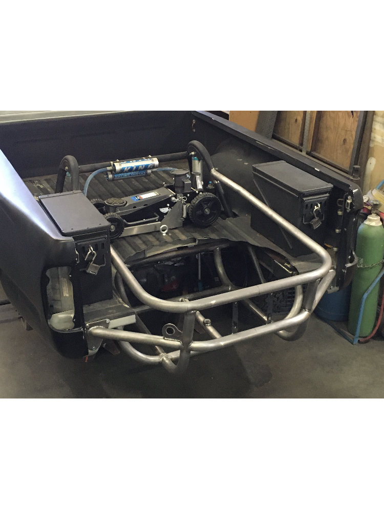

    When built right, bolt in cages are more than strong enough. This is a truck that had a newer cage made by the same installer to make more room in his bed - it was on his story but it’s not there anymore. Here’s his old one.
    AE12B477-DCCC-4962-ACF2-DDA38E2CFF8A.png 0BCD0160-6E44-48ED-946B-61421A7494CF.png
    I see you have a 2nd Gen - it’s even easier than a 1st Gen since the bed bolts can be used. DMZ, Dirt King, and Camburg all make bolt in cages for short beds - DMZ makes them specifically for long beds too. I’d stay away from the other two if you have a long bed since they take up way too much space in the bed imo.
