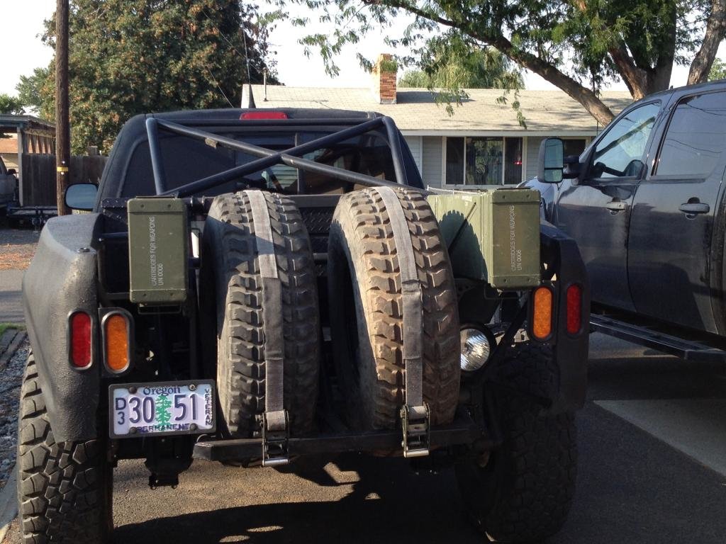

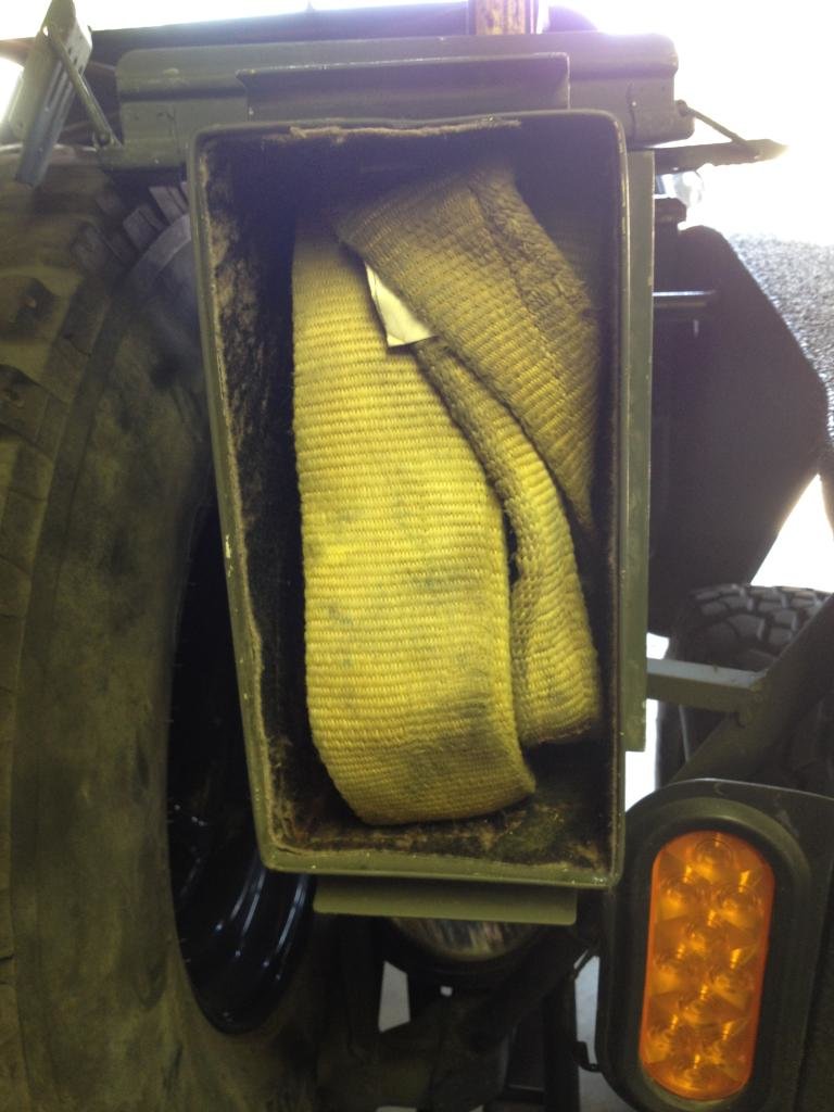

    I also have 18's at 1:1. It really works well, and the best part is the shocks don't get hot and seem to last forever. Mine are 3.0's too...which means more oil volume. It just cuts down on maintenance. The bad thing is it fucks your bed space and you end up welding all kinds of shit to it to fit your junk back there. :D
    77F2D9CE-C1EB-4248-B6D4-C663EF1908AE_zps_163b05154a220842cc216e1960a16b0c521943ec.jpg
    BE7A2CFA-1510-4ADB-B0F8-C51F1D0B71A1_zps_5828f295a1d0a91d35dd4fffa0754b99bf314f05.jpg
    Crammed full of tools, jumper cables, and recovery gear. I'll weld hasps to them and get locks at some point. Or not, I don't live in Barstow anymore.

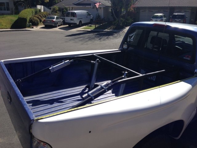

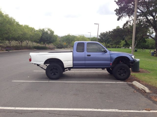

    Heres mine, kind of a simple-rush job since its my daily. I still wanna rework it, remove the crossbrace, add a spare mount etc. My main things were to maximize bed space and utility factor, and a low profile. I can still fit a dirtbike, mtn bikes, camping gear, 8' dinghy etc with it, and the tailgate remains functional too.
