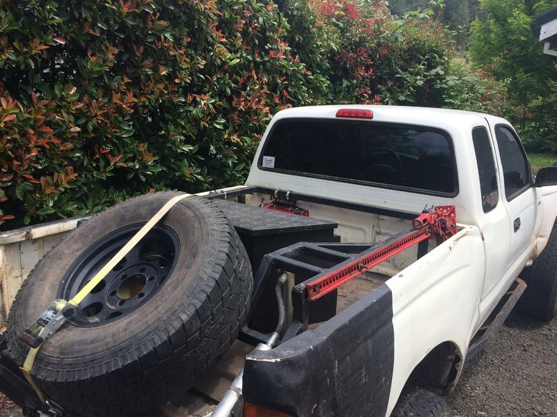

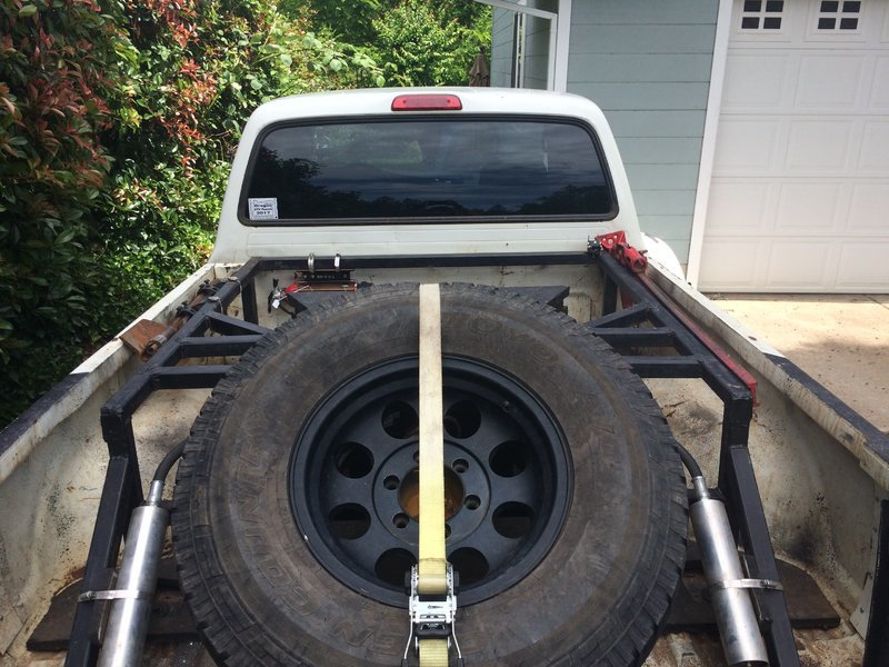

    Square tube bedcage I made holding 2.5 16" resis at a 1:1. I like the square it's a little different

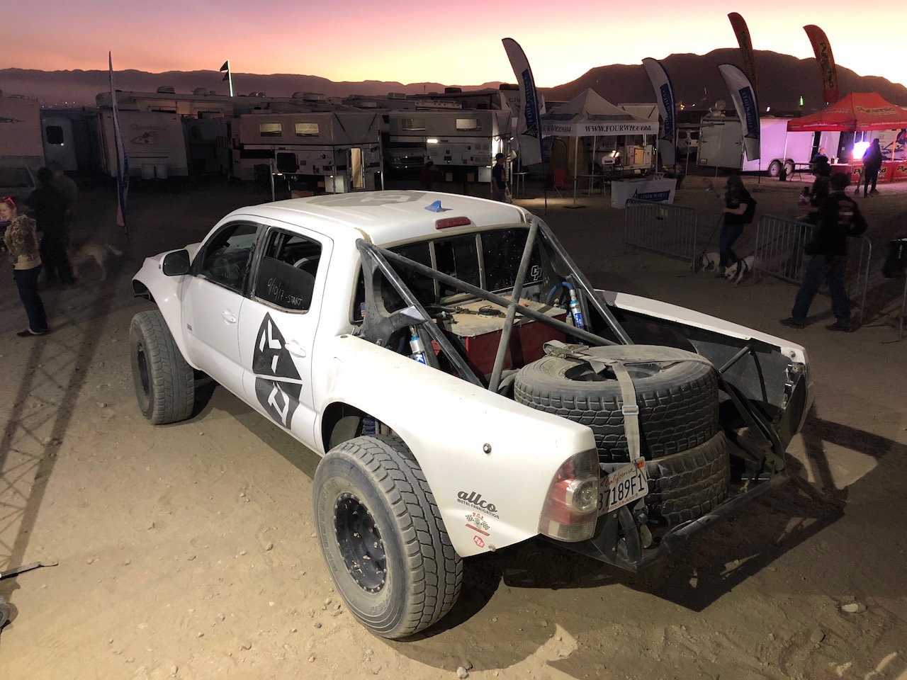

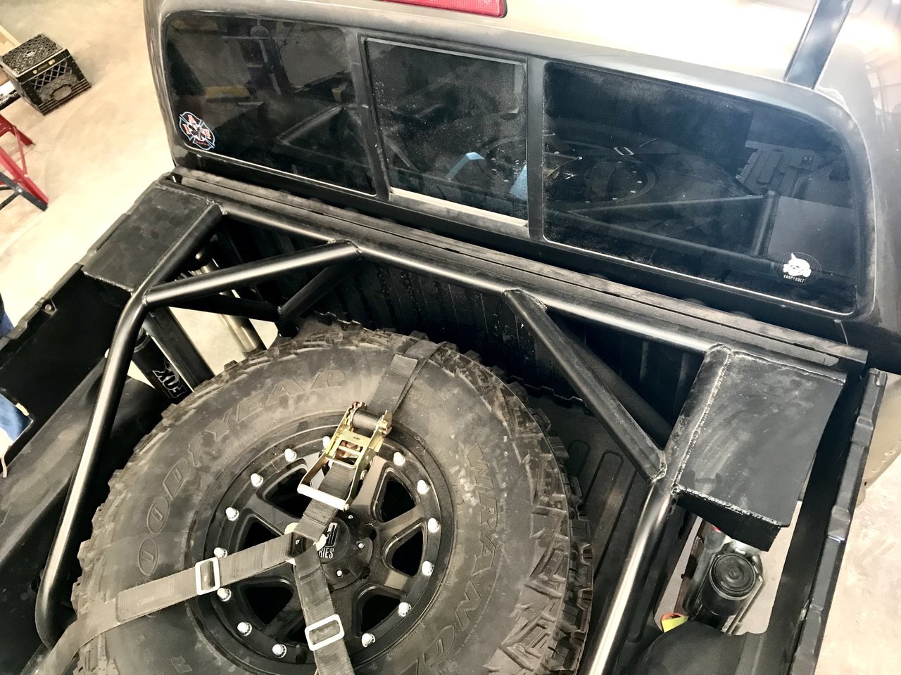

    Here’s mine

    Four linking my truck on Tuesday, and I still haven't decided if I want to keep my bed or not. Was considering doing a setup similar to @89ztrain, but removing the composite bed and welding in a lightweight platform behind the wheel to sit/strap stuff on. I have McNeil 4" bedsides on the way, so I'd be adding some mounting locations in. The main reason for wanting to remove it is because I'm welding in the bed cage, and I don't want to fight with cutting the composite out down the road if I ever need to do any rust prevention or access the frame for repairs. I'm putting the fuel cell under the spare with a battery box beside it and plating the frame while I'm in there.
    If I remove the composite, other than getting debris/mud everywhere, what other issues should I expect?
  17. Feb 11, 2018 at 12:36 PM
    #157
    Anthony250
    Anthony250 Ex Fabricator
    Sep 29, 2010
    #44016
    3,775
    Anthony
    Rialto CA
    99 Tacoma LT Prerunner
    LSK Race Kit, King Shocks, Methods, Glassworks, Baja Designs, Built by myself.
    Not much. my bedcage is welded on and have done it to many trucks. No issues to forsee needing to take the bed off. I never have to take mine off. You can still get in from the bottom. The only thing I see is working on the fuel system but in all cases the fuel tanks are removable for service. If you really wanted with a little more work could make it bolt on using interlocking tube clamps which are super heavy duty.
