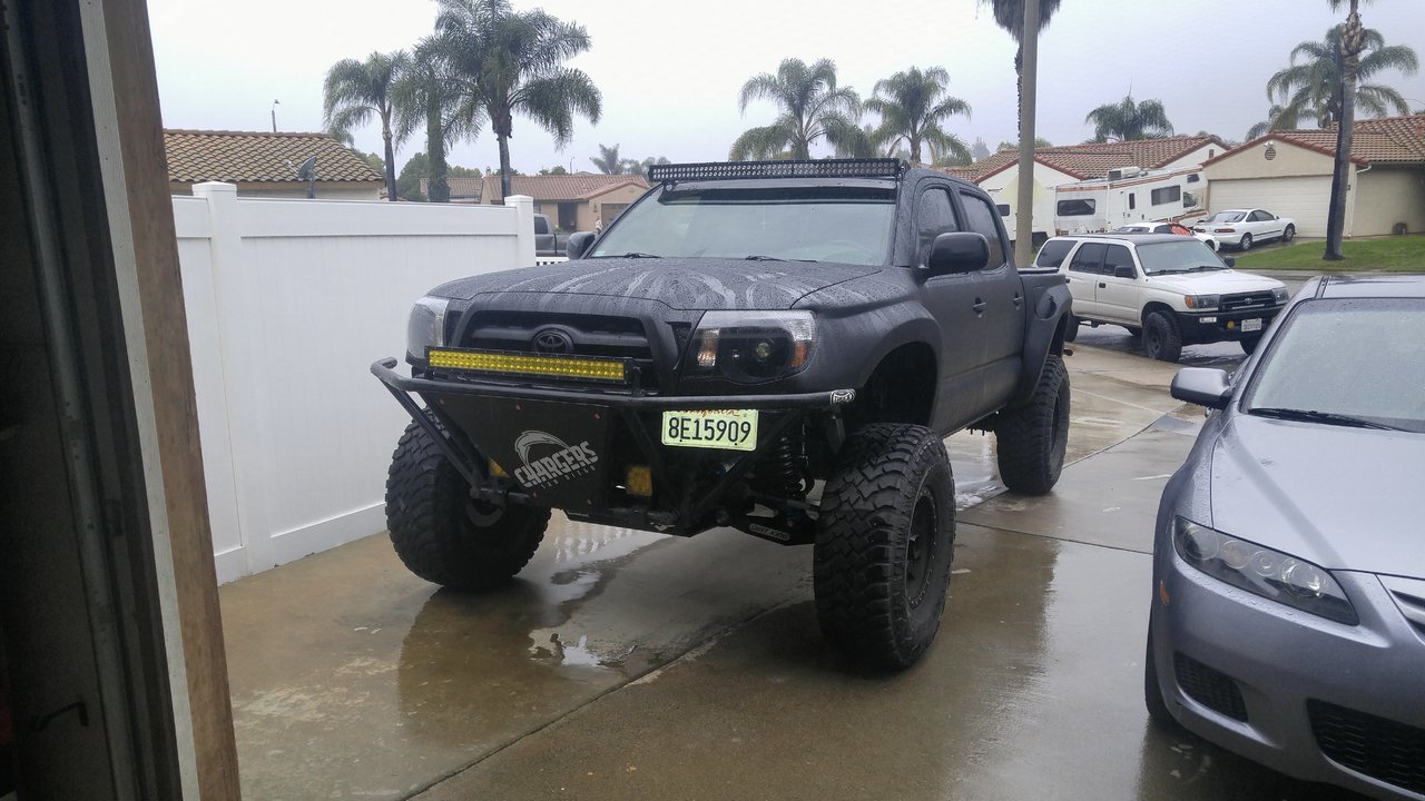

    Vehicle Modifications: TACOMA 2007 FRONT TOTAL CHAOS 5LUG ,LONG TRAVEL KIT 13" OF TRAVEL KING COIL OVER (550 POUND SPRING RATE) (18 INCH COIL) REAR BED CAGE 16" SMOOTH BODY FOX SHOCKS 2.5 2.0 / 2.5 BUMP STOPS FOX ICON ADD LEAF PACK WITH OEM SPRING 11" OF TRAVEL TRUCK COMES SPRING UNDER BY MANUFACTURE TOYOTA REGEAR TO 4.0 WITH AUBURN UNIT ENGINE 2TR-FE WITH AFE COLD AIR IN TAKE DOUG THORLEY HEADER MAGNAFLOW EXHAUST TIRE S NEW KO2 32/11.5 METHOD RIM 15" WITH -20MM OFF SET

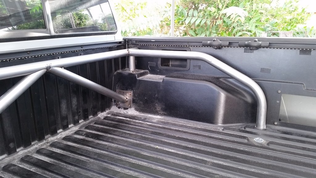

    Anyone know what it would cost to have a custom made cage? Something like this.

    https://www.tacomaworld.com/threads/airdogs-2012-prerunner-access-cab-slow-build.264263/

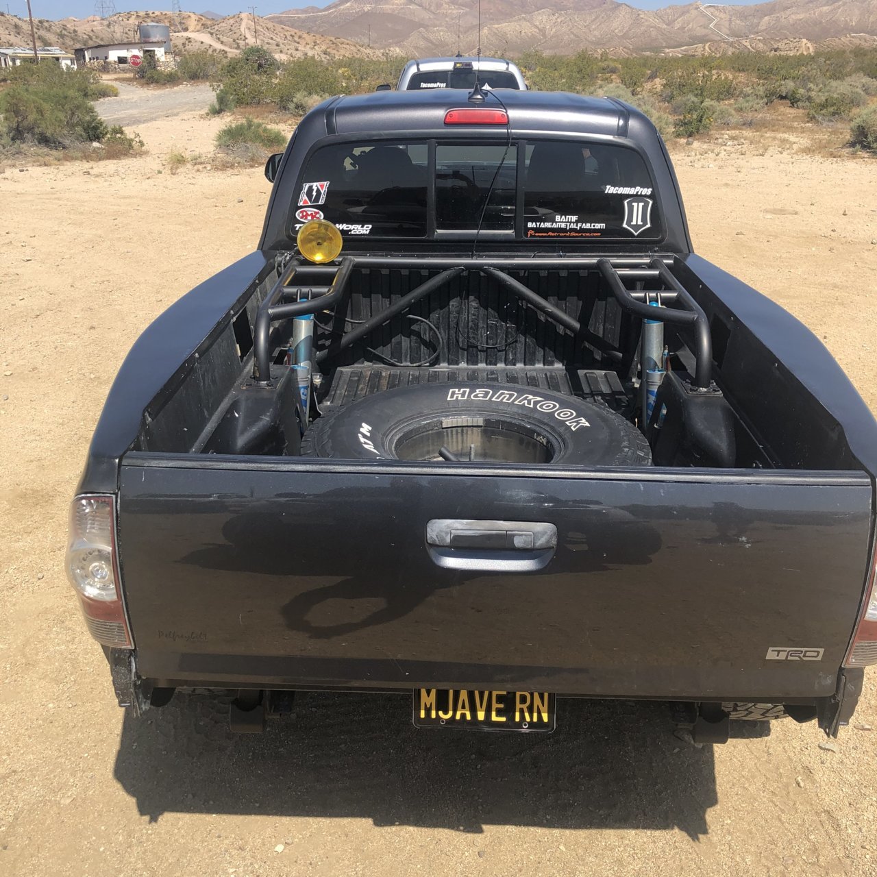

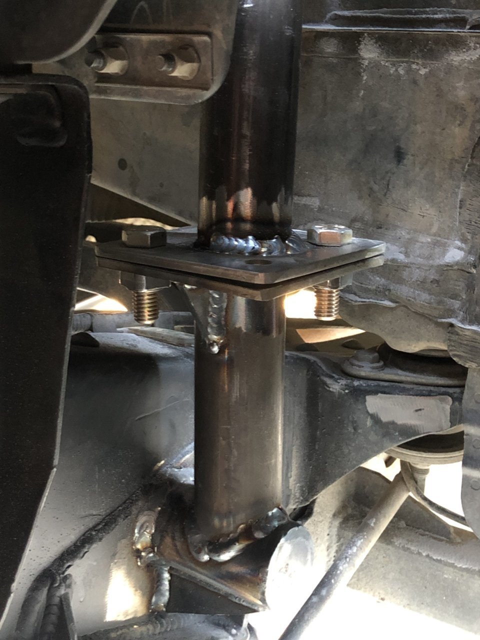

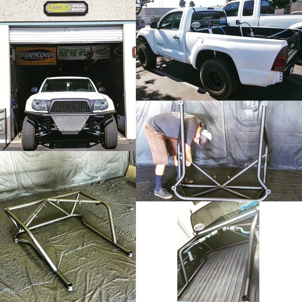

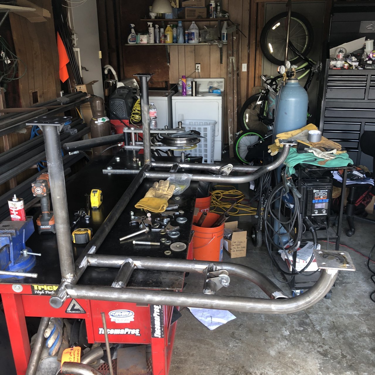

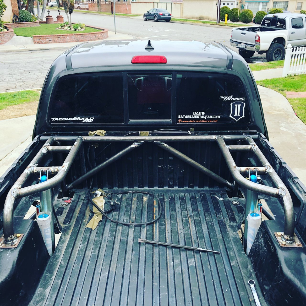

    Couple of pics of my bedcage fabbed by @Yotamac and myself.
    32831848607_78cb0f21ba_o.jpg 46733644261_b40103fd0b_o.jpg 45818136835_f23c989854_o.jpg 44746654320_79d0dce37c_o.jpg

    how much would something like that cost in parts/labor?

    What are you looking to use it for? This one obviously isn't completed, but if you don't need the shock mounts and just want some rigidity you can whip something up using Bendtech and minimal fab skill for dirt cheap. The software is only $149 and if you can use a tape measure then it'll do the rest for you. You could buy an Amazon flux core welder and a cheap tube bender for the cost of labor then build whatever you want.

    I wanted to do a 63 swap with 16” Kings.
    I don’t jump the truck, just trying to get the most flex possible. 14s would be easier to fit but depending on what the fab work would cost I would do 16s.
