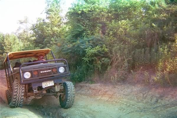

    I think herculiner only comes in black and white, if you want color choice do a search for Durabak. Prep was sand with 40 grit, clean up with the cleaner they suggest and paint with roller they sold with kit. I did a samurai inside and out back in 2000 with Durabak-- goodstuff. Mine was forest green in color, after about 2 months it lost the shine and turned flat, which was what I wanted. to keep the shine, you were suppose to use a floor cleaner, from what I remember.
    This pic was about a yr after I put the durabak on, body in green and cage/bumpers in black
