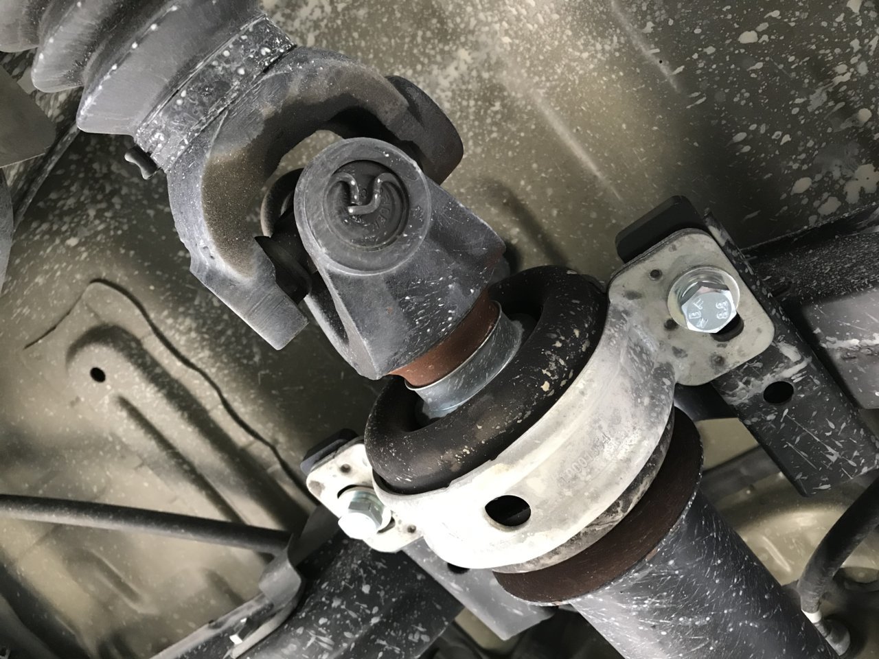

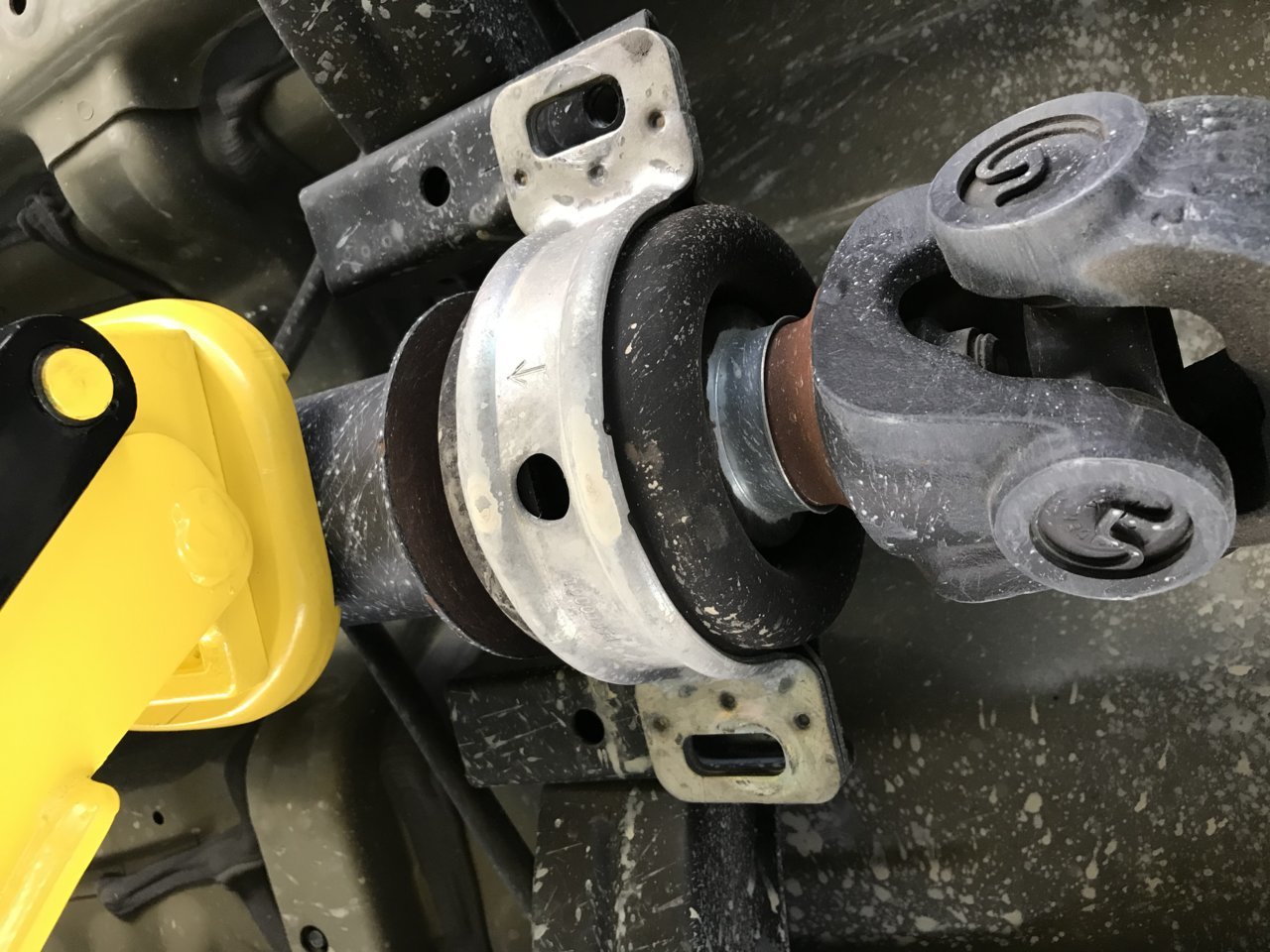

    Carrier bearing drop installed. Took five minutes and I think I’m getting more vibes as a result? Maybe it’s a Jedi mind trick

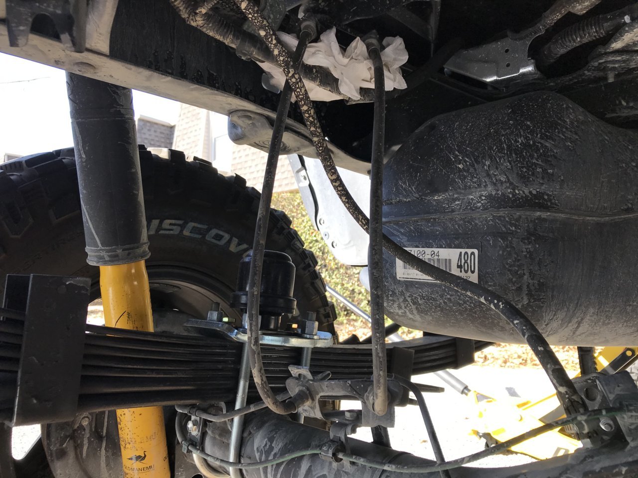

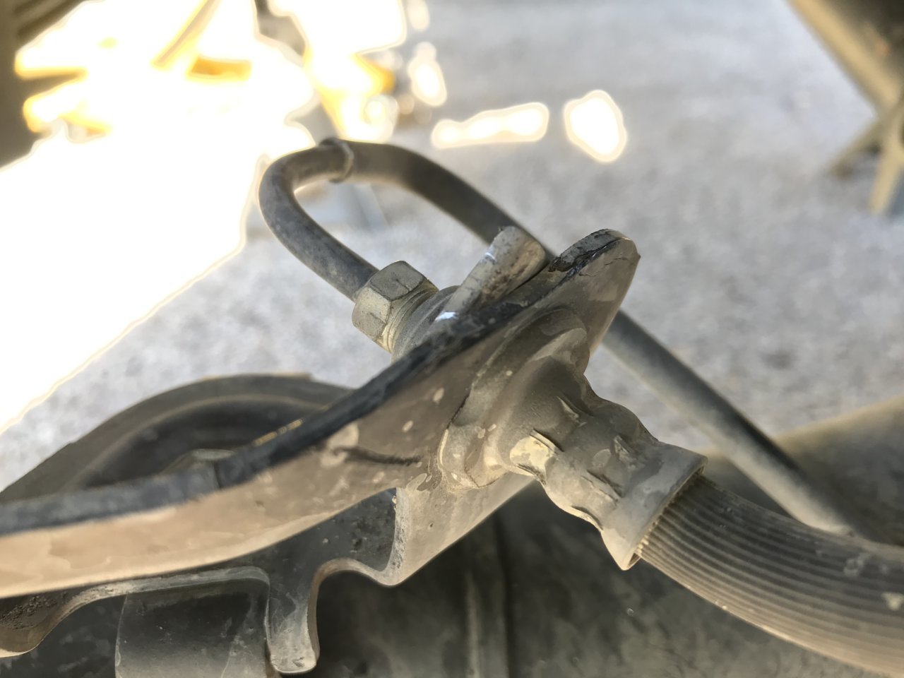

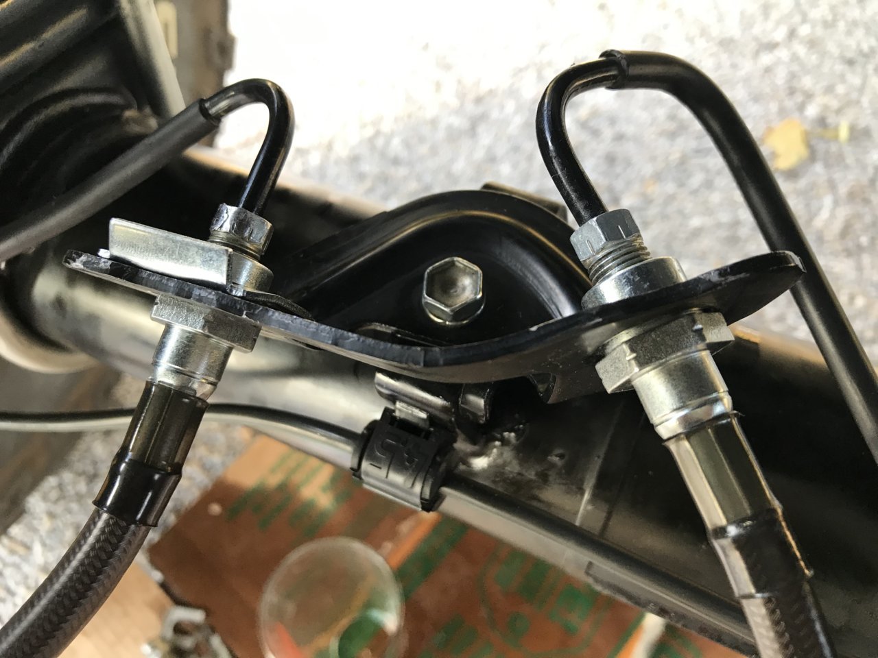

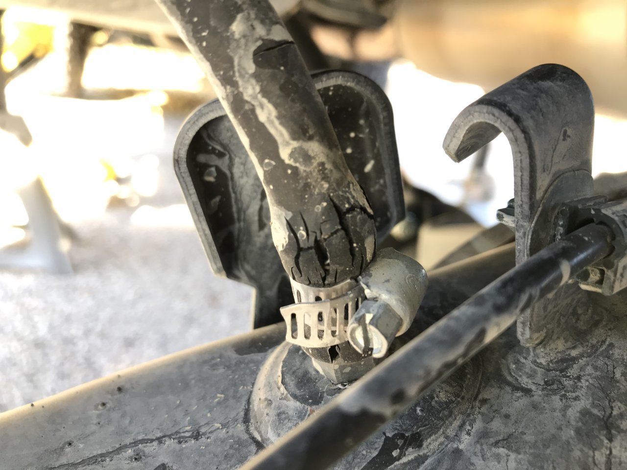

    Extended Brake Line Install
    I’ve been meaning to do this for awhile and since getting my HD Dakars, it’s definitely time. A few things to note:
    1. Make sure you have PB Blaster.
    2. Buy a 10 mm flare wrench
    3. You’ll need least 32 oz. of DOT 3 brake fluid to flush the system, which you should
    4. Buy some line caps
    Use your PB Blaster to loosen all of the nuts. The first few I loosened at the top didn’t need it, which is why I ran into a problem. The bottom ones were locked up and I ran out of penetrating oil. I literally ran to Autozone for additional brake fluid (on top of the bottle I had), line caps, and penetrating oil.53370A08-BEC6-4052-AC08-B20D64DF0952.jpg
    Loosen and retighten the line nuts BEFORE removing the tabs that hold the line in place. Ask me why. I used pliers to rotate it back and forth until it popped out. The top two suck, I know.
    Unscrew the line nuts and cap the ends. You’ll lose a few drops of brake fluid, but you’ll lose a lot less if you have the caps ready :rolleyes:
    Install the new lines in reverse order — do the bottom first. Hand tighten the line nut WITHOUT CROSS THREADING, insert the position tab with the lip out (use a hammer to tap it into place), and tighten the line nut.
    Repeat the last step for the top and proceed to bleeding the brake lines
    I saw this while I was down there. Looks I’ll be doing it again :(
