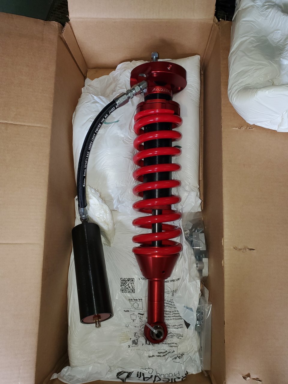

    Any pointers or recommendations for installing front reservoirs? Is the Toytec bracket a decent option? Where do I locate it? Thanks!
    Edit: 2012 T4R Limited. I’ll be using @Bigdaddy4760 ’s lift to remove the XREAS

    What reservoirs you putting in?

    These:

    Did they not come with reservoir mounts? They should have. If not, there are some weld on reservoir holders available.

    They only came with the coilovers. I purchased them off a member that won them at Jambo.

    I have some

    Sounds like maner has the spacer. For the reservoir mounts, loosely attach the reservoir to em, then find a nice spot on your frame where they would look good attached. Mark yourself a hole, then with the appropriate fastener, attach the mount.

    And you shouldn't use spacers with adjustable coilovers. Instead, adjust spring preload such that the driver side has 1/4 to 7/16 more preload than passenger.

    I figured that would mess with the articulation. TW express or shipping for the mounts?
