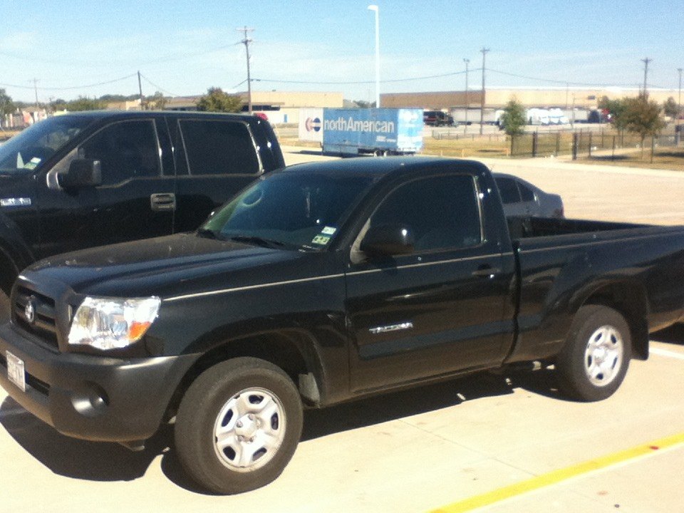

    2008 Base Standard Cab 2 Door Tacoma
    Tires: 215/70/R15
    Wheels: 15" stock
    Lights: Stock Headlights
    Factory Clear Fog Lights
    Grille Bar: None Yet
    Exhaust: Stock
    Engine: 4 cylinder
    What I have: ra7etuta_9844e3d0a8331b80c1702b7562a599e04509676f.jpg
    What I'm going for: just a meaner looking truck.
    I don't have a 4x4 or anything but I don't do off-roading I only use it for street.

    Put on a set of new wheels & tires and that'll look much better without a lift!

    Really? Because I'm not sure what size tires would fit/look good.

    Be warned...this site will make you spend bunches of money...I had basically the same truck and only wanted tires and rims....and now I have a whole lot more...
    edit.
    Also be warned that with any tires bigger than 30" you will want/need to regear. Also 32' will not fit without some sort of lift.
    check out fat bobs garage for their spacer

    What would be the biggest size that doesn't look weird but I don't need to regear?

    I would say 30s but I could be wrong, I had spacer in it when I had 30s.
    ill post a few pics.
    this was 30's with the fat bob garage 3in spacer
    whatever the stock size is is here
    these are 31"

    So 30" tires on 17" wheels with a 3" spacer lift doesn't need any regearing?

    Keep in mind your 5-lug is not geared the same as the Prerunner.
    Even though both are 2wd, if you go larger than stock, you WILL feel the power and MPG loss.
    32s would be really bad.
    Our stock tires are a little under 27".
    Largest recommended for a stock 5-lug is 235/75-15, which is about a 29" tire.
    Seriously though... I did it on my '94... went with 31's.
    It sucked. It looked badass, but I couldn't maintain highway speed on even a slight hill, and gas mileage was bad.
    If you are strictly street, just go with a 225 and a slightly aggressive tread.
