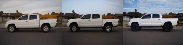

    Installed: Toytec Ultimate Lift Kit with Bilstein 5100 coil overs, Differential drop, Anti sway bar bracket relocation, Rear TSB 1.5" AAL, Rear Bilstein 5100 + shim kit. (Shims angled tall to short, back to front). Also installed Allpro Upper control arms. Still making considerations for wheels and tires maybe Pro Comp 7089 17x8 and 285 or 265 BFG AT/KO or maybe Maxxis Bighorn or ???.
    The truck handles great, no drifting or pulling.:)
    Two things:
    1) I swear my air conditioning is not as cold as before the lift.:confused::confused::confused: Especially in the footwell.
    2) What is that little shudder/vibration at 5 MPH when I'm accelerating???? :eek:
    Is this a result of the different angle of the cv joint??:confused:
    The different angle of the Universal joint??

    Never did figure out the air conditioning. I think it was my imagination cause it doesn't seem weak anymore.
    I took out the shims, (it did nothing) put em back in and never did figure out the shudder.
    I searched and searched and its really a nebulous problem and fix. Other owners have the same model, same year same lift, and no shudder.
    I just live with it. Anyhow here's the final pic in the before and after:
    I posted it up on another thread, it's worth posting up again (IMHO):rolleyes:
    Oh yeah, and since the TW driveshaft costs more in shipping than the shaft itself I passed on that idea.
