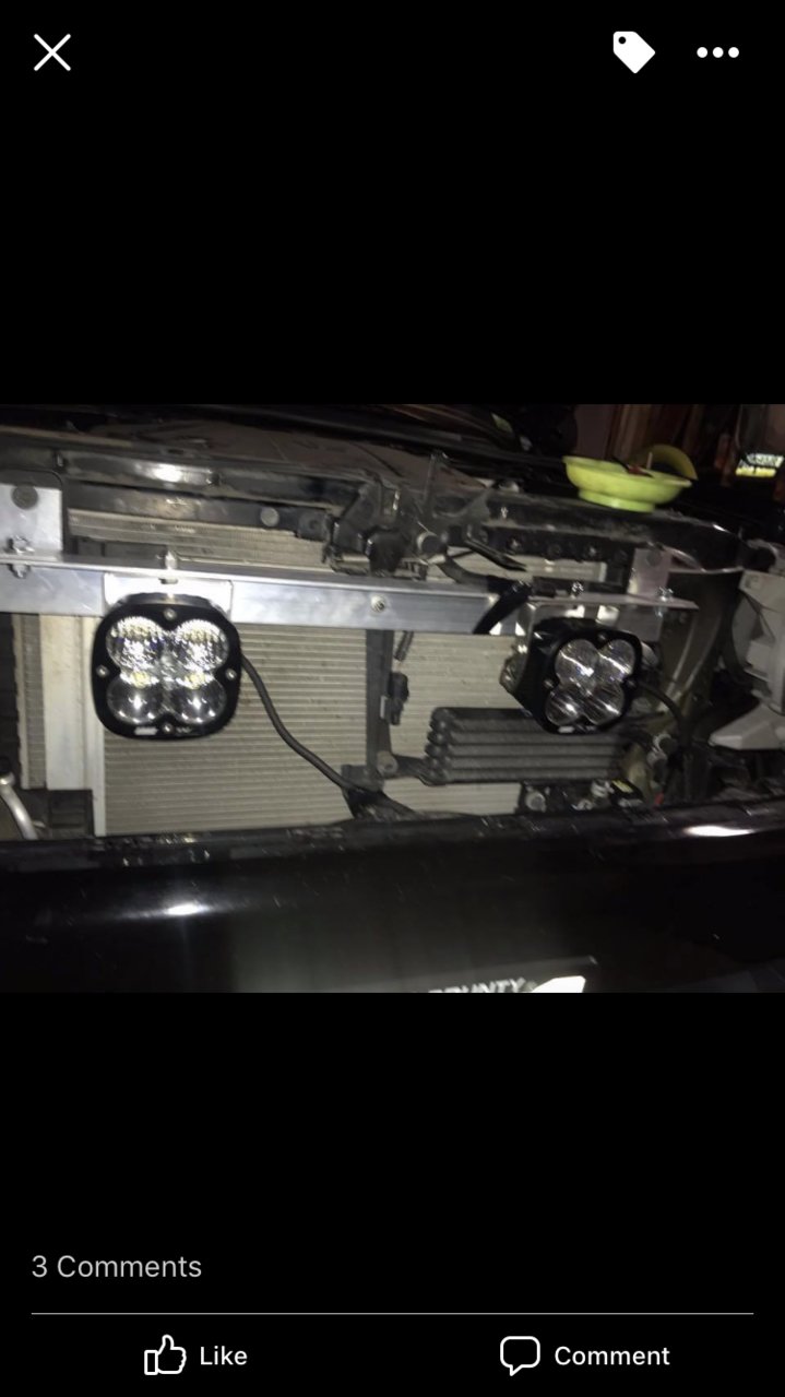

    What is everyone using for behind the grill light mount?
    I have an extra set of BD pods & would like to mount behind the grill
    *PFA*
    I saw this photo a while back somewhere

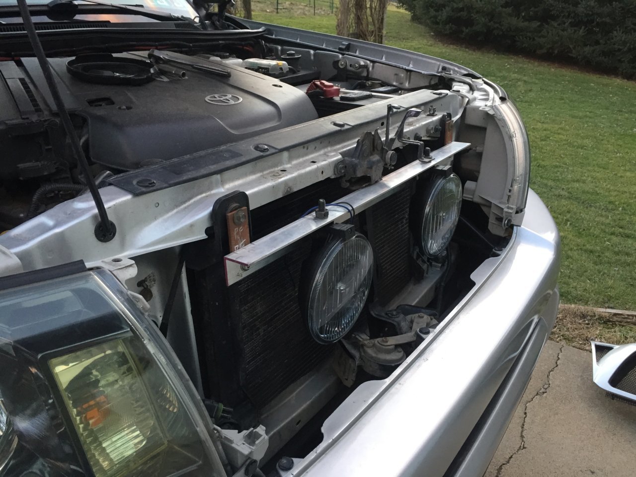

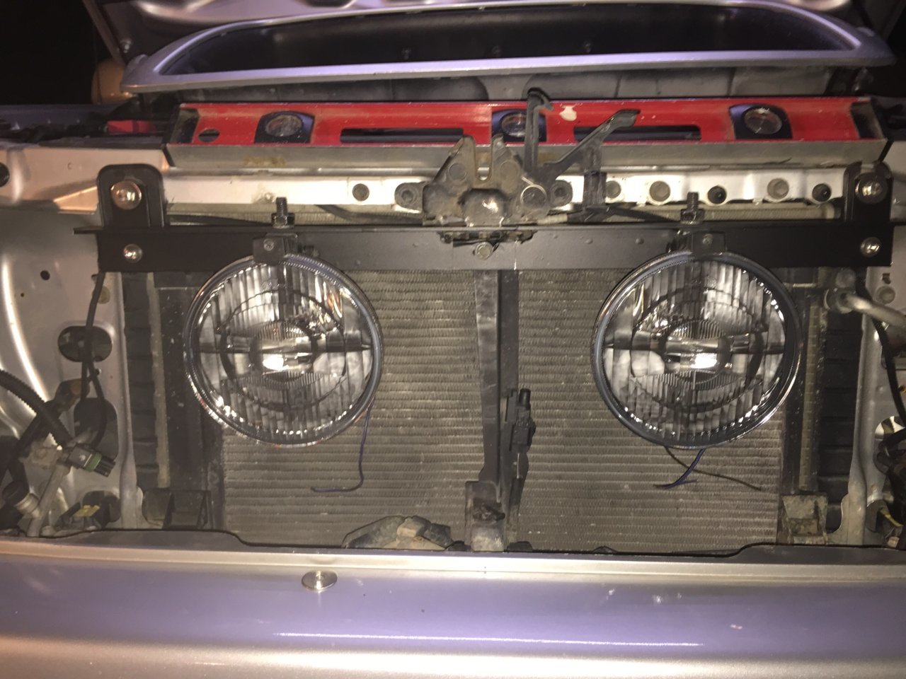

    DIY

    Got close ups on how you mounted it? I was thinking of that but seemed kinda flimsy

    I’ll see if I can find some pics. There may be some build thread.

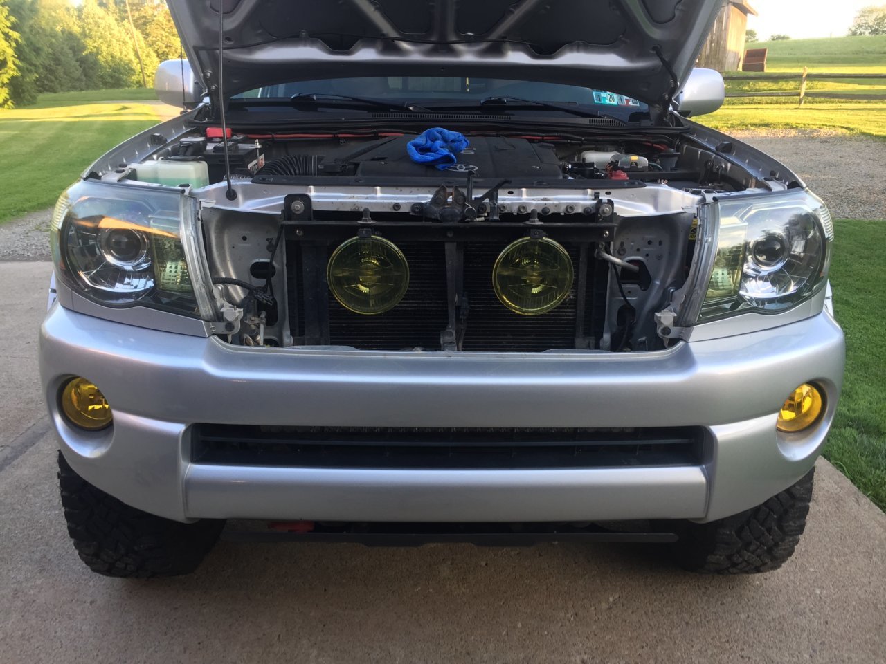

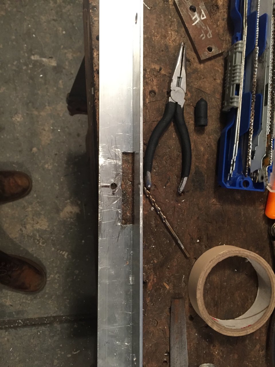

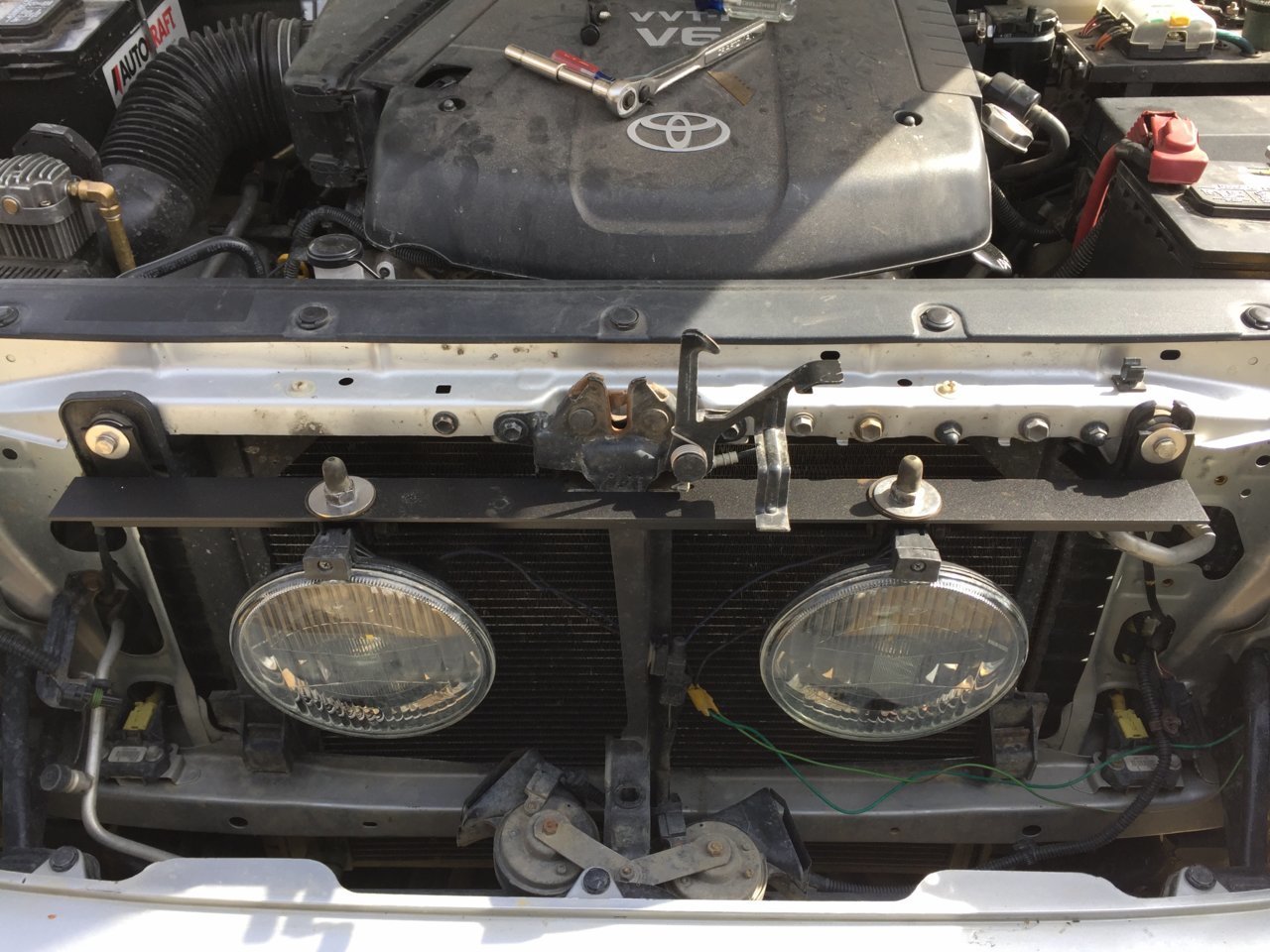

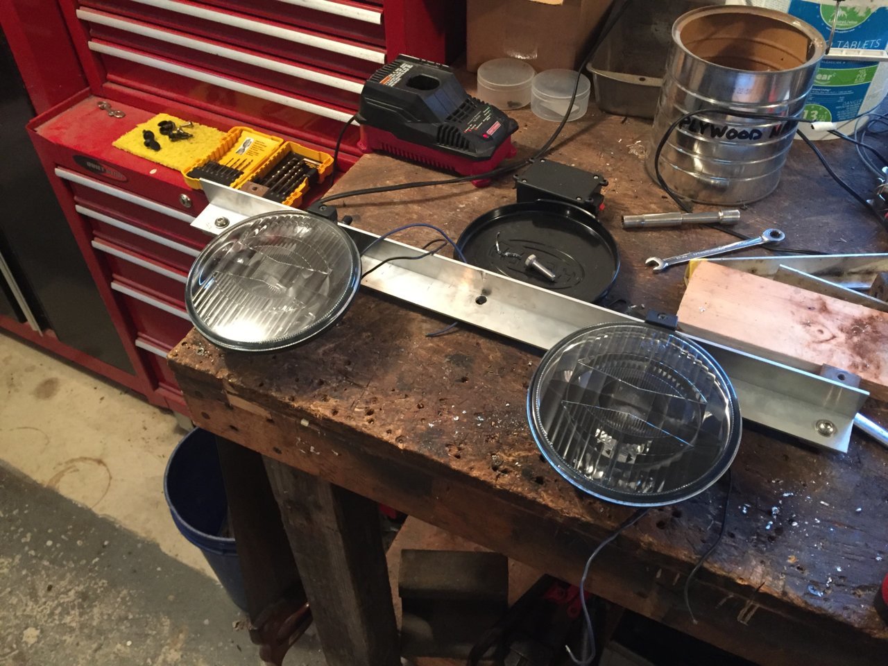

    It’s 1.5” angle aluminum. 3 mounting points using the 2 rad bolts and the center support.
    If you use angle iron/aluminum, it won’t be flimsy.

    I had some L mounts & they were flimsy, but I like the idea of having an angle bar like yours.

    Nice diy. I think people have issues with flimsy/vibration susceptible mounts because of the gauge utilized in building the mount. Yours looks solid and is substantially thicker than using a simple aluminum bracket.

    Yup.
    Using angle iron and 3 mounting points makes it as solid as can be.

    From my build thread -
