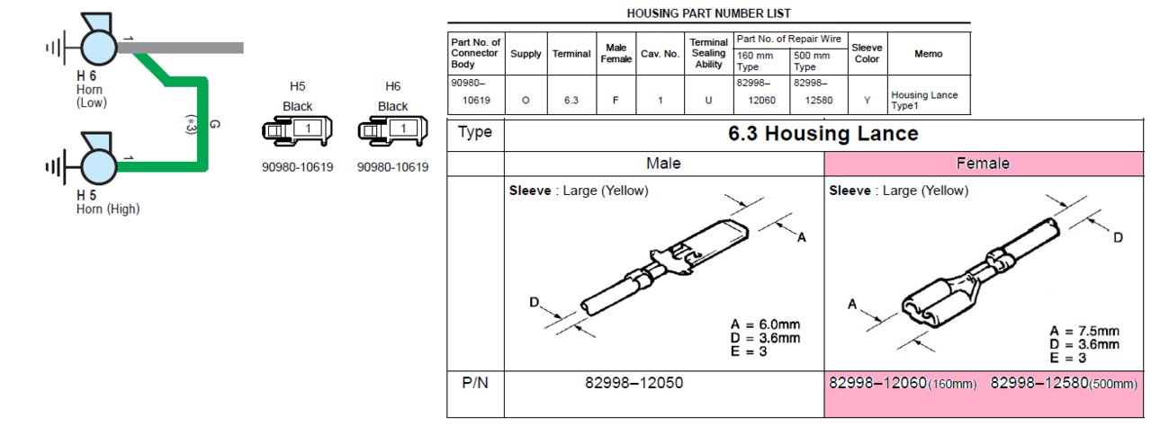

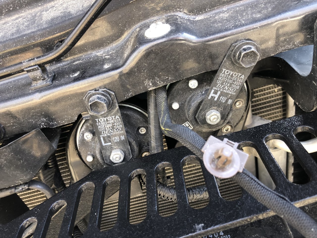

    I looked briefly at replacing the horns with lower profile Bosch sharptones or similar, I think you would not even need to invert horn mounts. But then my truck would sound like a Subaru.
    Flip/swap sides is the way to go.

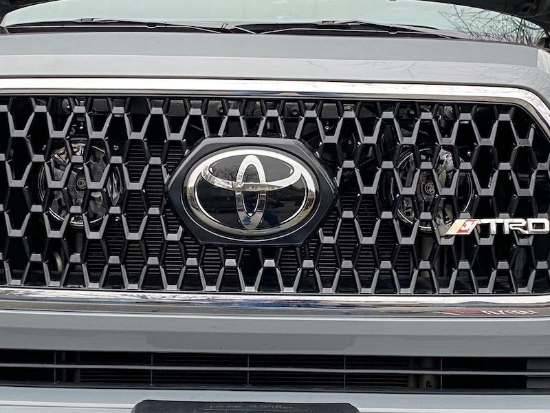

    Anyone know what size light bar will fit in this mount?
  6. Feb 3, 2021 at 7:12 PM
    #26
    Col4bin
    Col4bin [OP] Well-Known Member
    Apr 6, 2018
    #249606
    1,037
    Maine
    2018 TRD OR Double Cab
    As in you want to put an LED bar someplace behind there? You really have most of the behind the grill area to work with in terms on length.

    I put two LP9 Pros in amber and with some minor tweaks they fit without issue. I don’t recall the diameter of the LP9’s but they are monsters. If they fit you can pretty much fit anything.
