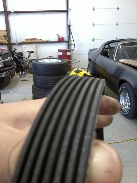

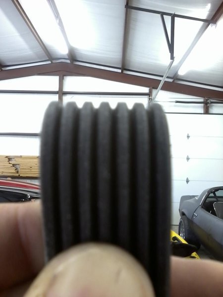

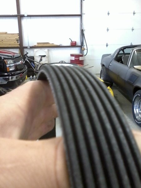

    Can you give us a pic of the old belts?

    ran this belt for a couple weeks. It made it like 2-3 days before it was making racket.. I then soaped it every day sometimes morning and afternoon to keep it quiet. Cant really tell much from the pics.. When you look at it really really really close.. it looks like it "might" have a very slight bit more wear on one side of the ribs than the other.. but I cant be sure.
