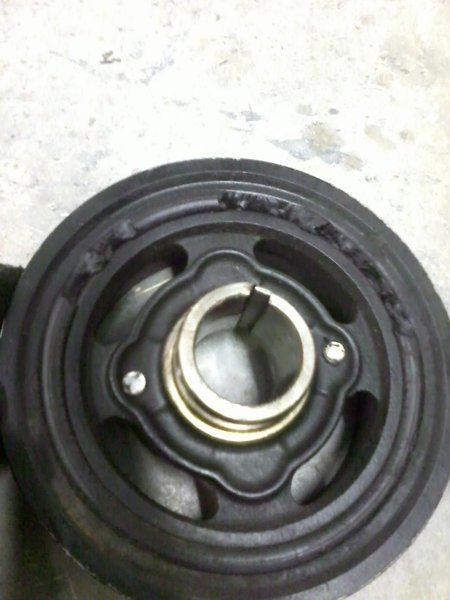

  20. Mar 18, 2017 at 11:21 AM
    #120
    Lthompson
    Lthompson [OP] Well-Known Member
    Mar 13, 2016
    #181136
    950
    old one had a wobble.. That's where I started with this whole thing. it had a pretty good wobble, took it off and this is what I found. Whole shaft was cracked, and chunks of rubber missing. It was at the dealer bout 7 months prior to this getting the front seal replaced... Then when I noticed the wobble, they wanted 550 to replace it, I said heck with that.. Then I found this... Pretty sure they messed it up somehow. But i replaced it with a dorman.. Which i currently am replacing again with an OEM. Making a better crank tool also.
