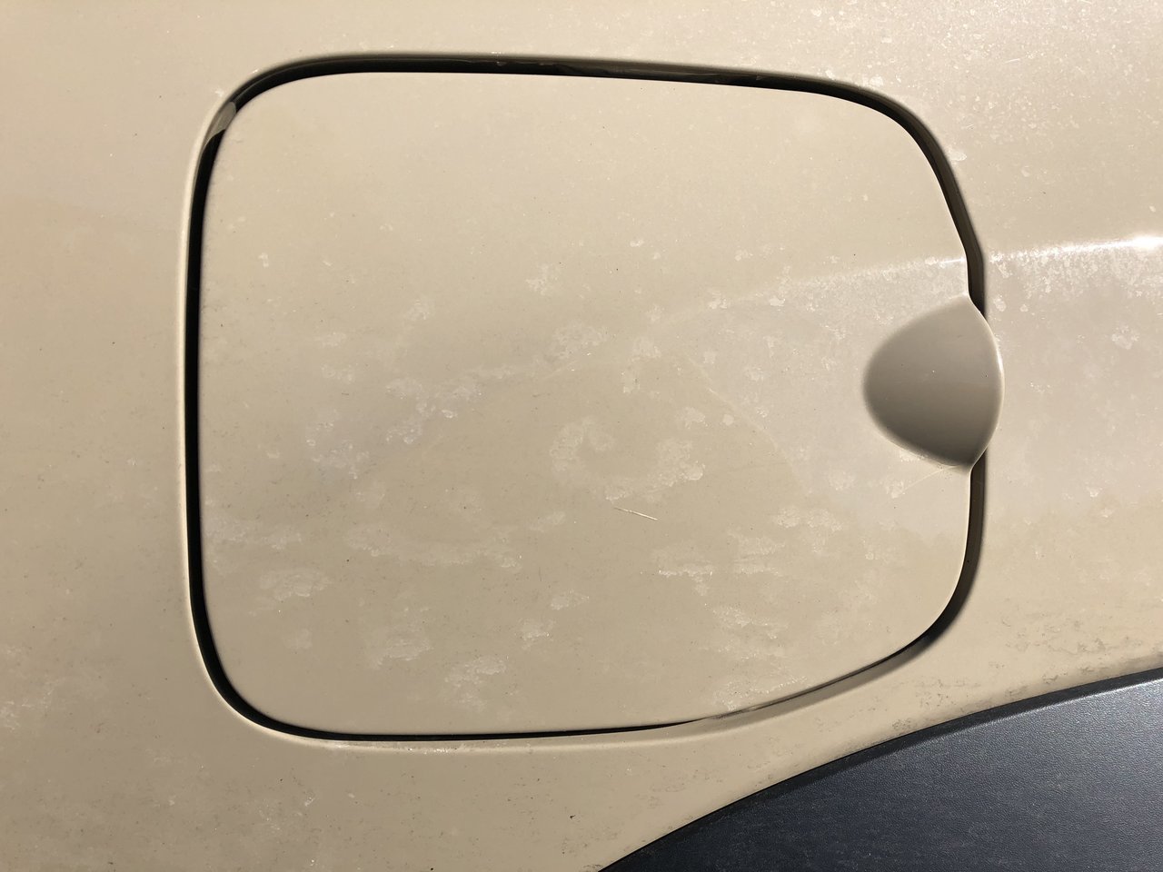

    Just noticed my fuel door wasn’t sitting flush. Any one else have this issue?

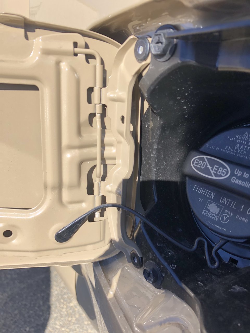

    Someone tried to steal your fuel, bet the inside bracket is bent.

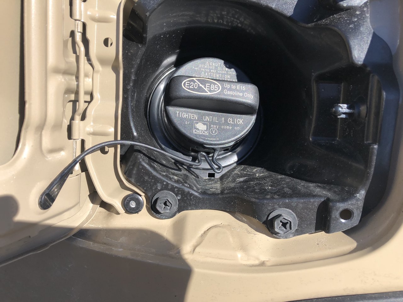

    Look inside and make sure the plastic fuel cap strap isn't pinched/turned around. I noticed the strap on mine was getting pinched in the door hinge and caused the bottom to push out.

    that doesn't make any sense. It's not like they would have to pry the door open. But I do agree that the inside bracket appears to be bent since the panel isn't.

    I can't imagine it was fuel being stolen. I keep a pretty good track of usage so something would seem off. The door doesn't lock either, so it wouldn't be a struggle to open it.
    The plastic strap wasn't pinched when I just checked, but it could have happened before. Seems to stick out a lot for just that though.

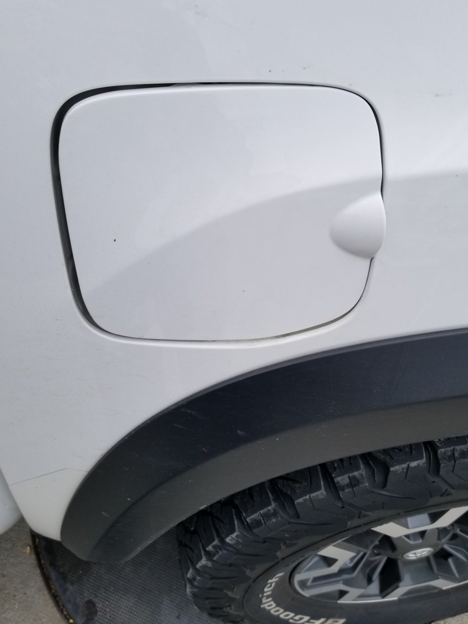

    i just bought mine about a month ago and my fuel door is also bent .it still closes shut but its not lining up with the bodylines

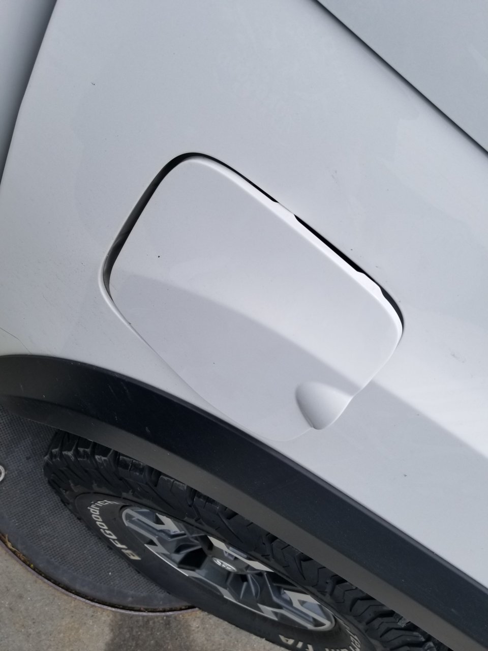

    Tried to gently bend it back a little bit. Sticks out about 1/16" still
