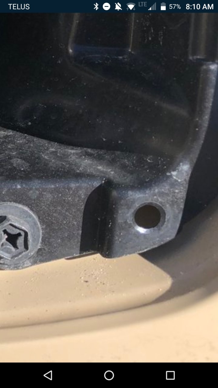

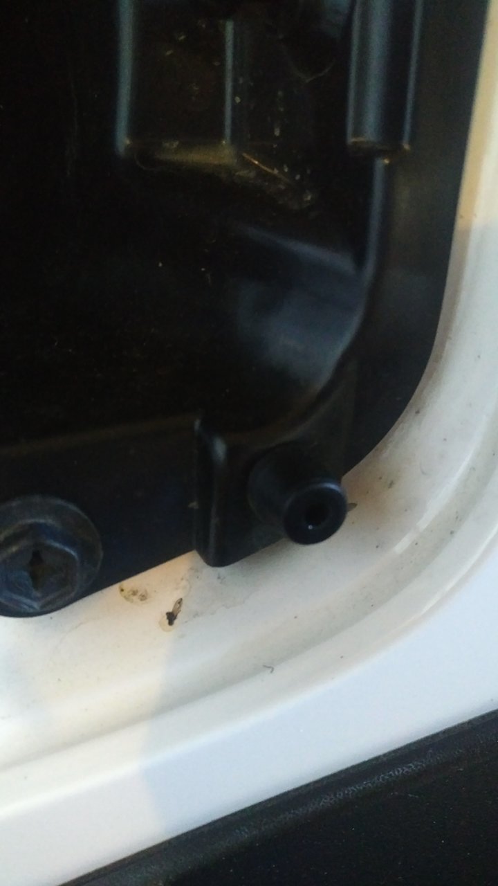

    Not that it'll make your door out of alignment, but in the second pic I see you're missing one of the little rubber grommet stoppersScreenshot_20180528-081030.jpg IMG_20180528_0814104.jpg

    Whoa. Just checked mine and it's missing as well. My stupid compulsiveness is now battling my laziness. Do I really want to try to find that part #?

    Holy cow mine are missing too, could this missing part cause us to push the door in to far ?

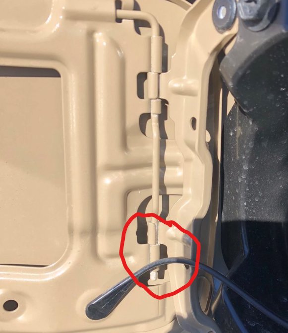

    These doors and hinges are very thin metal (on all vehicles). It's just like adjusting a door in your house that doesn't shut properly. Figure out which way it needs to move and tweak the hinges a little. I've done this on dozens of vehicles through the years.
    Pretty easy to see where yours needs adjusting. Make the bottom hinge look like the top one and start there.

    They pop out pretty easily, mine came out while I was washing the truck and
    They pop out pretty easy, mine came out just from running my wash mitt over that area while washing my truck. Luckily I noticed when I was wiping down and found them lying in my driveway!!
    The door goes in farther without them but probably not enough to bend the hinge.
    I'm sure toyota dealers would stock these, probably same piece on every vehicle

    Use a piece of wood and hammer and gently tap at the bottom of the door bracket a little at a time,until the door fits perfectly again,why go too the dealer and wait ALL day for something simple.And yes I fixed mine that way.

    I'm having the same issue with mine, took it to the dealer and they said they can't bend it out and would have to replace it for $240..
    Any tips on how to fix this myself? Essentially the top right corner is rubbing.

    You need to carefully try and bend the hinge back into its original shape. It is likely bent out from the bottom right corner and causing the rubbing issue on your paint. Try bending a little at a time trying to see what works best. I have done this on my old 1st gen and it worked pretty good. It is going to be tough to get it perfect. Touch up the area that was rubbing or it will start to rust.
    The gas doors on these trucks are a joke, terrible design that hasn't been addressed in over 20 years. (Subaru has this garbage design as well) I see numerous 1st and 2nd gens on the road with missing doors altogether. Make sure you keep your hinge lubed up real good especially if you are in the salt belt.

    @psmura thank you very much! I was able to bend it a little bit so the gas door no longer rubs, thank you for your input. Much appreciated :)

    This is an issue of a little lubrication goes a long way. These hinges need to be regularly lubricated or else they will easily bend. White Lithium Grease will last the longest.
