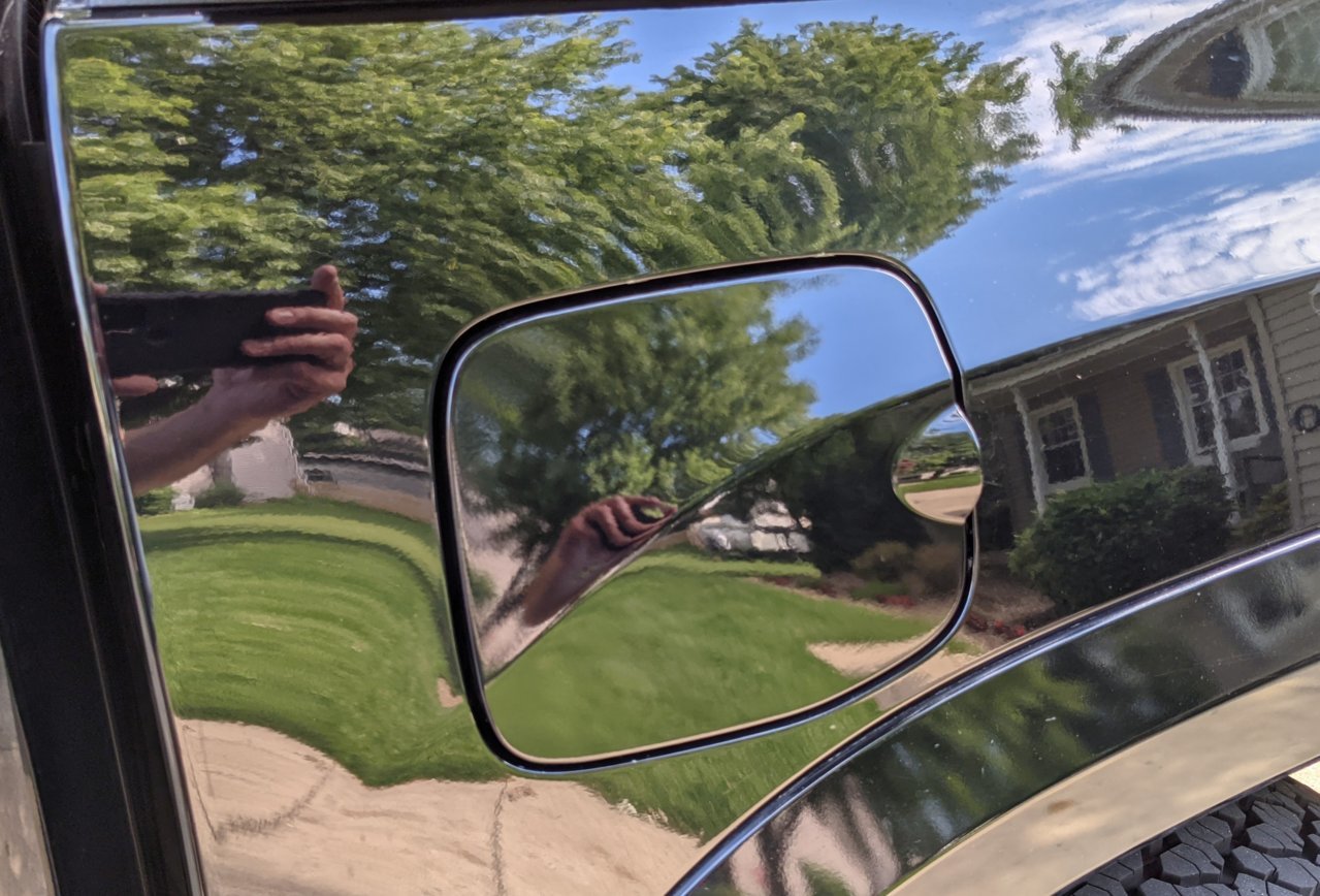

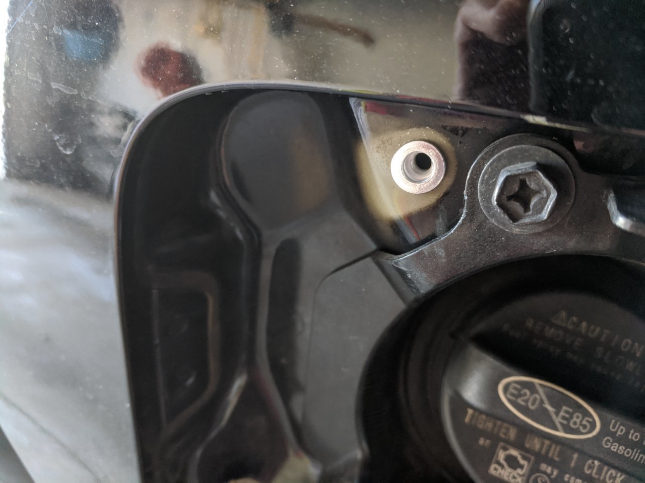

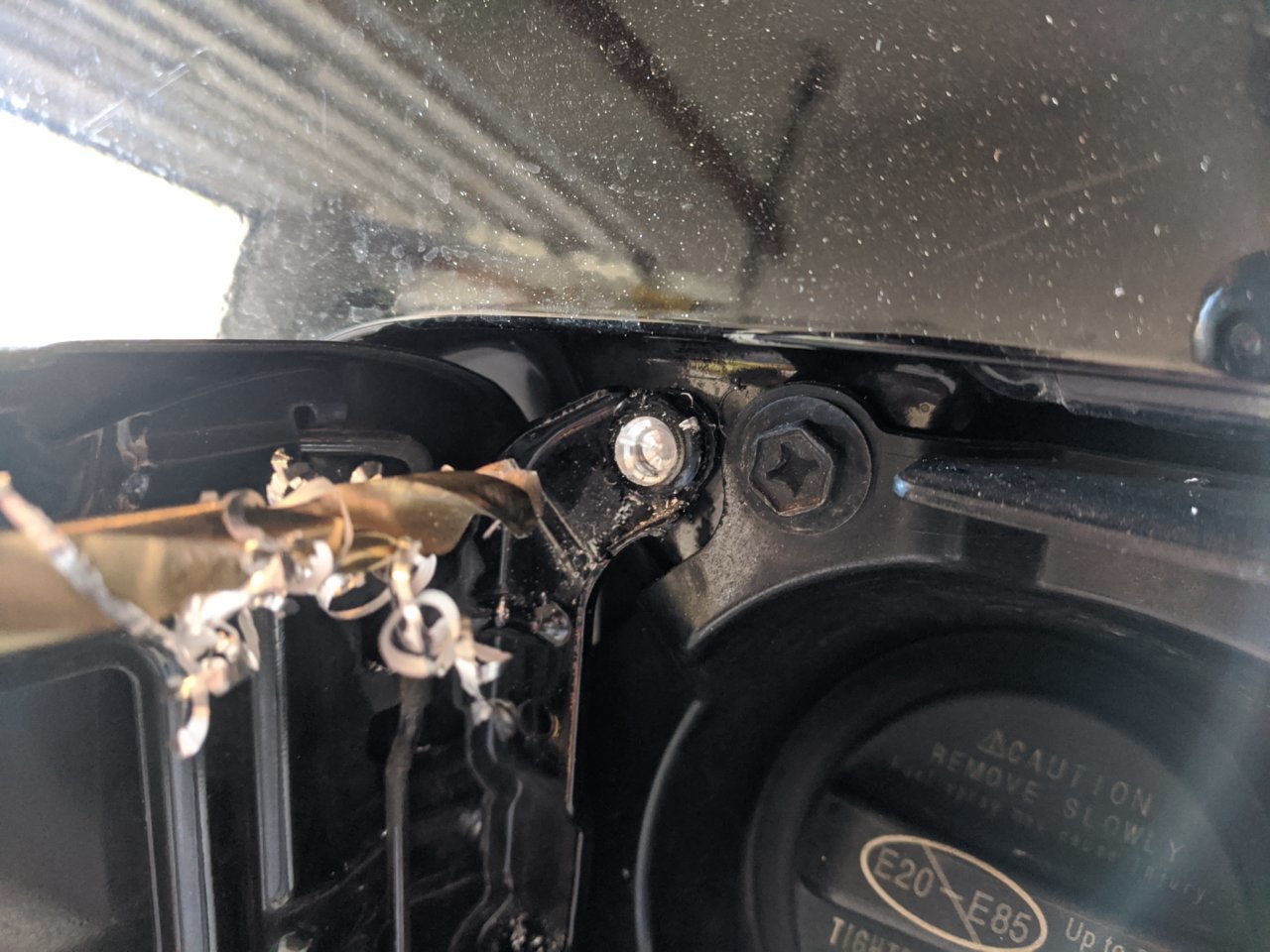

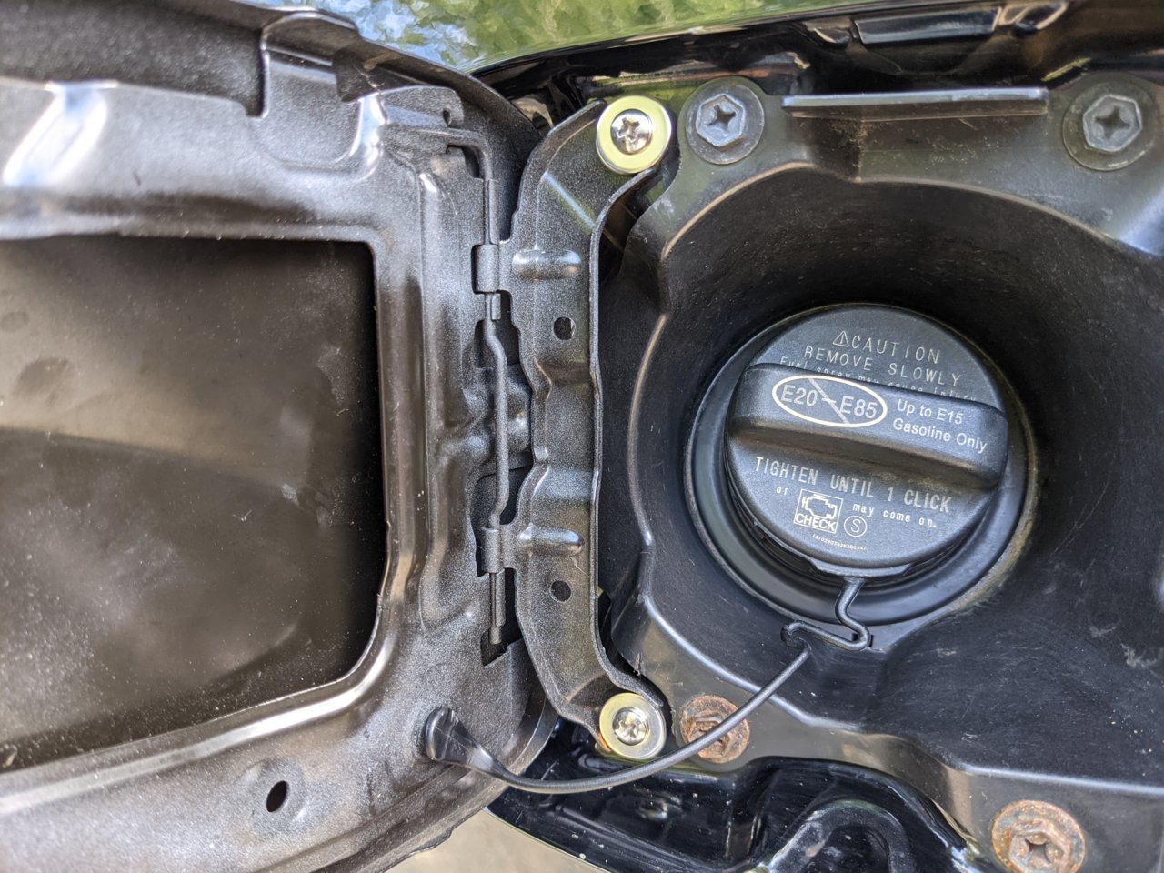

    Below is a link to the part - I got mine from a parts seller on ebay who doesn't have any more at the moment. But I paid $58 shipped.
    The install was easy - only tools needed were a drill and a rivnut gun. I got the cheap kit from Harbor Freight that worked just fine.
    If you've never done paint/finish work, this is the perfect piece to learn on, since it is small and no blending/feathering is required like on a fender or door. To smooth out the clear coat, I used 3000 & 5000 grit wet sanding pads, followed by Scratch X 2.0, and finally a polishing compound from Meguiar's.
