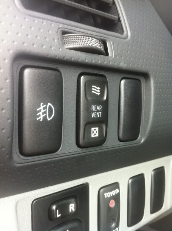

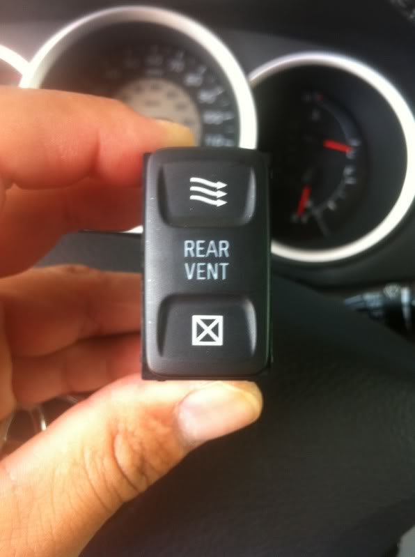

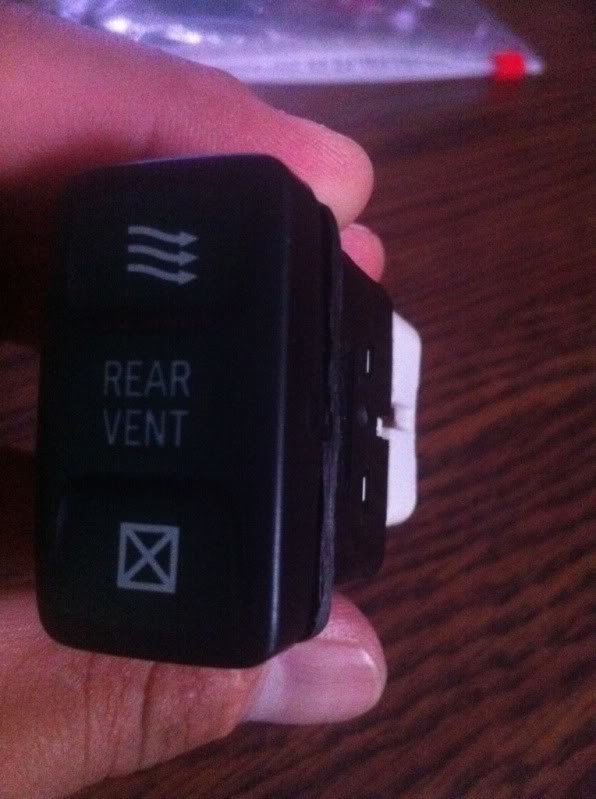

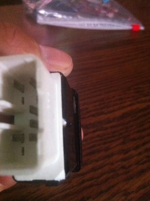

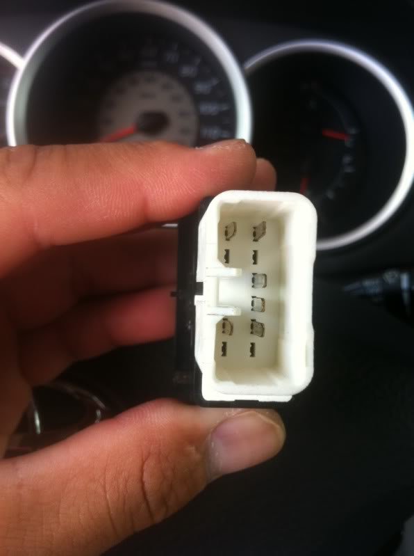

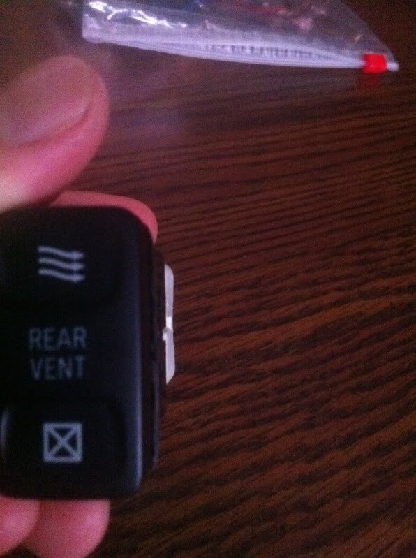

    For those that'll end up doing this mod themselves, highly recommend using a 2004-2010 Sienna rear vent switch. Just got done figuring out the wiring thanks to members JBCjr and Jerez. Installed and mounted in one of the blank slots.
    Here's the switch. Got mine at a local auto junkyard, a lot cheaper then eBay.
    AD6DAD61-DCD1-41E7-8B10-A37098FFED33-250_5caa6f3ecfadce5939420fd46b519a59ee31a301.jpg
    Here's the pin out and how it should be wired. Looking at the back of the switch as pictured below.
    #1______#5
    #2______#6
    ________#7
    ________#8
    #3______#9
    #4______#10
    Pins #1 and #5 is for illumination- ground and power
    Pins #3=12V Power. #9=Ground. Pins #8=Close. #7=Open
    *If Open and Close is backwards just switch wires.
    FA578B56-46BC-4BB7-87E4-5D1EFC1841F8-250_18c5623f082345817d66a0979a7046c1cd22c251.jpg

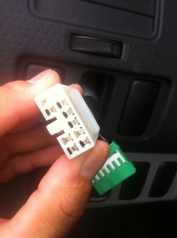

    I wasn't able to cut the plug from the wreck Sienna that plugs into the switch. So I bought one off of eBay, audio wire harness TWH951.
    7F452893-491F-4FDB-BCAA-FC547CDFB5B0-499_ac65f2500274bc93780ca32b8e8bc8cd0a4d858e.jpg

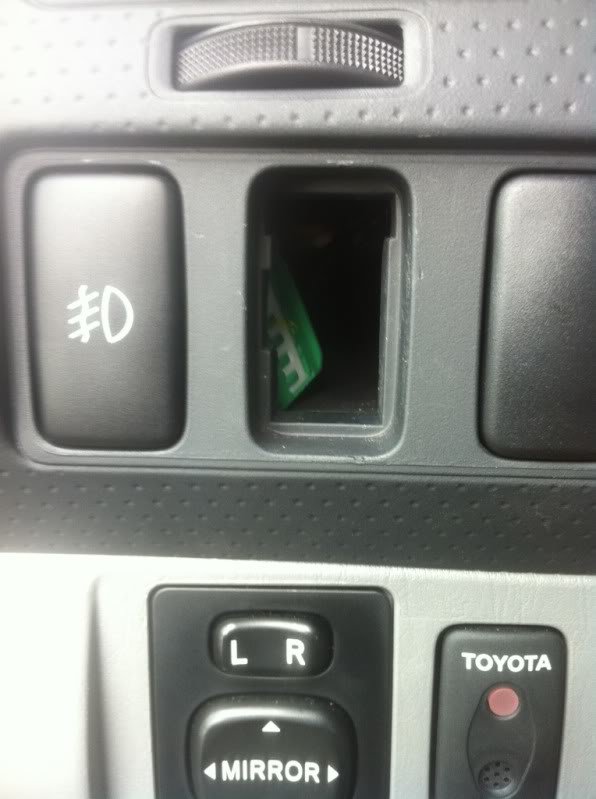

    For the switch to fit snugly and perfectly to one of the blank slots, I had to shave off all side of the switch. Dremel with a sanding drum is perfect for this part.
    Before.
    5d432f040aaab4c9c8e100508e4206c4_zpsebc3_714eaabe28474e02e868a5138c94f0627f486f2e.jpg
    After.
    7FFC70FF-EE9F-4E46-B3ED-D292D7F58583-850_af0ff7bb0cf0990508eceab2f6699c62088a03cb.jpg
    E4B11EF7-5E6C-4B5C-A23F-0A4FAB1DA6CF-850_e934563938896ce9c14e129e1477b380847a2479.jpg
    39815A5C-9CA1-4FF5-9628-C734CEA68364-850_e267aafa5429e69b62b5a17aaf1546f74c27fbb7.jpg
    Had to also shave down the inside of the blank slot. Taking off little by little and test fitting. Used an exacto knife for this. (Forgot to take a pic of after)
    67DEB8F3-7476-4B84-AB9C-4A573AA273AD-850_204d8f4e48e69524d0a3526bc479082da5dc4eb5.jpg

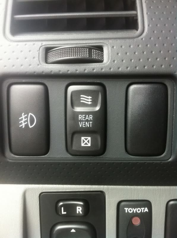

    Here it is installed. It takes a couple force to actually push it out from the back. So it's tight and flush.
    B003F9C7-2A25-4D55-B33B-546076A8CD58-499_ca055a4c8ef2bcbc66353c4277146680751d5566.jpg
    740A10A3-5B77-4FEB-8BEF-298BB9F1D825-499_861f70800501f658a2ee527affdfb857164b2449.jpg

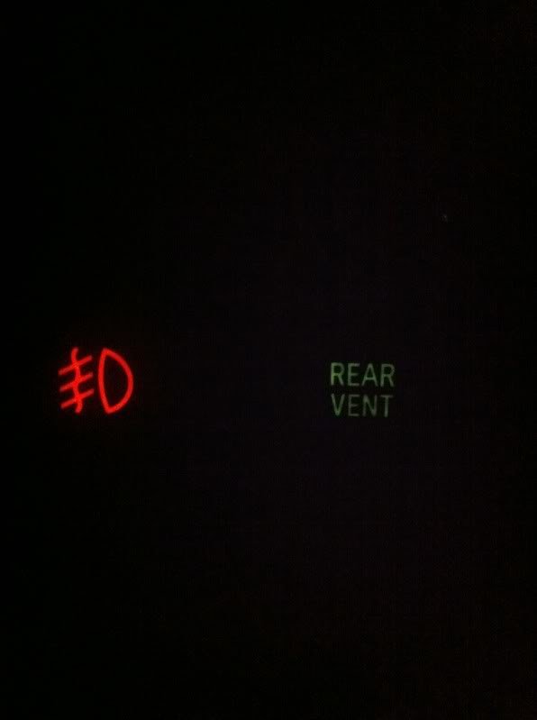

    Here it is illuminated, next to the fog light switch. Probably gonna switch the bulb out to amber.
    D9066410-7A0F-4BD6-832D-49ADAD5C99D4-864_bb0a053bca66b1b4f9fec9698ea0c259a8d9cc88.jpg
