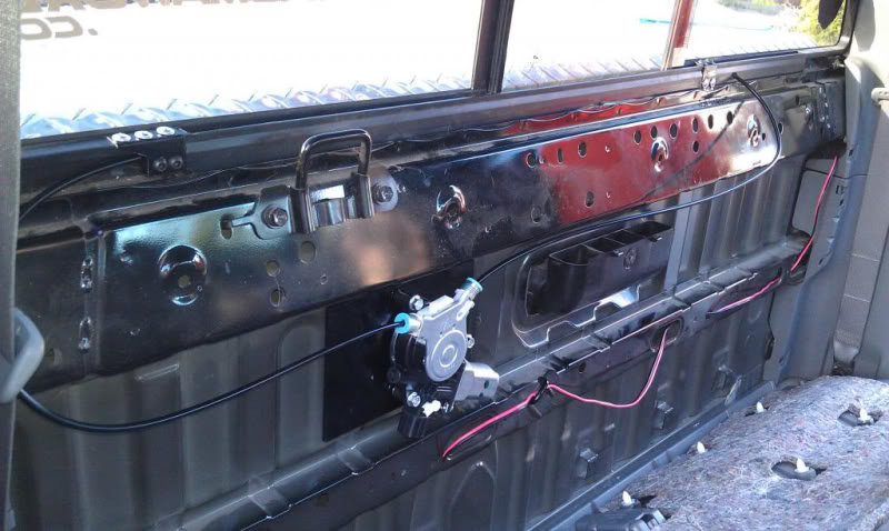

    I have gone through this thread completely and could not find a picture of a hidden install with the back panel removed (so you can see where the motor assembly is mounted, how the cable are run, etc.) and the motor mounted to the metal surface. Does anyone know if there is a pic like that available? I have almost all of the parts to do this mod, but still have a few questions. My main concern is not mounting the motor or running wiring, but how to physically attach the sliding bracket assembly to the window itself. Any help is greatly appreciated.

    Not sure if you've already seen this pic. It's for the Access Cab but I think it'll be the same for the DC, and you'll have an idea how he runs the cables. Looks like you'll have to drill holes into 2 spots.
    dafe73b340e7c2be5eb5f8eb35628364_zps9de0_87e8c0232975f13b6d21e4e0b82eb852122222e8.jpg

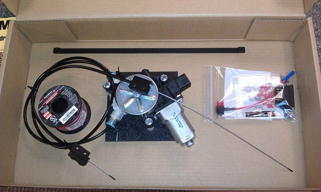

    As for a bracket that clamps into the rear back glass, this is a pic that I found of his new kit.
    See that black long piece up top, that's the bracket that clamps on the rear glass. It lays between the window and the trim that runs along the channel(not sure if that makes sense). I'm not sure what that piece is made out of.
