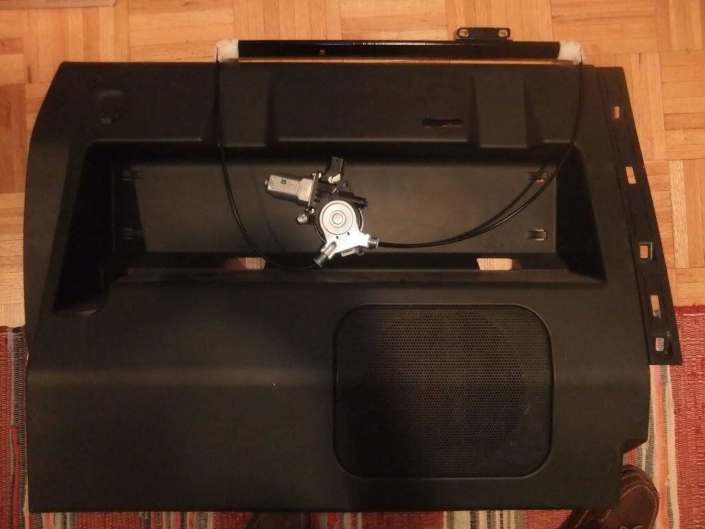

    If you wish to keep your rear storage cubby, you can mount the motor directly to the cubby itself. Here is a mock-up pic to get an idea of what it would look like:

    is that the rear cubby in an access cab or an aftermarket sub/speaker? i know my 2010 DC doesnt have a speaker right there. anything that keeps me from cutting up the bin would make me more interested in this thing though. would love to use that window more.

    That's the rear cubby in a DC with factory JBL subwoofer. What does it look like back there in your DC? Would you mind posting a pic?

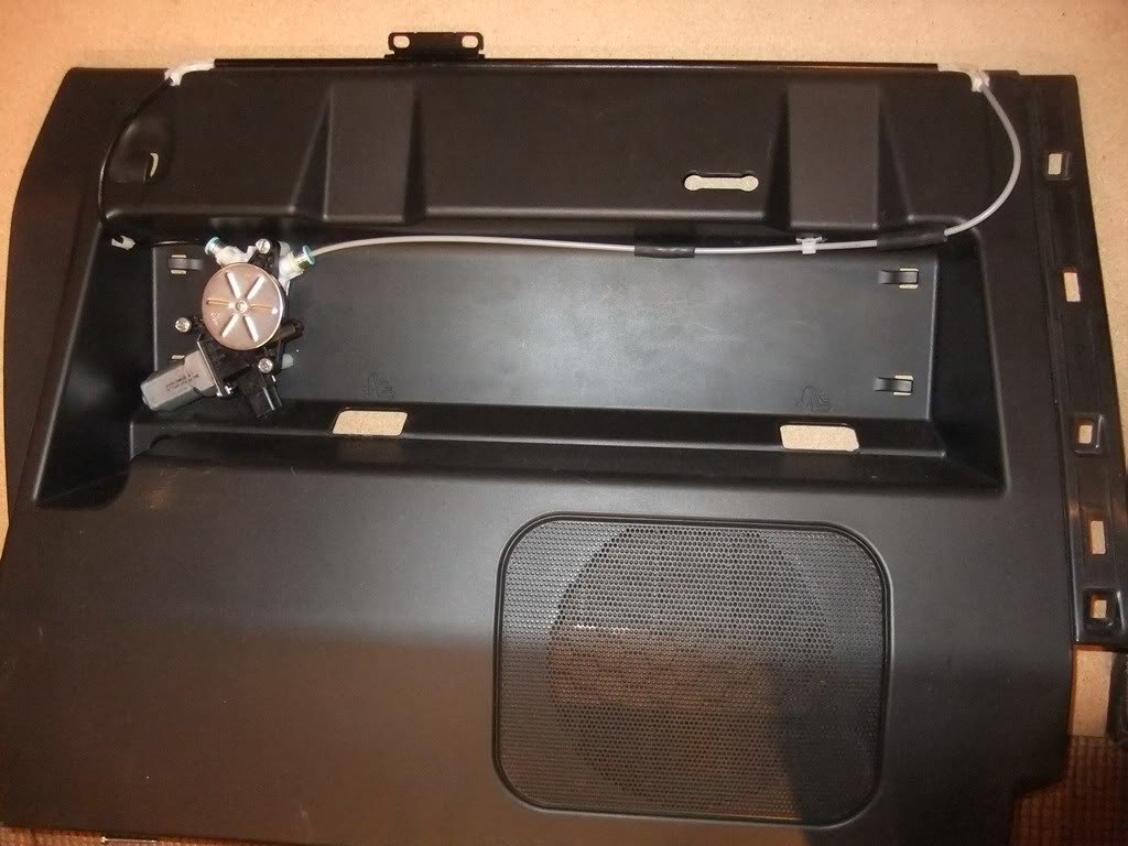

    I am, although the design of the kit has changed considerably since this thread was posted. Check out my other thread in the buy/sell forum with updated pics:
    http://www.tacomaworld.com/forum/2n...er-sliding-rear-window-quick-install-kit.html
    The kit does require some trimming of the top of the bin, but it's easier and quicker than it probably sounds. The kit includes templates and instructions about how to do the trimming with a hand crosscut saw, a utility knife, and a straigtedge. It took me about 15 minutes to do the trimming. :)

    Awesome, that's perfect. Thanks! No need for daylight pics -- that bin is pretty much identical to the other bin with the subwoofer cover, minus the subwoofer cover itself. Since the upper portion of the cubby is the same in both versions, the window kit mounts in exactly the same way in both.

    The hacking involved is pretty minimal. It's pretty much a 3/4" wide strip that needs to be trimmed off the top edge of the plastic, with a couple of small notches at each end, and that's it. The templates help keep the trimmed material to a minimum. The cables tuck out of the way pretty nicely and are secured to the bin with snap guides.
    I do appreciate that many people don't want to do any cutting/trimming/hacking of anything in their trucks to keep them as pristinely stock as possible. But in my opinion a little trimming job is a small price to pay for being able to have a rear window that you can actually use whenever you want to. That's JMO.:)
