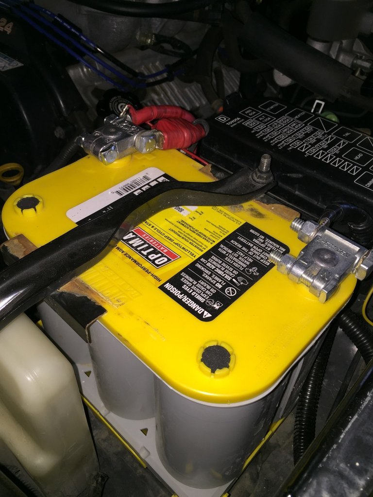

    [*][COLOR=#ff0000]Dual Optima Yellow top / Blues ML-ACR[/COLOR] (Have One)

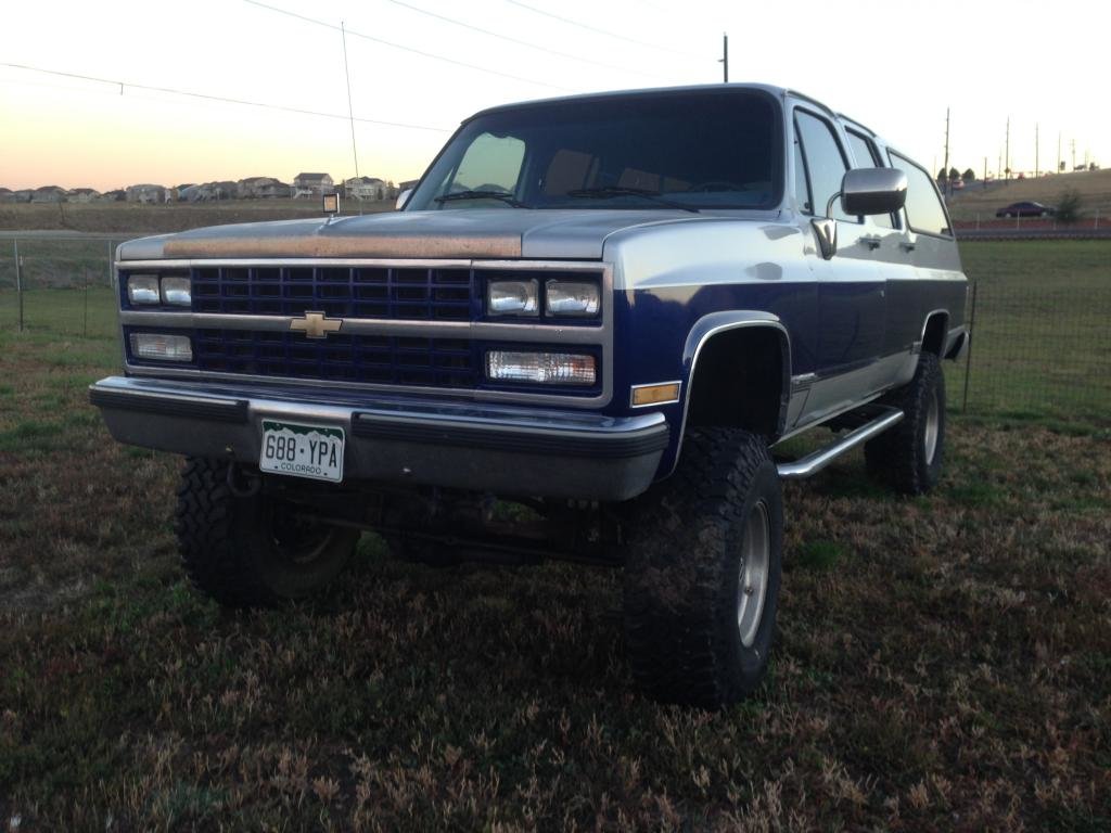

    Some Guys have been asking to see my old Suburban so here you go.
    1988 Chevy Suburban 2500 Silverado 350HO T400 NP205 35" BFG M/T 8" Lift

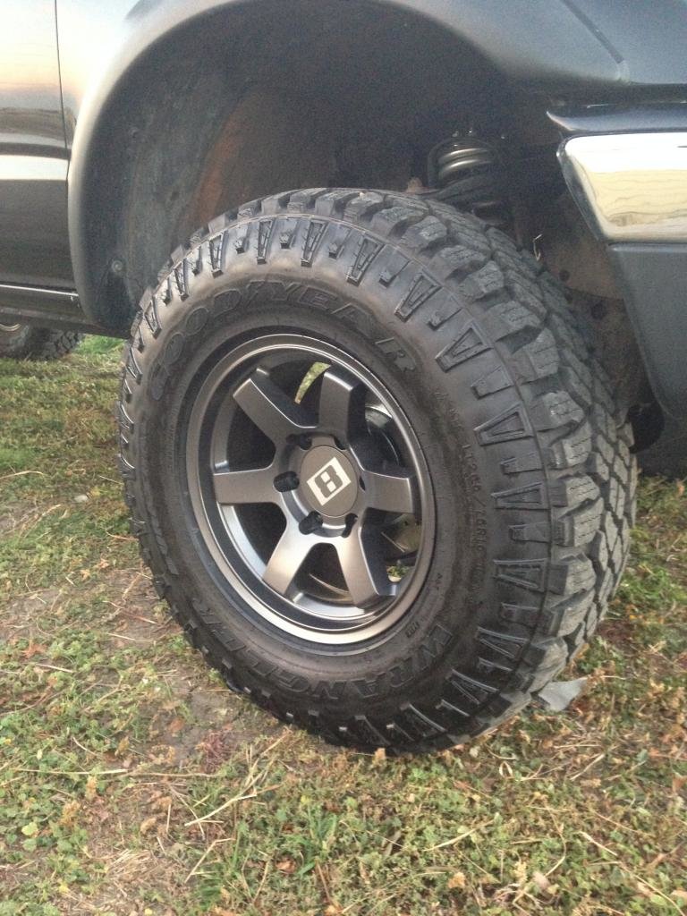

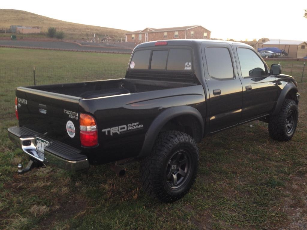

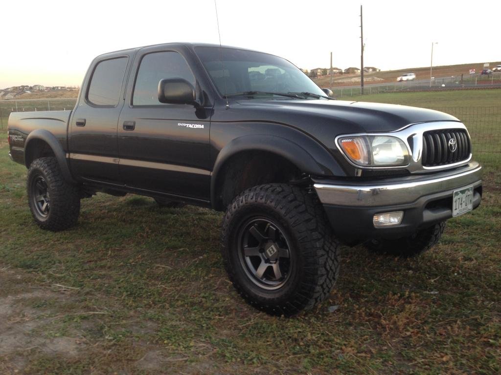

    Finally got the lift installed. The guys at ToyTec were awesome they even put my shocks together for me. That made the install much easier. I also got the steering rack bushing set it. The truck drive so well I cant believe it. Only took about five hours to install and that was with hand tools only. Now I cant decide what to do next. Probably the topper but the bumper and winch are biting at me. Sorry for the bad pics I will update them when I get back from the F1 race in Austin this weekend.
    Here's a shot of the wheels and tires for you guys that were asking about them.

    Love the rims... Im going back and forth between these and the scs f5... What offset are you running with these?

    -10. Just got back from the long trip towing a camper to Austin for the F1 race and the truck ran amazing.

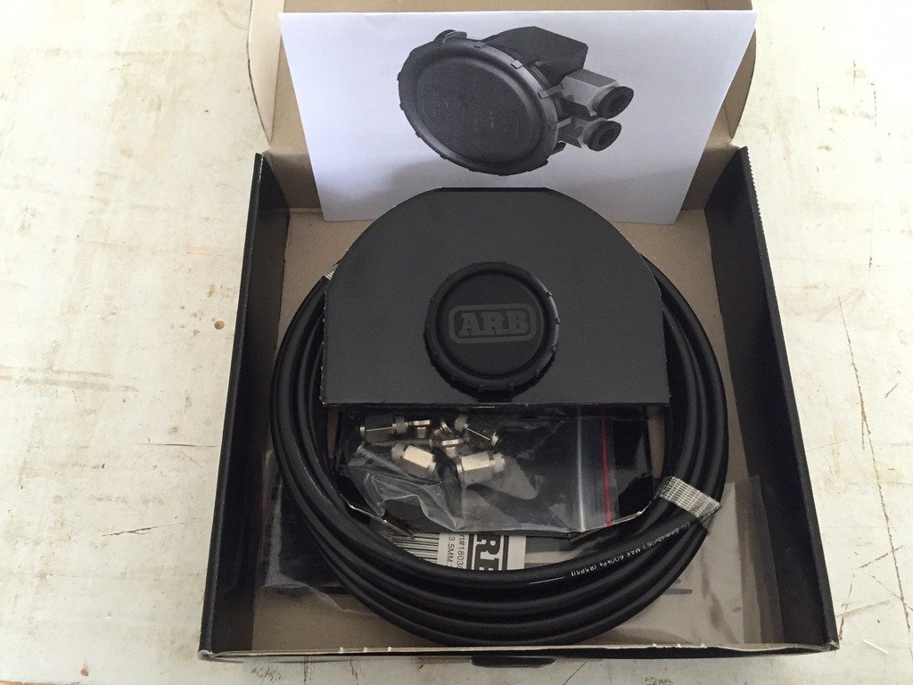

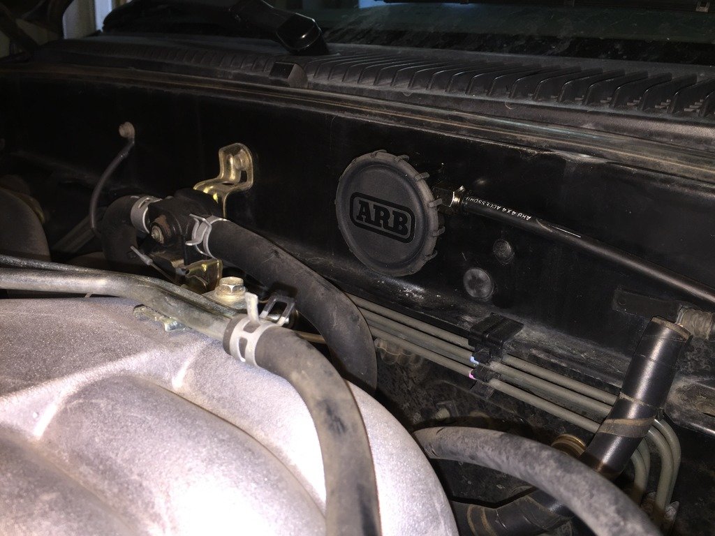

    I installed a ARB diff breather kit yesterday. I am very impressed with this kit and eases of install. I will have to buy a adapter for the front diff and trans today. I will just tap into the end if their breather lines by the battery.

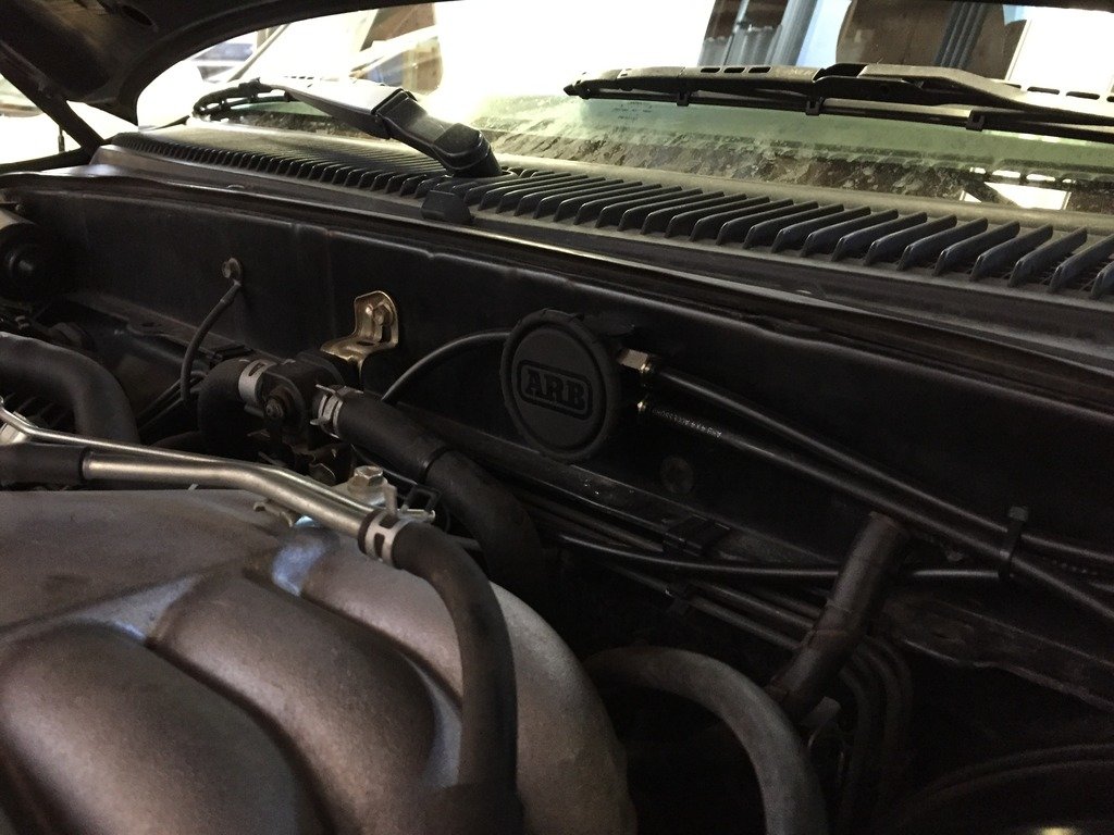

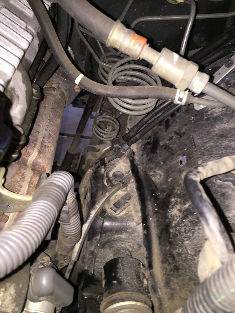

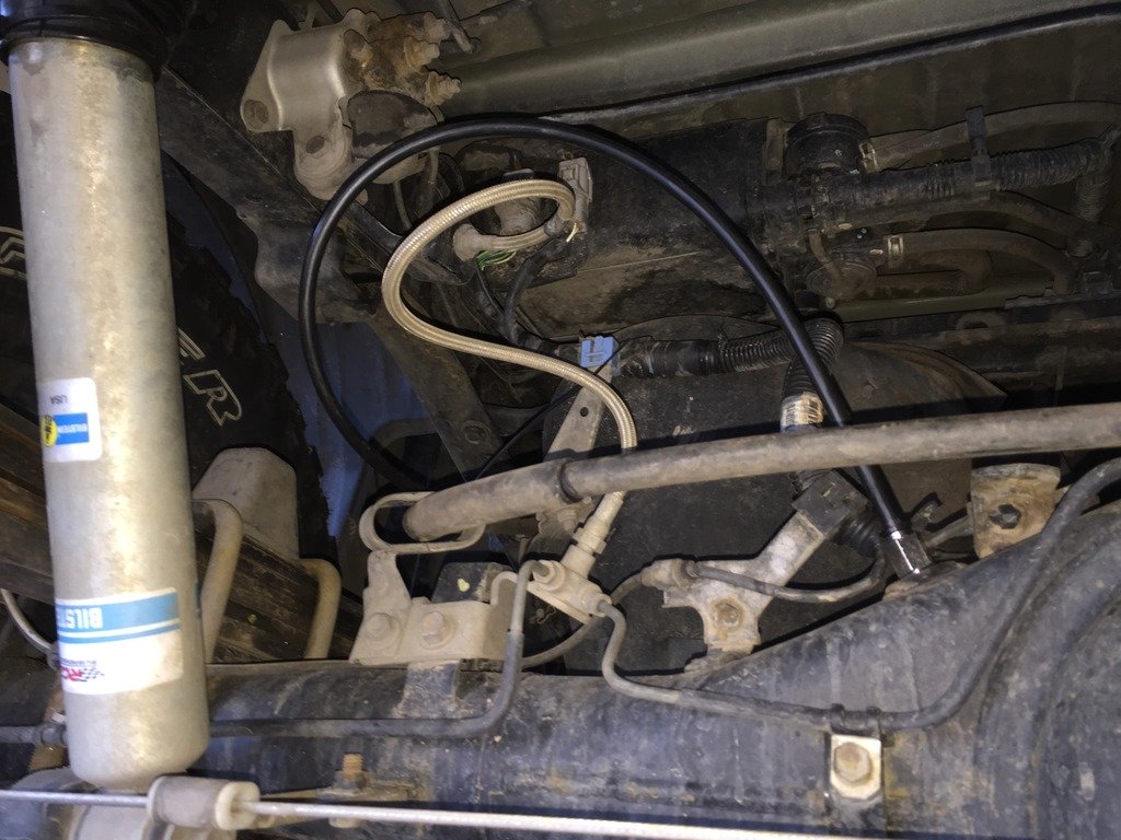

    OK I got the front diff and transmission breathers installed. It was pretty easy since i just tapped into the end of the lines by the engine and frame rails. Remember if you are installing breather don't reuse the stock valves. They only let air out, when the diff cools they lock tight. This causes water to be sucked into the seals. I have seen a many people on the forum relocating higher but using the stock valve. You want the diff to breath free both ways were it cant get wet. Now I only have the transfer case to do. It will be the hardest to get to I am going to see if I can get to it through the transmission accesses on the floorboard.
    IMG_0481_8fb326319b04187640bb3527d44f3d3175cacb70.jpg IMG_0479_d75da223efe501ed4f850de8d1f9f3a26cb3fa1d.jpg

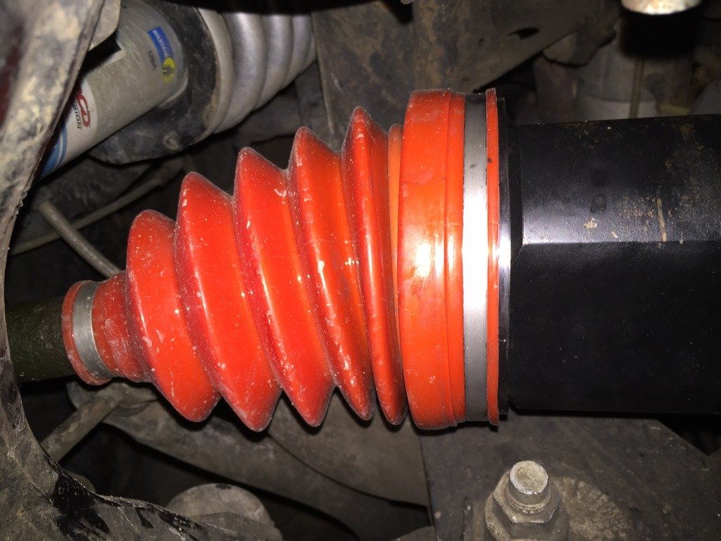

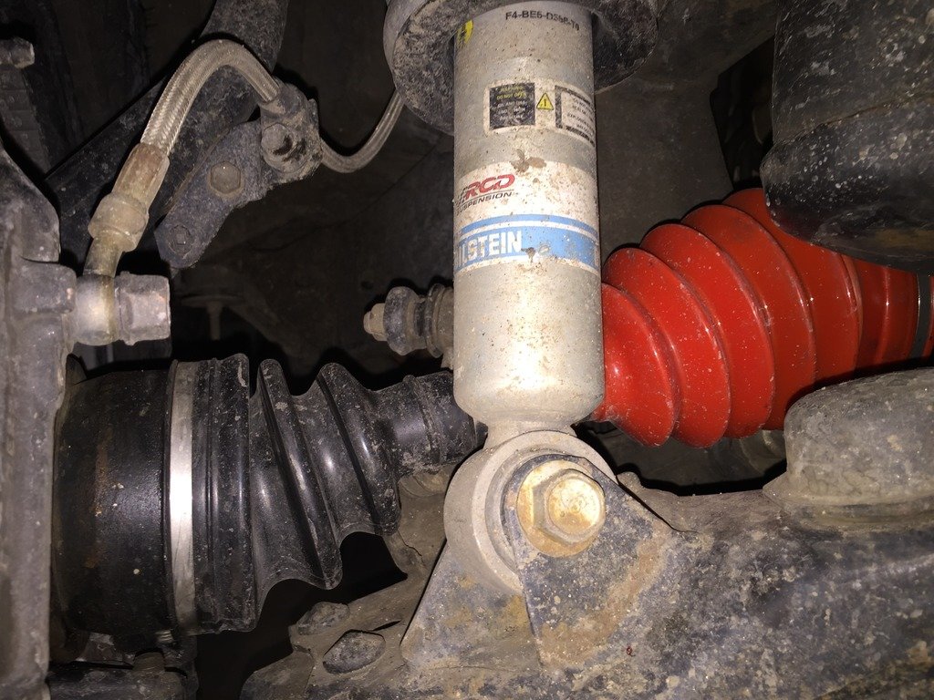

    I called CVJ axles and told them about my problem with one of my axles. One red boot started to get a small rip in the inner rib and the and the other side had a two ribs touching. I told them that I just bought them last year in February. Nancy told me to bring them back and she would reboot them for the cost of the boot only. When I went to pick them up an hour later she showed me a new orange o-ring that they are now using on there off-road boots. She said this keeps the red boots from touching even at high angles. I can't say enough about there customer service and Nancy is so helpful.
    IMG_0472_bc461404a098b694c16863432be8252cd9cd9c8e.jpg IMG_0473_3b4595c2dfd48fbd5ab44338a0e594658ecb7aaa.jpg
