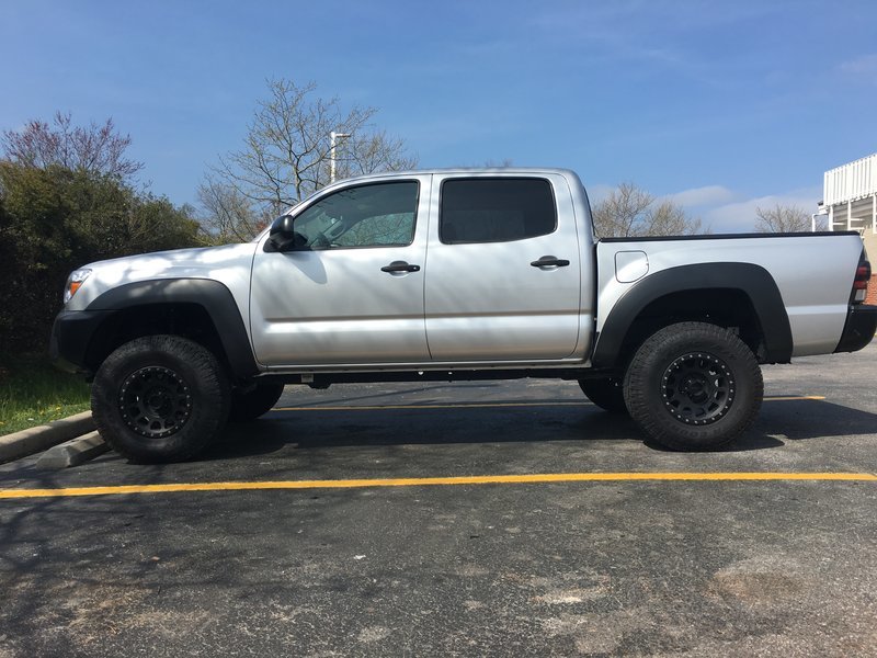

    885's for 2.5" of lift and you can get away with not buying UCA, 887's for a full 3" but you will likely need new UCA to get a good alignment.
    @Bluegrass Taco and I have the same setup - Bilstein 5100 front/rear, OME 885 coils and dealer 2" AAL. You will not be disappointed.
    Check out a thread I started after install https://www.tacomaworld.com/threads/finally-lifted-with-5100-885-aal.424280/IMG_4033.jpg
