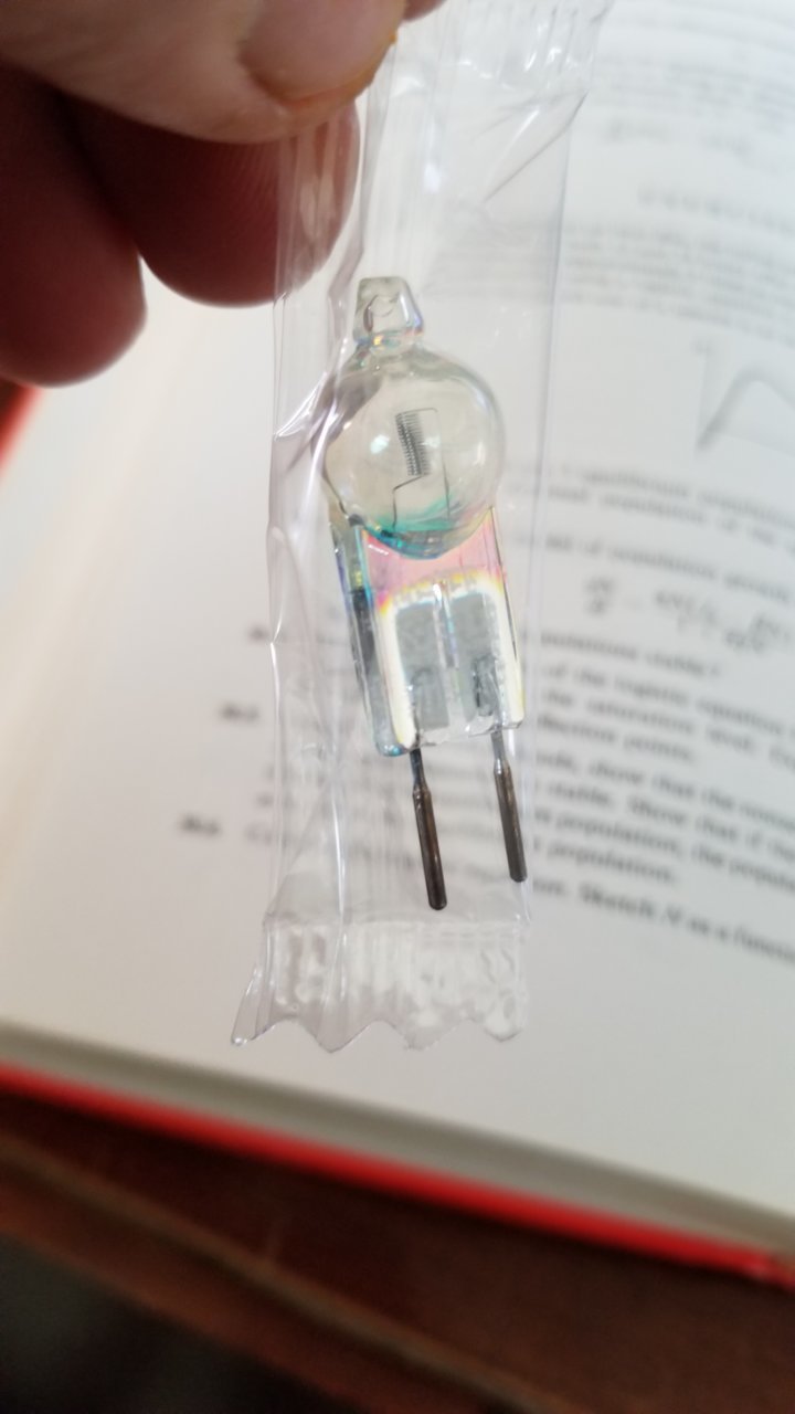

    I switched to the Osram 35w HIR bulbs. They are relatively inexpensive, and a massive amount of light. No problems as yet with any discoloration in the lens and they have been in about 6 months. Check the link posted above for info.

    I just did this same upgrade this past weekend with pics in that post. Night and day difference. I would suggest those as well

    +1 for the Osrams but buy an extra bulb or two - you have to bend the contacts to get them to fit into the sockets and the glass is extremely easy to break. Two pairs of pliers works best - a small needle nose to hold the base of the bend and a larger pair of regular pliers to do the bending.
    Night and day difference on the backup camera.

    Good call, I bought three one to learn and screw up and two to install. Sadly, I did need three.

    LOL i bought 3 as well. Did pretty good with them so i have a spare in case anything happens to one of them. Thought about ordering 2 more just to have but i dont forsee any future problems
