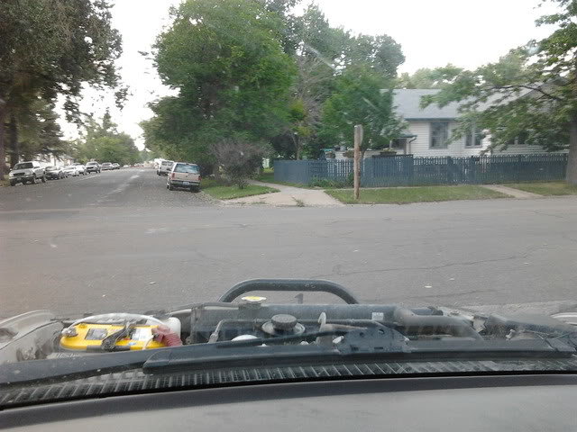

    Full custom stereo, onboard air compressor, train horns, spacer lift, 30" tires, optima yellow top, rear slider window & tailgate anti-theft mod, pop & lock, class 3 tow hitch, lights in bed, Ultra Gauge, Weather Tech mats, yellow fog lights, camper top, air lift rear airbags, rear diff breather mod, soon to be more...
    The best investment I made for my truck so far.
