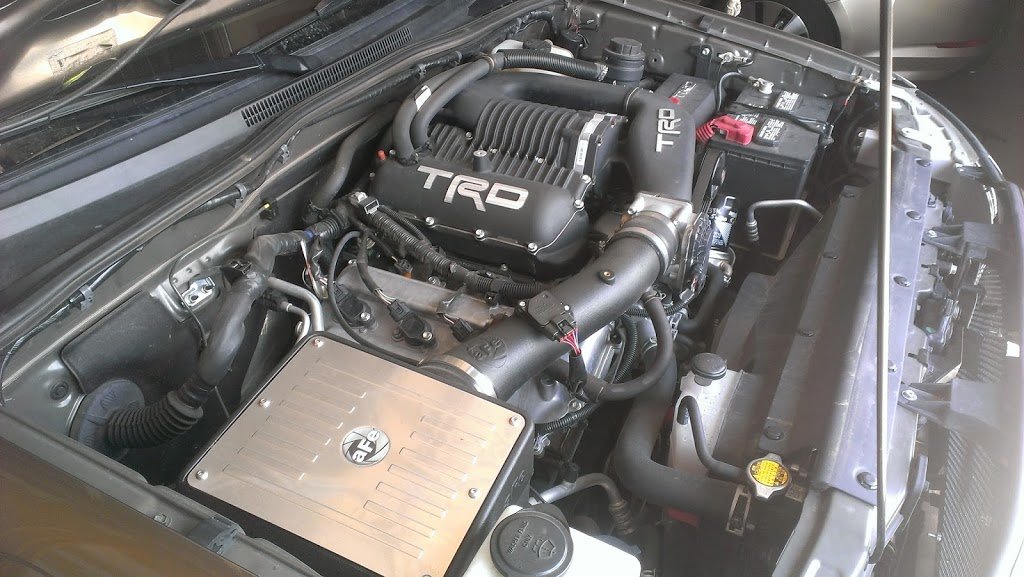

    the pro dry -S is a synthetic media filter that uses NO OIL, but is still washable.
    the Pro5R requires the filter to be oiled like a k&n....... for my own reasons, I run the pro dry S, because oiled filters may get oil on the MAF sensor and cause issues, as well as MAYBE attract more crap to build up on the throttle body.
    Either way, keep an eye on ur MAF sensor and throttle body plate and clean as needed

    Justus fucks not given
    Jan 4, 2013
    #94417
    9,230
    Nabisco the kid
    In ur toolbox
    not so low, not so slow 2006 6 lug
    stockish
