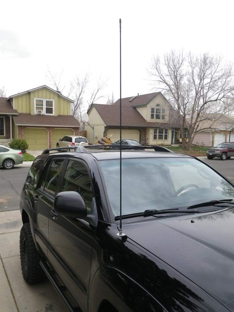

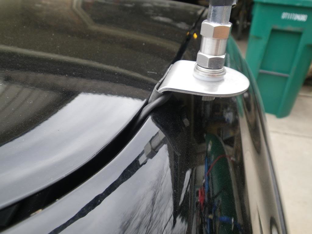

    Got one, need to add the videos though! (edit: Done!)
    http://www.tacomaworld.com/forum/4runners/238998-wishbone-runners-build.html
    Edit: Here is my setup, would work for a Taco as well.
